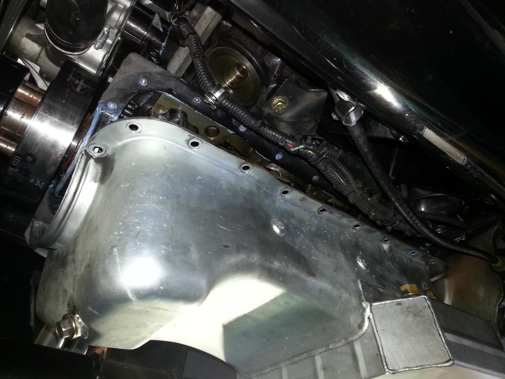

the bad news is that no matter how i turn this pan, i can't get it off. seems to be hung up on the oil pickup. i've done this before, and it was a little fiddly, but not to the point where it could not be removed or put back on.
if i can't remove it, i surely can't get it back on, at least not without screwing up the RTV, and a small leak is what prompted me to finally get to this in the first place.

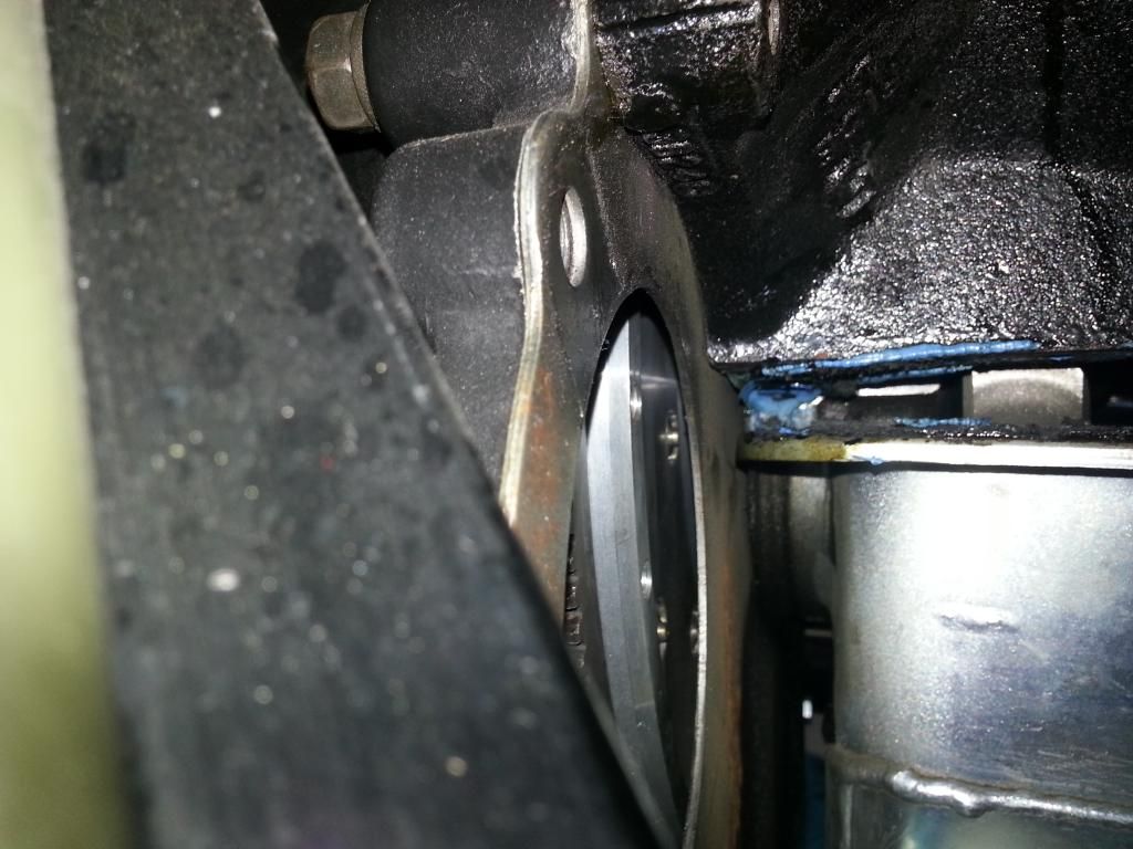

in the rear, it seems to be interfering with a bump in the block plate below the curved part of the oil pan, also a bump at the bottom of the block plate.
i haven't the slightest clue what you guys are going to tell me. the only thing i can think of is to turn the engine by the crank a few degrees, and maybe something won't interfere with the crank scraper.
i am guessing that the passenger rear of the pan has to be pushed outward to get the oil pickup into the larger hole, but i can't get it to move enough.

i was able to get the pan down a little more, and fortunately, stick my thin camera phone up in there. i took 50 pictures, and i got a clear shot of the tube area. seems the piston ends and counterbalances are not nearly as low as i thought, so that's not it.
i with the pan hanging down, I can turn the engine by hand 360Âş without anything hitting the crank scraper. but i am not sure if i am trying to push/twist it the pan the right way.
trevor: any chance can you locate exactly where the interference was? i vaguely remember it was the back part of the curved pickup tube that was hitting. there is a little black mark in my photo on the top edge of the sheet metal, but it may not be a clue.

the bump in the block plate is not letting me twist the pan in the direction i think it needs to go in order to get it off.
i must be doing something wrong, i can't imagine this should be so hard, especially since i did it with my old engine twice.

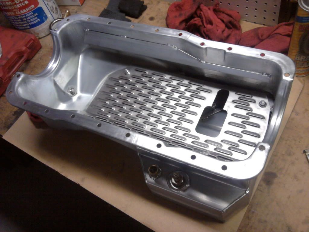

Look at your first photo and try to visualize the type of motion it would take to unwind the pickup from the windage tray. I know it seems like the clutch backing plate is in the way but it's not. You just have to find the right spot and it will drop right down. All these trap door pans are tricky to wrestle with but some are really bad.
When you finally get it off, practice putting it up dry until you have the motion memorized and can do it one swoop. Then put the silicone on it and go for it.

Yes, but generally the pickup tube has a tab that is secured to a stud integral with a cap bolt bolt---note the tab on the tube in this photo:
If you decide to go this route Eddie before you get too carried away make sure you can see it and get access to remove the nut securing the pickup support.

i JUST came up with that same idea when watching TV... the bolts (screws in this case) are clearly visible in my photo up top. that greyish thing must be the shaft that goes up, and that will drop down as well. i remember the shaft on my last motor was hex-shaped, i can see the bottom of this one is hex shaped.
after that, i will do what dale suggested and remove a bit of material from the louvered plate so it goes back on easier. of course, i will practice as Frank suggested first.

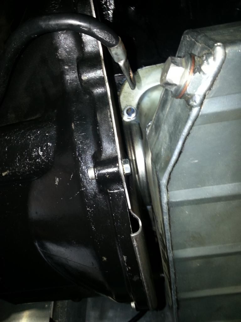

  • i can't push the entire pan towards the passenger side, because the front of the pump hits the main girdle, also the front driver corner hits the pump housing.
  • i can't 'twist' it a bit because the rear of the pan is flush against the block plate. also remember, there is a "U" within a "U" and there is only so much the rear of the pan can be moved sideways.
  • i am convinced that the only way this pan went on is when the engine was on a stand, and it was dropped into place with a slight twist. i've fiddled with this for more hours than i can count.

next weekend i will try turning the bellhousing bolts as Mark D suggested, but i think i'll also have to remove/loosen the trans support so it wiggles around.
worse news, now that i can see the area in the back of the pan, it looks like there was no leak from the oil pan, and it is indeed the rear main seal. :(
