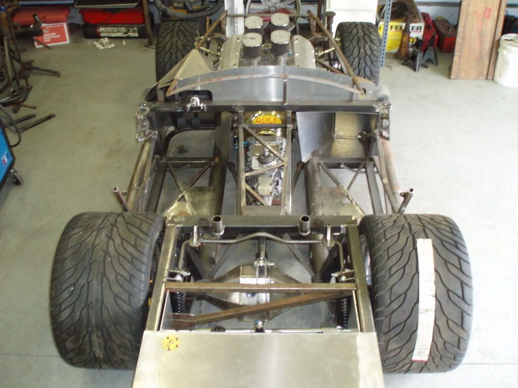

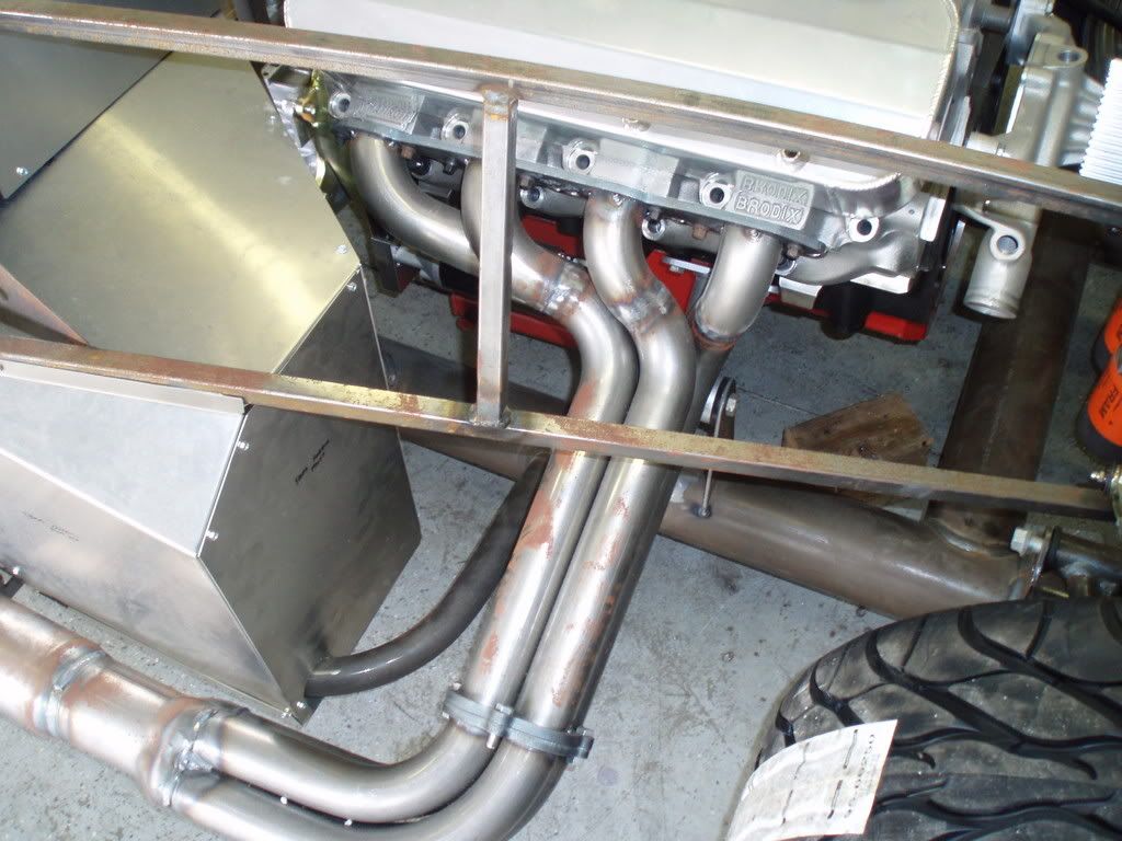

Some quick pics of my chevy powered build. Dont know if you guys will like the big rim tire combo. But I think bigger is better(sometimes).
Motor is a 540C.U. big blockchevy,TKO 600trans, fab9 rear end,20x10 and 20x15 Bonspeed custom billet rims carved to look like Halibrands. Brakes are 07 corvette ZO6 14.1 front 13.5 rear with 6 and 4 piston calipers, .75rear and .875 front sway bars. SAI mod i did myself using pin drive holes on the frame to pull the spindles in and large backspacing on the wheels to help improve scrub radius. Rear suspension is a combo of FFparts and my fabrication to allow the 18in. wide tires to fit. The fuil cell is a 17.5 gallon unit I fabbed with a mount built in for the fuil pump, filter and regulator. Radiator is a 2 core 1.25 in. tube aluminum unit I modified to fit. Once I get the body on ill get more pics to see if you guys(and myself) will like the look of the big wheels.CHEERS Earl!!

Please tell me that is a buffered fuel bladder hanging out in the back like that. I would hate to see a fuel fire from a mild rear end accident. I noticed that most of the frame protection is gone.
Otherwise, I think thats gonna be one mean looking and sounding snake that can back up the hiss with a bite!
