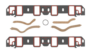

Since people might be interested. I had a hard time finding what I needed locally for my purpose.
I originally bought my breathers from Billet Specialties. (which is actually only less that an hour away, stupid covid is making them not let me go pick it up)
They sell a breather with a replaceable PCV inside a matching breather.
So that with some hard plastic 90 quick connecter to get in the tight space behind the distributor and Front carb. A Tee and some 3/8 fuel line a couple hose clamps. I will be able to install it pretty easy.
See what happens. The guy at Jegs was insistant this was a horrible idea. Lol worth checking and I can always put it back.
Monday I am suppose to take the the build back to the mechanic to replace the intake gaskets.
I was going to try to offer him a couple options. That will be uneasy since he seems stuck on the gaskets he uses which claims is the Fel pro 1250 not sure steel core or not
I have in hand the steel core version and a Mr. Gasket
To offer.
I also will have today ARP intake manifold Studs hardware to replace the Edelbrock intake bolts that came with the intake kit.
Jason
#19 ·
Sounds good Jason. Make sure the mechanic does a thorough check for an interference issue before installing the new gaskets.
Norm
