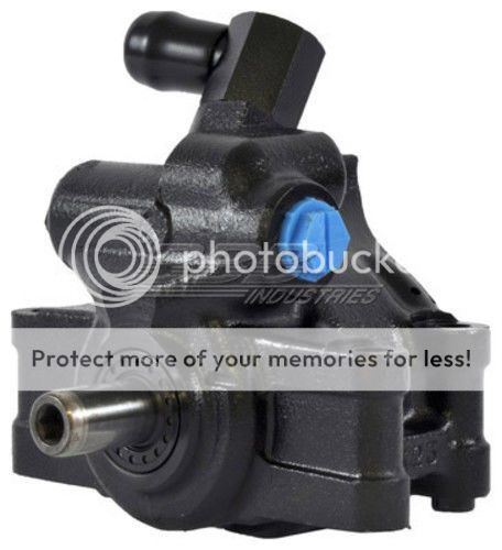

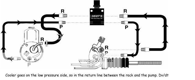

I'm running the stock PS pump on my 2004 Mach1 DOHC with a fox body rack. Not using Hydroboost steering. I have way too much assist, my PS pump sounds like a supercharger! I'm thinking the fox body rack likes a lower pressure? Other than a Heidts valve, what are my options? Is there a spring-cut option? Is this written up? Thanks!
