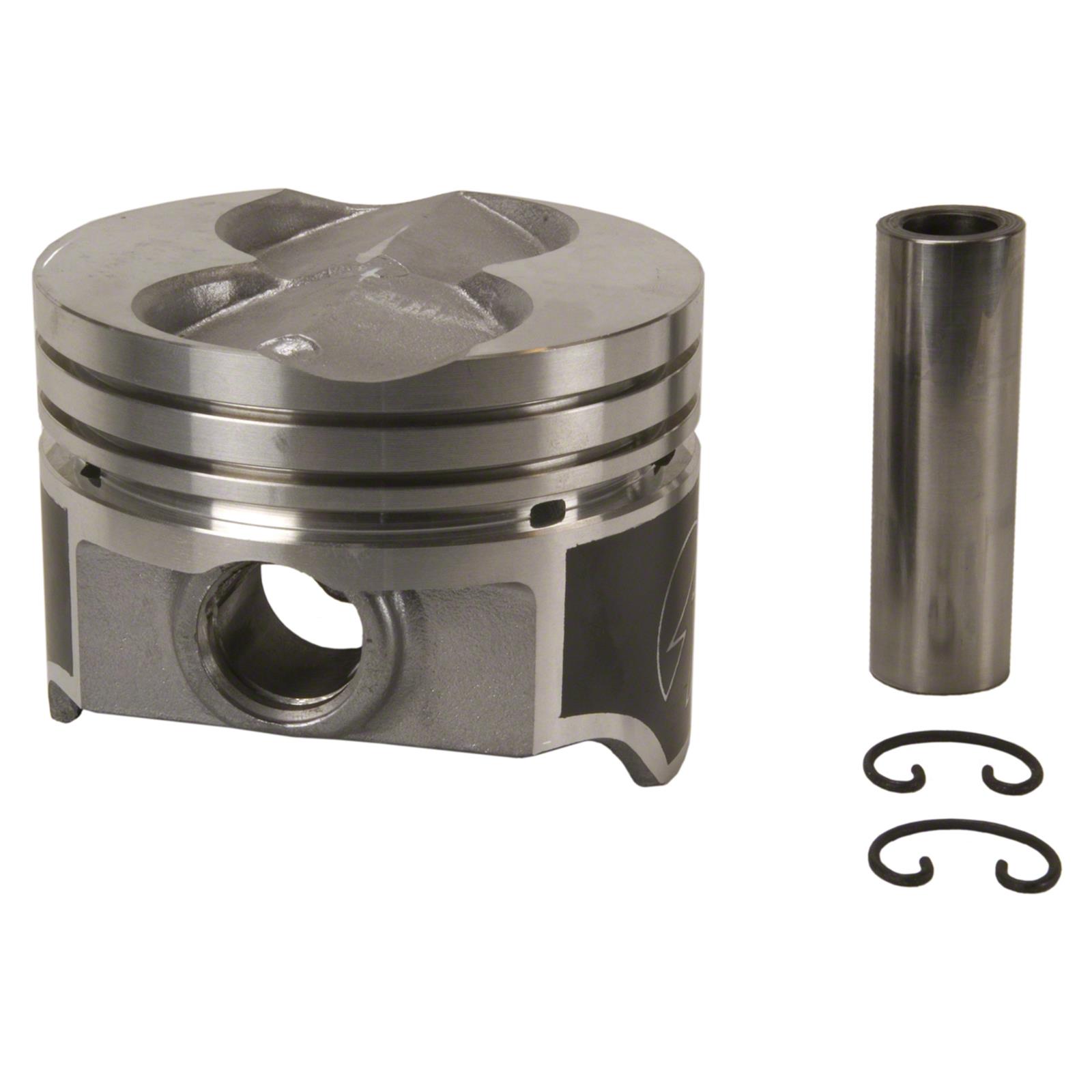

Speed Pro Hypereutectic Pistons 4.060"
$170

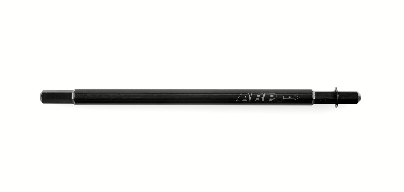

ARP Chromoly Oil Pump Driveshaft
$23

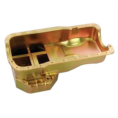

Milodon Stock Depth (4.1" stroke) Front Sump Pro Touring/Road Race Oil Pan
$440

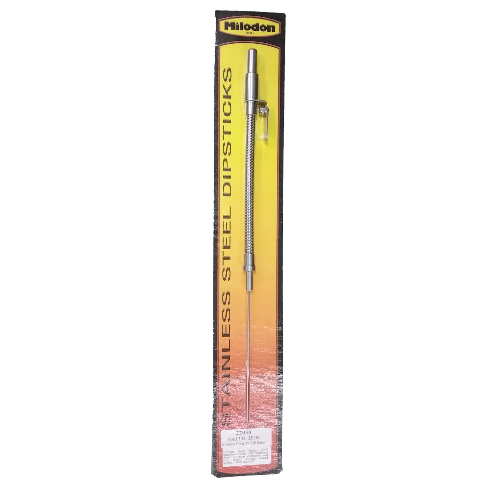

Milodon Stainless Steel Dipstick
$80

just a quick comment on your HV oil pump.
I had one in my original build, but other forum members talked me out of it. Unless you're running high RPMs, racing, or using an oil cooler, my understanding is that it's not necessary and might actually put some undue stress on the pump shaft and pump/dizzy gears. I ended up switching out the pump after I installed the engine which was a bit of a PITA to get the oil pan off while laying on my back.

The .040 289 that went back in was built out of 302. I used a Milodon pan to get the volume up to 8 quarts and high volume pump with a hardened larger drive. The high volume pump supports the slightly loose clearances used in the friction reduction effort.

Measured my piston/deck clearance to be .056" which seems high, and is more than the book I have states (not a factory manual). One of those How to rebuild a SBF Books.
Confirmed that the bores are 4.060" which is also not recommended according to the book I have. I have seen plenty of posts from people saying .060" over is fine, and other that say "oh hell no". I guess we will find out! Going to keep my rotating assembly on the lower budget side just in case, but this engine had 25k on the rebuild and it was in a utility truck so I'm not terribly concerned.

Welcome to the fray! Looks like you are off to a good start and have a nice parts list picked out. I always go with standard volume and pressure oil pumps as there is no need for extra pressure or volume and its tougher on the distributor gear and camshaft. Also always use a chromoly oil pump shaft. I can still see the cross hatch in the cylinders, you might get away with a hone and new rings but you would have to measure the bores to see where youre at. As for the rod bearings, the top usually has the most wear because thats where the pressure is compressing and then combusting. use good fasteners where you can, you'll need to resize the rods if you do rod bolts. No worries on the deck height, it helps take a little compression out of it but if its going to the machine shop, it would be a good idea to deck it at least to get a nice square and clean surface for the head gaskets to seal on. Good Luck and keep up the good work.
