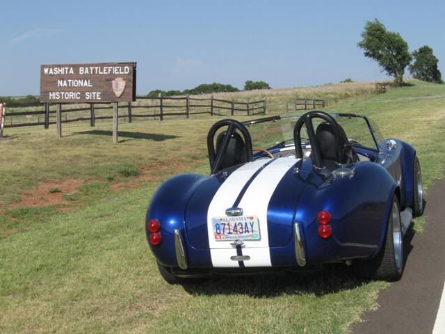

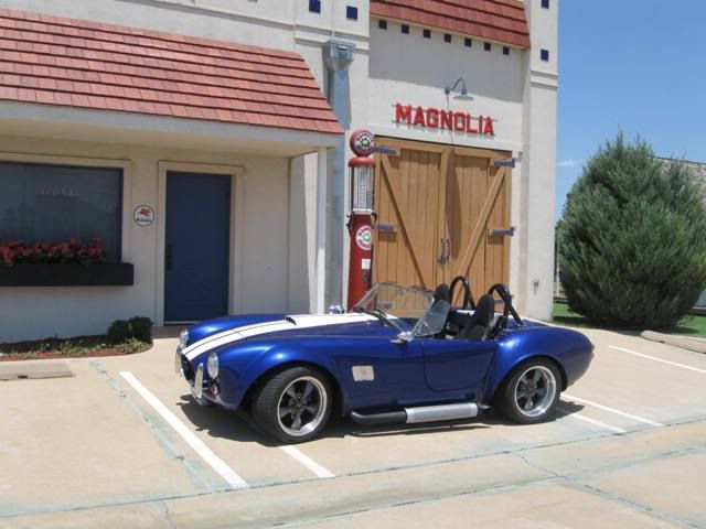

It's time.
Purchased Dec. 05.
widened driver and passenger footboxes
modified wipers from some 90's Ford (don't rmember)
heat & defrost
Miata seats and belts.
Rear shelf and hinged door to trunk
"Ken's" door panels
Tan Lowes carpet
Cockpit insulation from J C Whitney
Infinity backup light
Mazda van courtesy lights in trunk, between seats and under dash.
Hinged panel under dash
Computer in wall on right side of passenger foot box
Custom side pipes
Rebuilt 5.0 with Ford E-cam
Probe turn signals
Sonic blue with white stripes

Very nice!!!!! Congrats.

Looks good! Congrats

Very nice looking car. Love the colors and all the extras that you built into it. These cars are all a little diffrent but that is what makes them so interesting.
Enjoy the ride.

Nice clean build. Interior looks fantastic.
Now enjoy the (s)miles.
Congrats,
