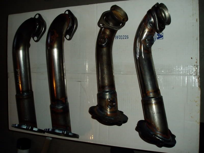

Looked at my pipes and now I'm stuck. From the pictures the pipes on the left are the same but the right ones are different lengths. Also the shorter has one with two oxygen ports. I think that one is for sn95 cars, can someone confirm this. Thanks for all the forums help.

The one w/2 ports is for the LH side of the engine. The 2 pipes on the right are the same and are used on the rh side. This is for a pre Sn95 car right?

It's a little hard to tell from the photo but I would guess that my J-pipe is the same as the one on the far right. If I lay both of them side by side the one pipe is approximately 2" shorter and the square flange has the smallest clockwise rotation.

Could you measure the pipe? Measure the total length on the outward bend side, flange to flange. Thanks Bert.

42cm from butted up against the square flange to the weld at the top flange.

Why do you have two sets of pipes? I believe it goes like this:
The short one with two ports is for a 4.6L, the one with one port is for a 5.0.
The long one on the far left looks to be labled 87-95, so obvously it is for a 5.0.
