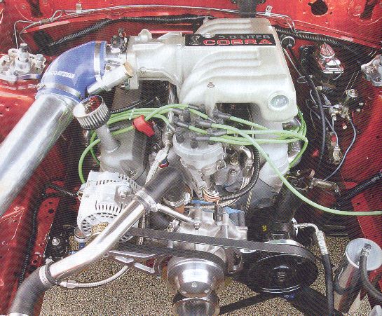

I saw this oil cap/breather in the December 5.0 Mustang magazine. I looked online, but could not find it for sale. Is this a fabricated piece or does somebody sell this?

Kirban Performance makes one, so does K&N...
They simply screw into the valve cover in place of the fill cap...
HTH...
