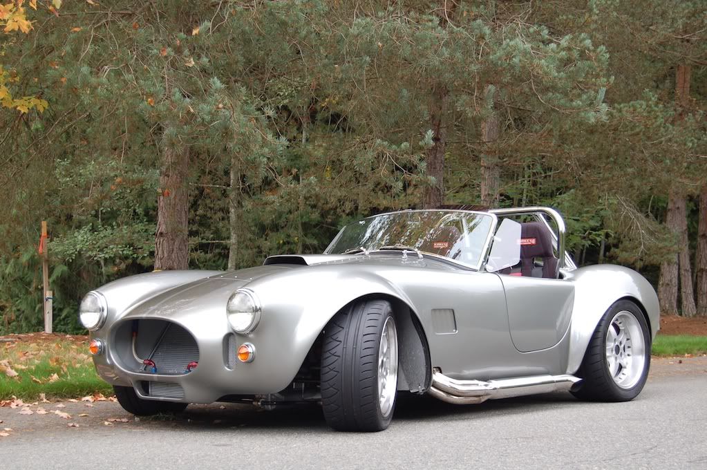

Okay, time to stick a fork in it, and graduate. First I need to thank my wife for all her patience and support throughout this whole project. Second a big thanks to all my homies - Arch, Joe, Doug, Neal, Carman, et al - you have all been a great inspiration for my build - it wouldn’t have turned out anywhere near as well without all your help and advice.
Okay onto the details. Kit was purchased as a one of Patty’s Bargain Basement kits in November 2008. It was a basic bare bones kit - bare chassis, 4 link etc etc.
The initial plan was to use my fox body mustang as a donor, however when the time came, I couldn’t take the hatchet to it, so I ended up doing a non donor build.
Engine is a 408W built by Brian Adams of www.adperformance.com. It’s a basic 408W, AFR 185 heads and Comp Cams XE282HR cam. Transmission is a TKO600 with Fortes driveshaft loop.
Front suspension is pretty standard with F5 LCAs and SAI mod. Tires are Kumho Ecsta XS. Wheels are from a mustang wheel website - forgotten which one!
Rear suspension is IRS with poly bushings in the spindles and solid pumpkin bushings.
Power steering and power brakes were installed with a Heidts valve and cooler installed in the steering lines.
Fuel tank is a 22gal Fuel Safe fuel cell, with some modification done to the trunk area to get it tucked up and out of sight.
Paint was done by SRP and is a 2008 Mustang Silver Vapor Metallic with a touch of black added for the stripes. It has most of Ken’s add ons - rolled cockpit, hidden hinges and hidden body mounts.
