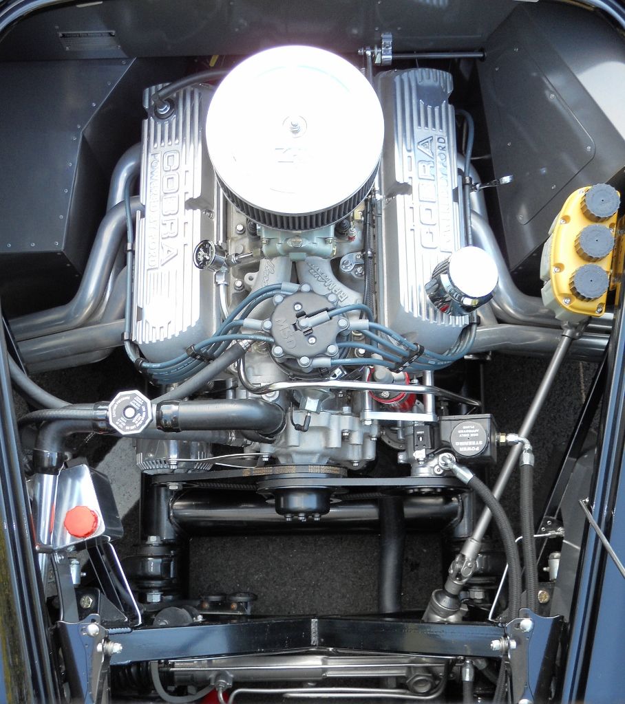

love the interior, and that v-belt set up is cool! what brake fluid reservoir is that?

Thanks Pete. The brake fluid reservoir is from Tilton Engineering. I did fabricate some 90 deg fittings so the hoses exited to the back.
The V belt set-up gives me redundancy...if I throw a belt I still have another driving the water pump...and it is clean and simple.
Drive On is correct. It drives as good as it looks...maybe better.
