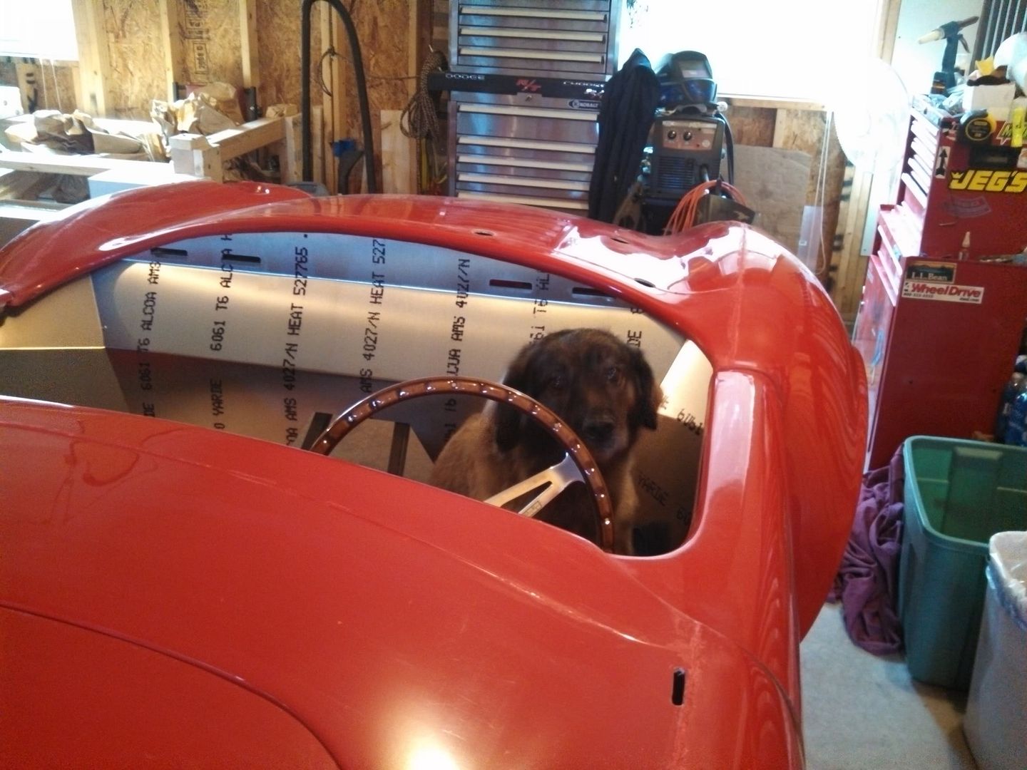

The obligatory staged shot with the steering wheel. I was dog tired but still having a howling good time.:D

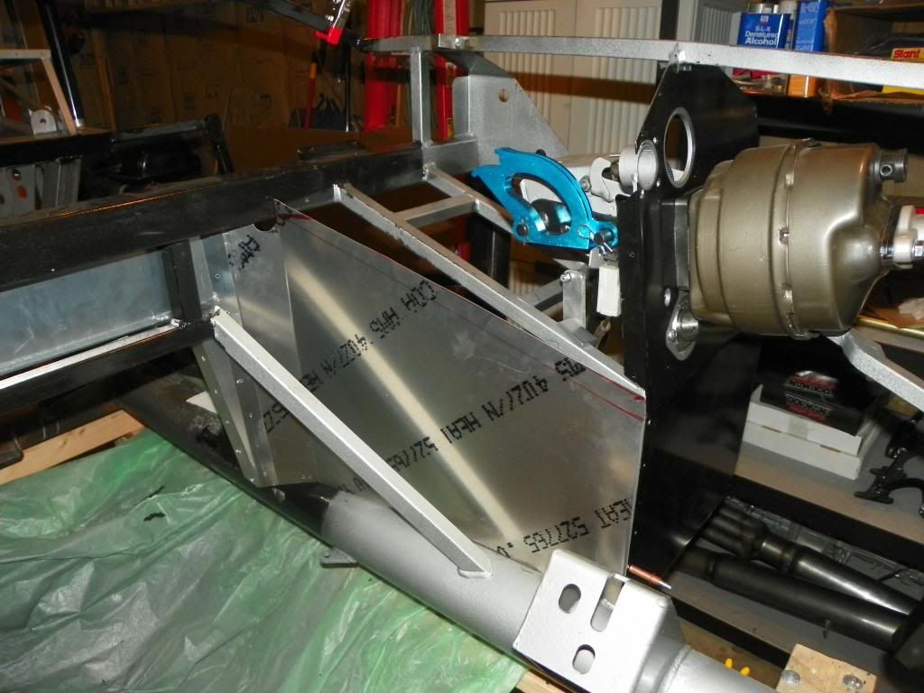

I decided to do a firewall forward mod. I went with 3". I will be running an FFR heater and a glovebox, either my own or one of Alex's. I attached the firewall below the 2x2 so that I can use that 3x2 space for a plenum for the DS & PS heat, or to run heater hose and wiring in.
I had to weld a couple tabs on the 3/4" tubes to support the top
And using the FFR firewall as a template for the top radius, I cut a new firewall from .090" aluminum. I ended up botching my first one pretty bad trying to bend it on my little HF brake, so I scrapped it and took the next one to the local sheetmetal shop and they bent it for me in 5 minutes.
See less See more

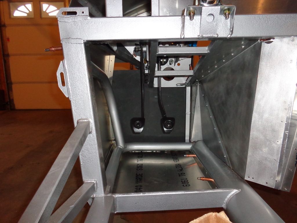

I shameless stole Mike Kelly's Spark Plug Mod for my DS footbox. It takes nothing away from the pedal area and clears access to the back header bolts and sparkplug. It was a no-brainer decision to take it on since I am running a 351W.
The combination of all these mods in the firewall/DS footbox had me fit for a straightjacket for a couple days, but it all worked out ... more or less. I will have to touchup some scraped paint in the engine bay, but I am happy with the results so far.
