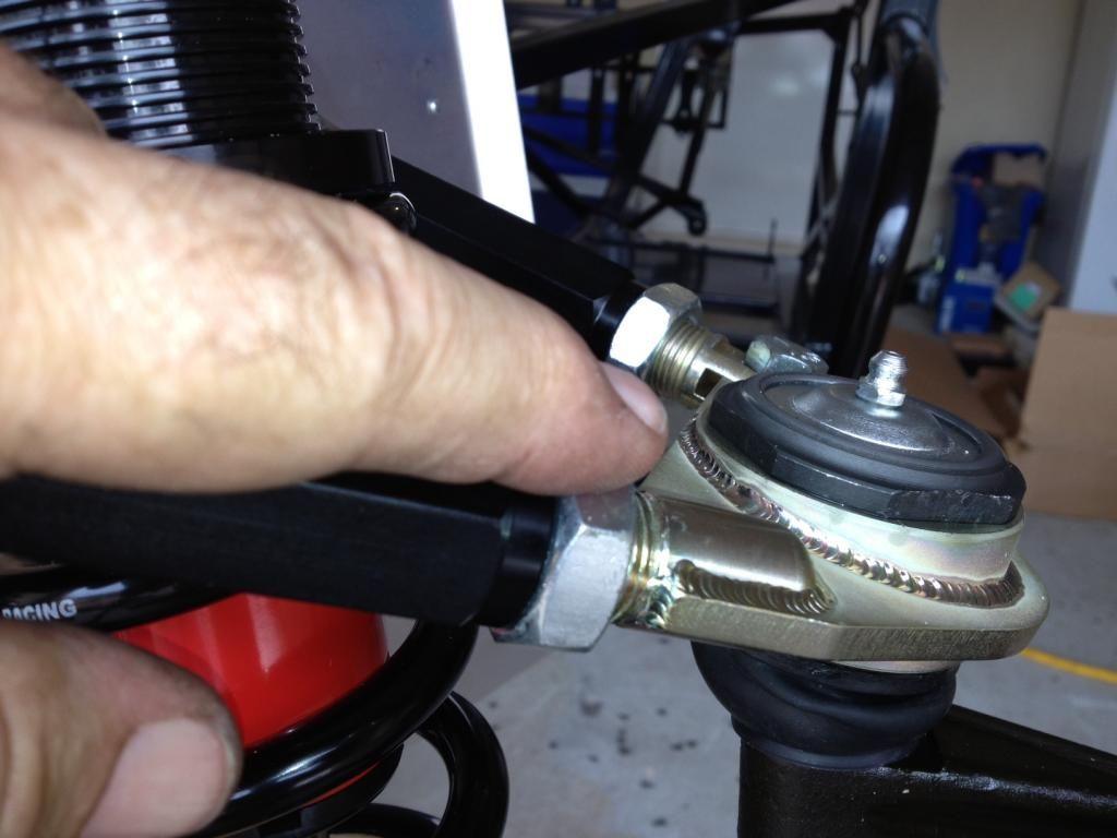

Could you give me your thoughts on the below UCA installation. They have been fitted with the threaded section to the front of the vehicle as per the build manual however the geometry of the ball joint just doesnt look right.

You are good in the second pic. Sorry the first one did not come up last time I opened it up, You need to set them up with the larger sholder portion up. The set up is done that way on the older ones because there was no difference in height regardless of orientation so that they look like there is a right and left.
If you talk to the Factory they will tell you the same.

I'm with xssive on this... they changed the upper control arms and one welded end goes forward and the other one goes rearward... talked to the factory and that's what they said. Just installed mine on Tuesday.
