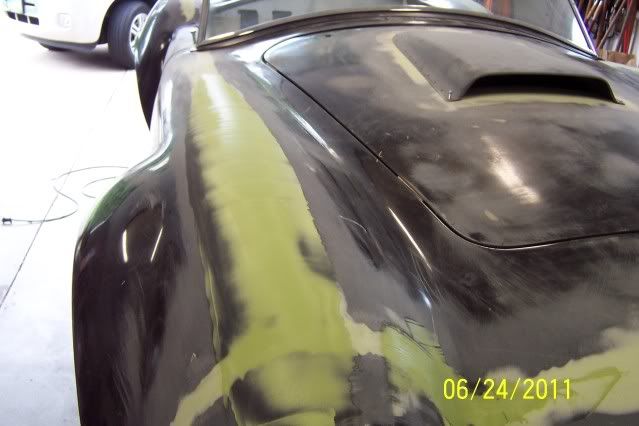

Kevin,
Here is a pic of my passenger side fender right after pulling a hacksaw blade over the rage. I used the hacksaw blade twice on each side with block sanding between applications. Just try to match the curve of the blade with the radius of the fiberglass. You don't a lot of time to work with the rage before it starts setting up. You'll get the hang of it.

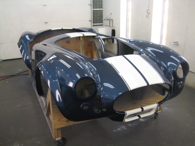

Same fender after paint
