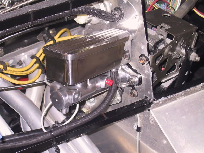

So far I am impressed. The MC and pump were very easy to install and I just have the pressure line and power to connect before I bleed the brakes and give it a try.

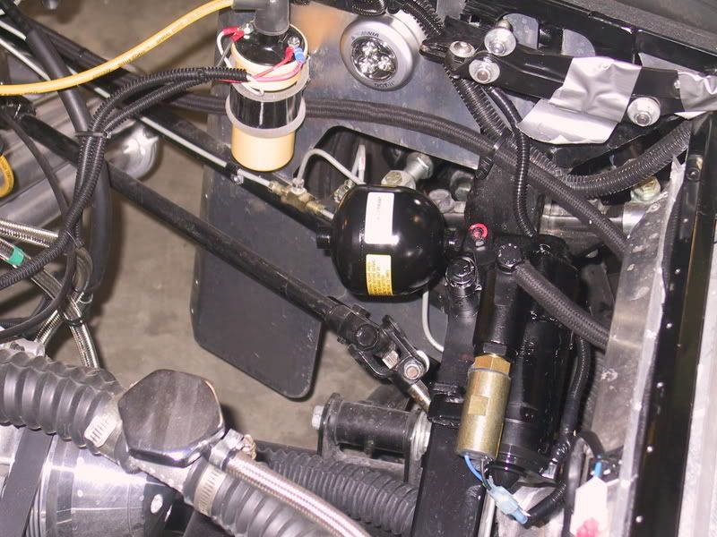

Now - There are three wires to the relay. One red (Battery), one blue (ignition) and one black (ground). The relay is fitted next to the coil which has switched power from the ignition. Can I use this? Any advice will be appreciated,

You should have dedicated fuse protected ciruits for each of the wires.
If you do use the coil for your blue wire put an inline fuse between the coil and ABS relay.
I haven't had a chance to bleed and power up yet. I have a 15 amp fuse for the pump power (red) and a 5 amp for the ignition to relay power. I may bump that up to 20 amp for the pump. After all the instructions call for a size #10 wire from the battery. Thats pretty big. The only other wire that size is between the alternator and battery post on the start relay.
