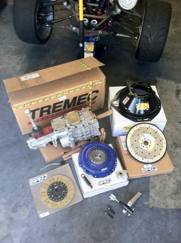

Mike forte is the guy to ask for all your transmission needs that's where I got mine it is a TKO 500 I went with that trans because the 5th gear is perfect for the stock rear gear I used the 3.27 the 5th gear is 1 to 1 I was going to use the 3.55 gear I brought one and everything it's still sitting on the bench but its geared perfect this is what I used Spec aluminum fly wheel clutch pressure plate quick time bell housing forte hyd slave cylinder if you want to buy a kit with a 5.0 coyote I'll sell you mine it's all fitted all ready for paint and powder coat the colors you want
