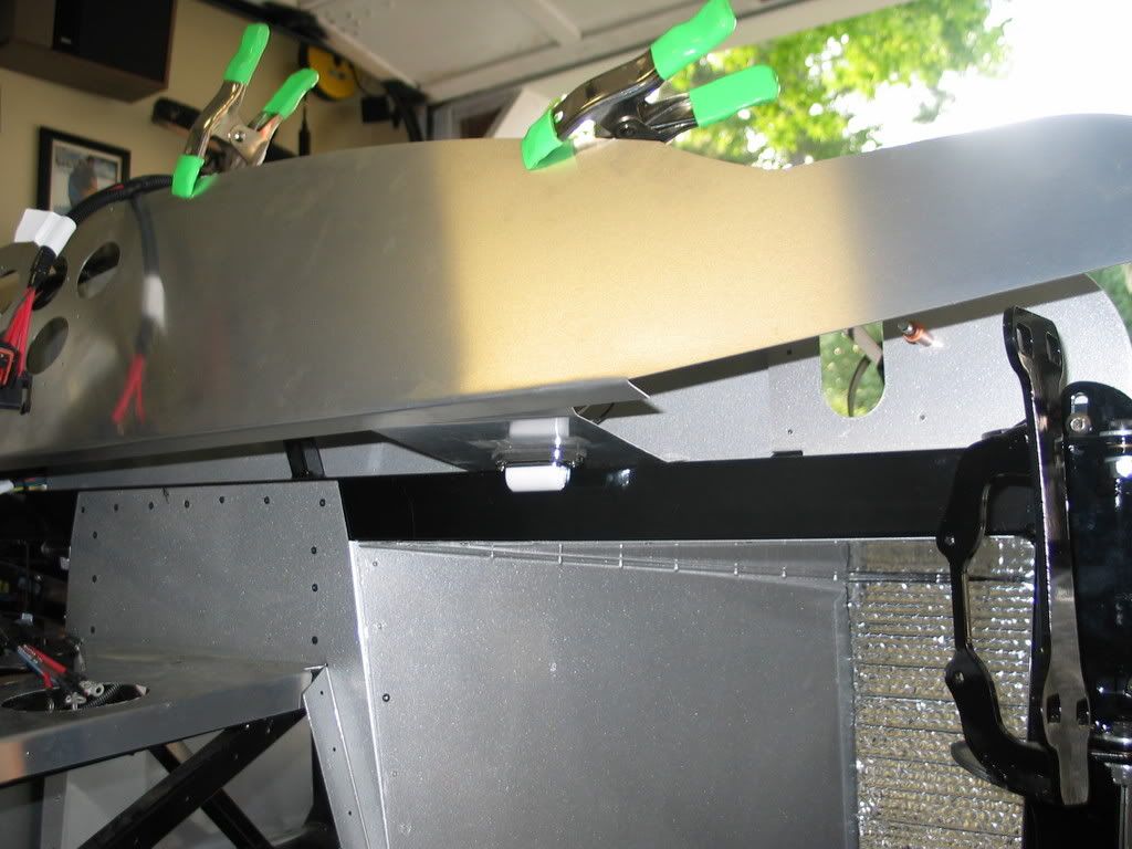

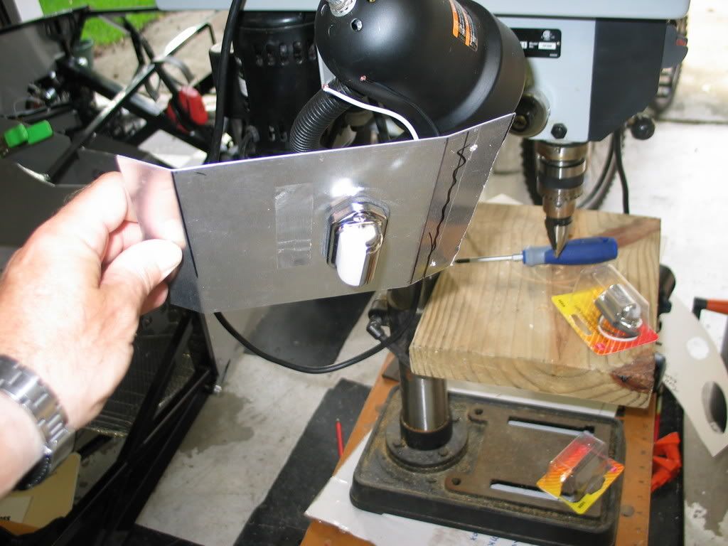

During my surprise visit from Cobradawg last weekend, he mentioned one thing he'd do differently would be to add courtest lights for getting in the car in the evening. I was paying attention. Found these at LOWES for $3.99. If they are bright enough they really seem to be a perfect/easy/inexpensive(never used that word on an option) addition.

Bob there is but then the wires show in my engine bay, not what I wanted. Mounted here you can't see it and you'd be hard pressed to hit a knee on it. You could slide the mounting aluminum in either direction to miss heater.

I used the same lights and made the same brackets, they are perfect for lighting up the footboxes. I found them at Autozone for about the same price. My light switch is a GM unit that when you turn past the dimmer you turn the interior lights on. I also put 3 in the trunk, 1 on each side and 1 toward the front of the trunk which are hooked up to the footbox ones.

Todd, I have those same lights in my truck. Do yourself a favor and turn the shield around so the lens is facing forward. You won't get any light up there if that's what your looking for. Also, Autozone carries the 194 bulbs but in blue. Gives a really cool mood to the car.

I faced them back because (they are under the dash so they won't shine in your face) to see how to put on the 5 point harness.

I mounted mine to the 2x2 cross brace. they are out of the way and light up the footbox's. I also ran the wires inside the 2x2. they are hooked up to the dimmer switch, just like in a real car.
