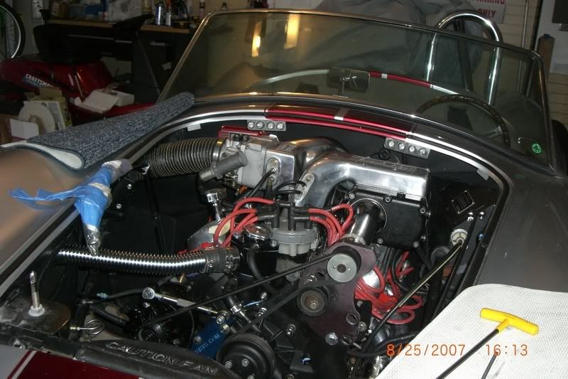

setup:
Cobra Earl's SBF Adapter
Summit fill port with overflow
running hose from fill port to stock position overflow tank
16lb radiator cap on fill port
195degree thermostat
stock radiator
fill port on side of radiator capped off with rubber expansion plug. It's still solidly mounted.
Drove home from dyno yesterday...overheated on the way home.
Today: filled up car with more fluid. Quick drive around (about 1 mile). Temp climbed to 235 by the time I was home. Steam coming through the sides of the cap. Coolant on the side of the timing cover. Looks like it's coming through the sides of the radiator cap..where the steam is coming out.
Filled car up during the day at different times. Took about 1/2 gallon. It would take water to the top of the port...then it would slowly disappear into the engine. I kept filling until the level stayed to the top.
Tonight: Put the cap on. Went for short drive (about 4 miles). Temp got up to 235 by the time I pulled into the garage. Steam coming from the cap and fluid on the side of the timing cover. Fluid sits around the cap.
What gives?
Defective radiator cap? It looks & feels just like the last one.
Here's a pic of the parts:

Problem was simple. Make sure to turn the radiator cap all the way...not just to the first click.
I took it around the area and it stayed under 210. The car always ran about 10-15 degrees hotter than the thermostat...I think because I have the supercharger. With the 195 thermostat in there, it's just about right.
I probably still have some air to burp, so I'm going to let it cool down this morning and fill it up some more during lunch.
Should be able to take it out for a nice cruise tonight.
