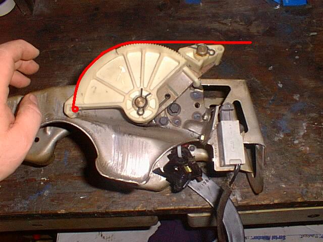

my crazy mustang friend took my car out for one run and busted the clutch cable clear off. it was probably fraying for some time though.
any tips to fix this? its really tight in there and im not exactly sure where the rest of the cable is. it seems to wind from the pedal up back under the dash.

James,
Here's a picture of the stock quadrant. The cable rests in a groove on the top edge of the quadrant and passes over the hinged pawl at the front of the quadrant.
