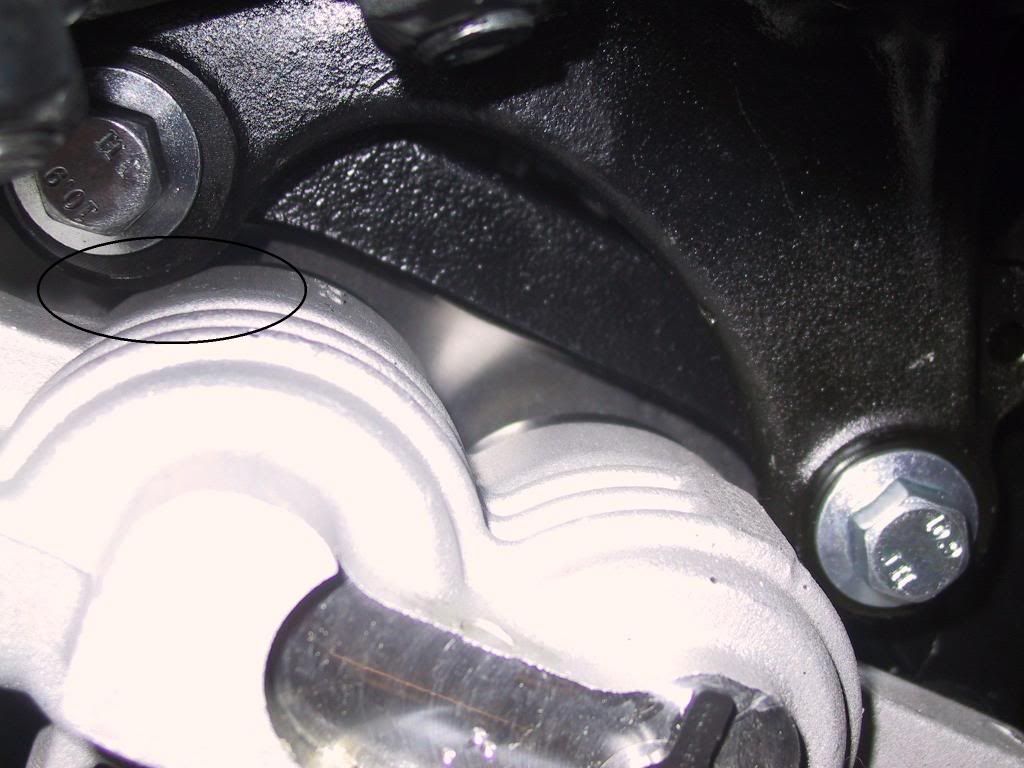

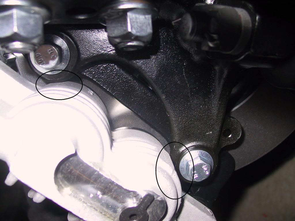

I have the aluminum 2 piston PBR front brakes from the FFR brake pkg and SN95 (94-95) spindles (with the dogleg).
Do I need to grind the spindle near the mounting ears to make it fit?? It seems that at least the top one is making contact and the lower one is very very close (See pics)
1,345 Posts
Yes, grind them slightly for clearance. This is a very common modification for the PBR 2 piston calipers. The reason is that the two piston calipers were not available in 94/95 but luckily (for those of us that have them) the hole spacing is the same.
