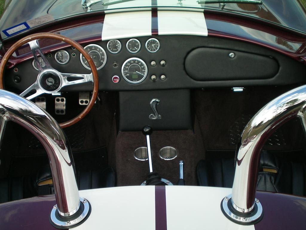

I think I bought the competition dash from another forum member here. Don't really know where it came from originally. I mainly only had to cut the small switch holes, just used a small bit for a pilot hole and then full size. I think I did have to cut one of the larger ones for the clock or something, just used a hole saw.

Thanks a lot, guys. As for the wheels, that was one area I decided to just get something on there and then I could upgrade later. They were inexpensive ones from Summit....and they're kinda growing on me.

Oh, where did you get the cup holders

The cupholders came from a billiards supply house, I think. They had all different styles and sizes as I recall.
