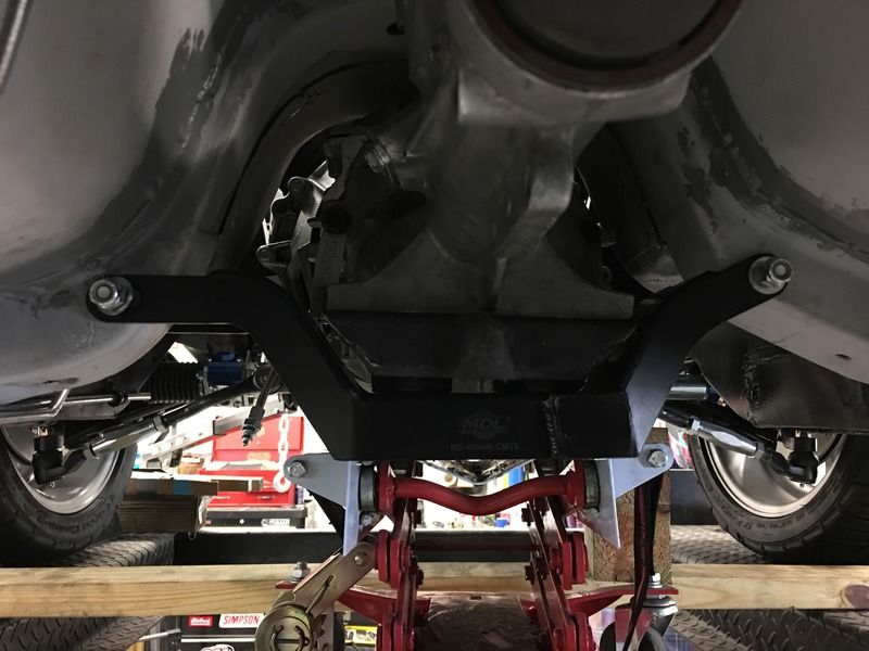

Take a look at the Maxx Jack. One of the members here (edward) has one for sale now, but he's up in Michigan. Would be good for you to talk to him to see how he likes it though...it's a perfect solution for a low ceiling height.
You won't be able to stand up under the car, but it's so easy to get stuff done underneath when your sitting on a rolling seat.
You could build the body cart so your car will sit on the front frame rails and rear frame rails...then it will still work later on.
That's how my car was resting on the cart I have...here's a picture where you can see it.

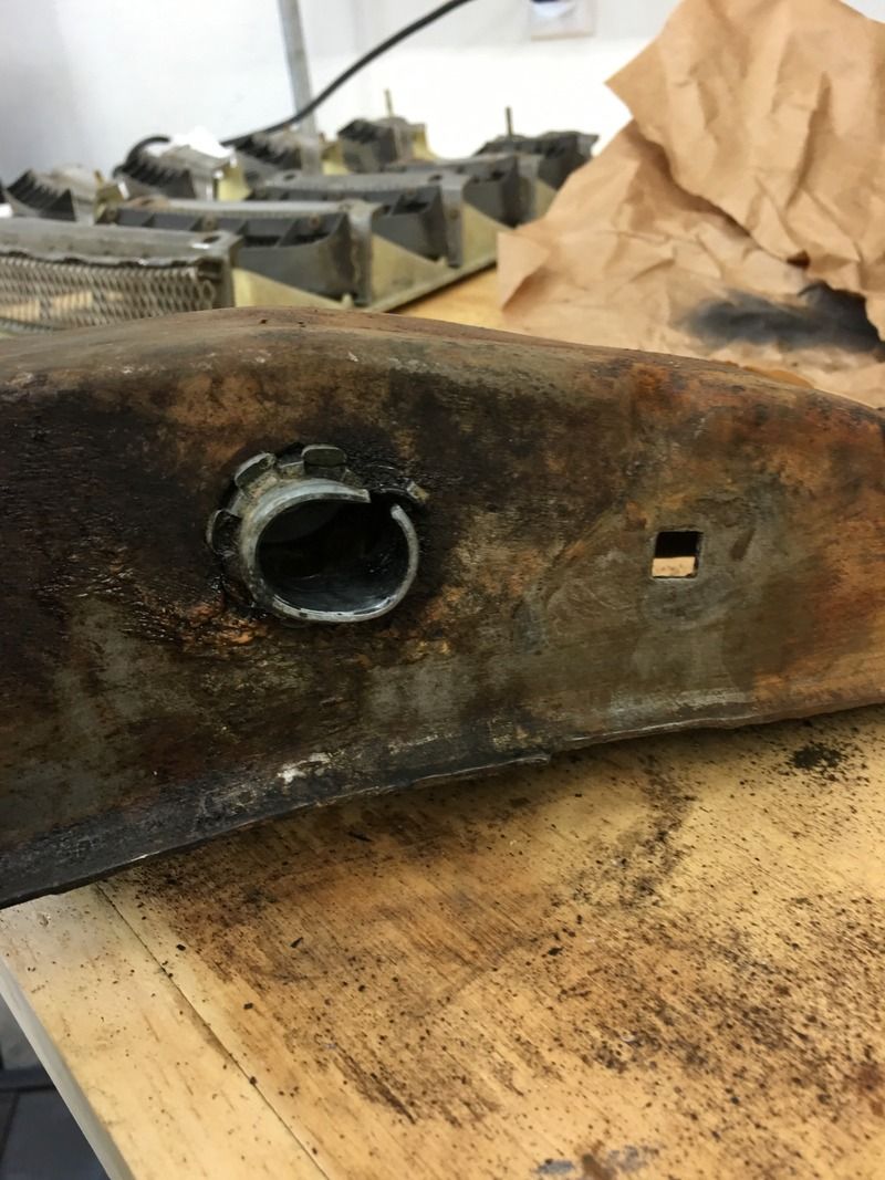

Check your pedal box to make sure it's in good shape...this is what the one I bought looked like.

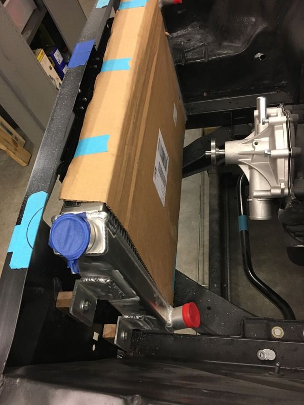

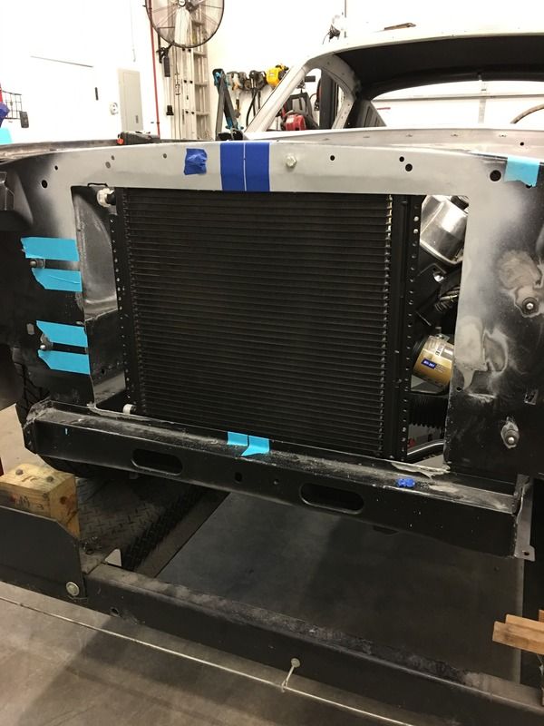

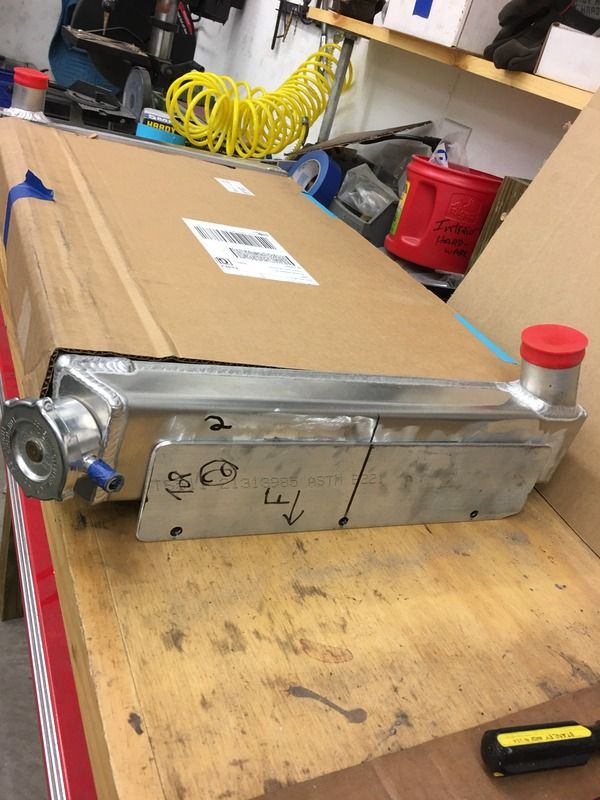

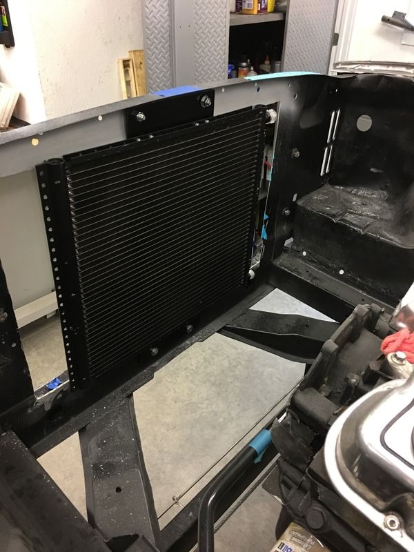

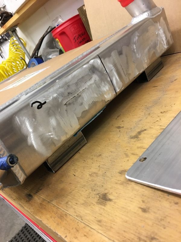

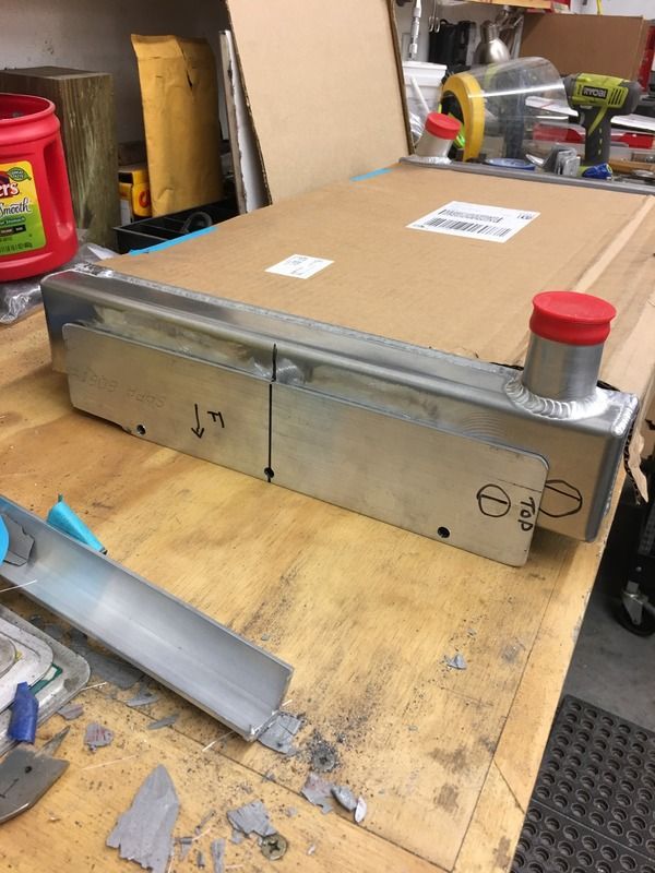

Got my radiator back from getting brackets welded to it.
I won't be able to use a standard sized battery in the stock location...so I'm thinking about using a Braille battery (or similar sized one) and making up my own battery tray. I measured and it should fit in the stock battery tray location.
I'll need to trim a bit of metal to get the radiator cap on & off...but I will wait until I mock up the A/C condenser just in case I wind up moving the radiator back a bit for clearance.
I need to add a bit of sheet metal to the top of the radiator opening so I don't have a gap at the top of the radiator. I've already got the sheet metal to use, so I'll get that in soon.

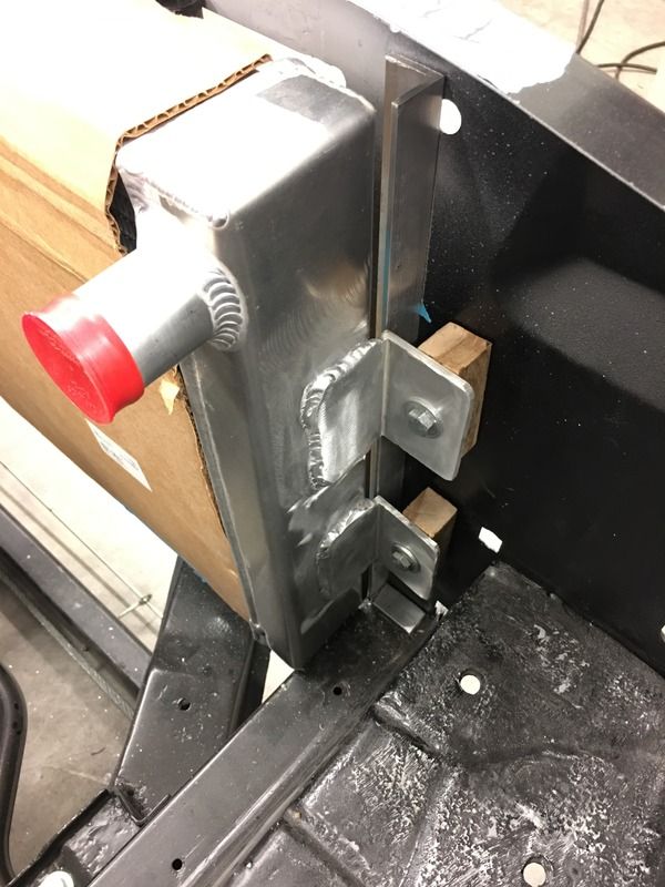

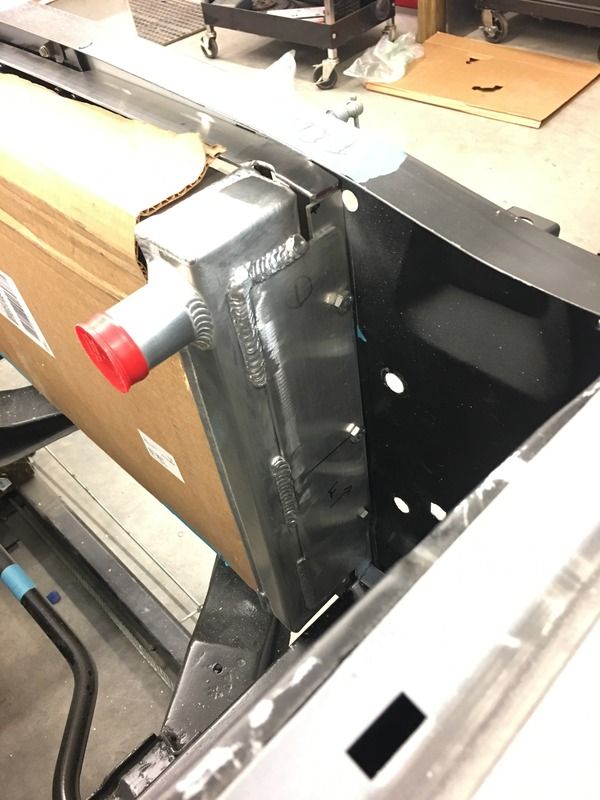

My welding continues to improve. Learning new skills has been the best part of this project.
Added about 1" to the top of the radiator opening today.
Still need to clean up the engine bay side, but the opening fits the radiator better now.

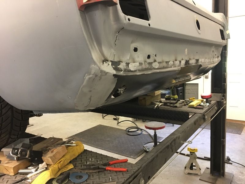

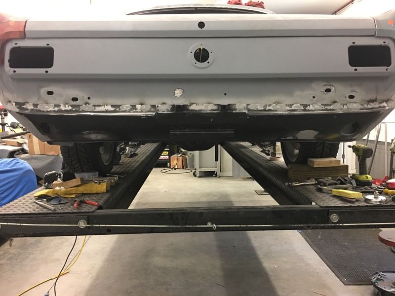

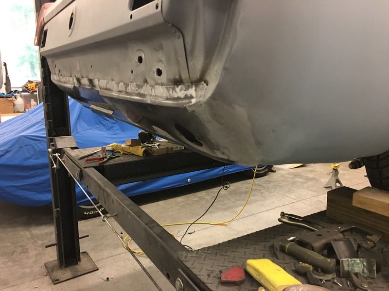

Started fitting the rear valance using tips I found in another build thread at VMF. This part is notorious for not really fitting these cars...especially cars that have had the quarters replaced.
I cut the ends off the rear valance and tacked them to the quarters.
Then welded some sheet metal to hold the panel in position.
Started filling the gap with sheet metal.
Once I get the other side done, I'll take it off and remove the tabs...then fill in the rest of the gaps and fix the spots where I blew through. I'll be able to use a copper sheet for a backer to make filling in the gaps easier.
On the originals, this is a bolt on part, but I'm still thinking I may weld it to the car. I like the cleaner look and I won't have to worry about welding the brackets back onto the backside to hold it in place.

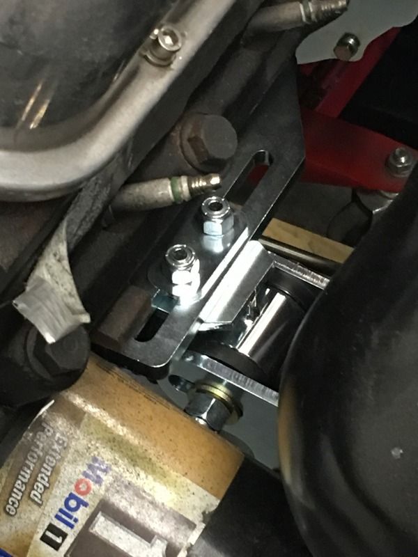

My uncle is coming to town so we can go to the Charlotte Auto Fair and is going to help me get my engine/trans together and in the car to make sure everything fits.

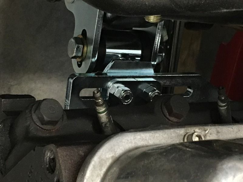

Was getting my adjustable motor mounts together and one freaking bolt hits my power steering rack lines. This sucks!
And it still needs to go in a bit more.
I don't think I have enough room to shorten the bolt and still have it stick out past the nyloc nut...will check that out just to be sure before I drop the rack.

I have the same mounts, be sure and check the shorter bolts that hold the upper parts of the mount. On mine they were also too short to allow the any washers to be installed.

Those bolts are good. The kit comes with a square 'washer plate' to attach the round mount to the block plate.

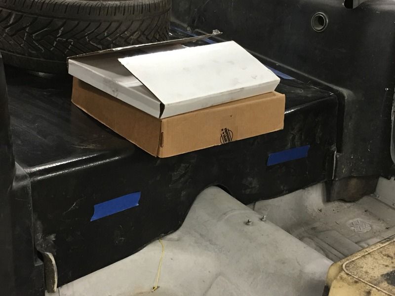

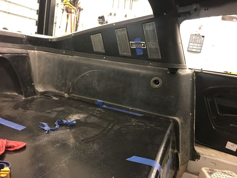

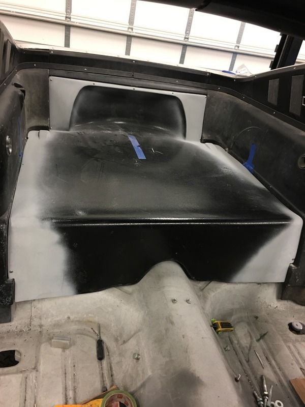

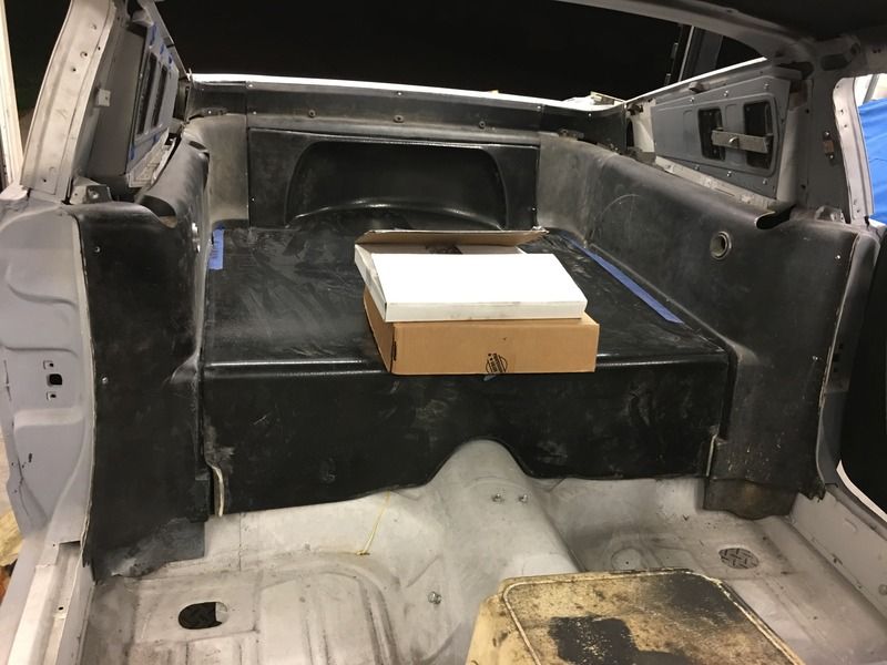

Been working on installing the rear-seat-delete panel.
Had some trimming to do...mainly because of having to add spacers to get the gaps in my side trim panels to look right.
Here's how it looks as of last night.
I have some boxes (flywheel & clutch) on the front to hopefully get the fiberglass to settle into it's new position.

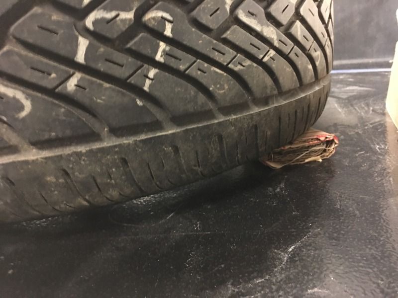

The wheel bulge will push back so it will sit flush once I get some bolts installed. It leans a bit forward now:
Maybe hitting the curved edge where it bends up with a heat gun (or just letting it sit in the sun for a while once it's bolted in place) will help.
Maybe it's because the tire is just a hair too big for the bulge, but in order to get the tire back in the bulge, I have to put something to lift the front up a bit.
I guess I could pull the tire forward a bit till it sits flat. Have plenty of time to decide.
Way down the road, but I'm thinking of building a box behind the panel to mount speakers. I could put some plain black speaker grills on the face of the panel for the sound to come through. Placement of speaker grills where the blue tape is:
With the seats in place, I don't think the speaker grills will be as noticeable, but I think it would sound better than having 2 smaller speakers in the kick panel. Plenty of time to decide on stuff like this.

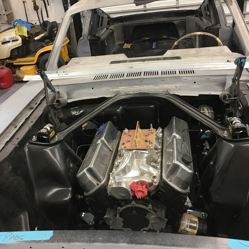

Got the engine & transmission installed today.
Dropped the engine in first...then installed the transmission from underneath. It was a lot more work than I thought, but we got it in. I might invest in one of those tall standing transmission jacks to make the final install a lot easier.
I have a stock style rubber transmission mount.
I could use one that's just a bit shorter because the top of the transmission just barely clears the tunnel support brace. I can just squeeze a medium zip tie between the gap.
Any ideas on a T5 transmission mount that would be shorter?
I have the Ron Morris engine mounts....this is how the front/back spacing looks on the mount (302 engine).
Driver side:
Passenger side:
I haven't measured for my driveline angle yet...I know that will change if I get a different transmission mount.

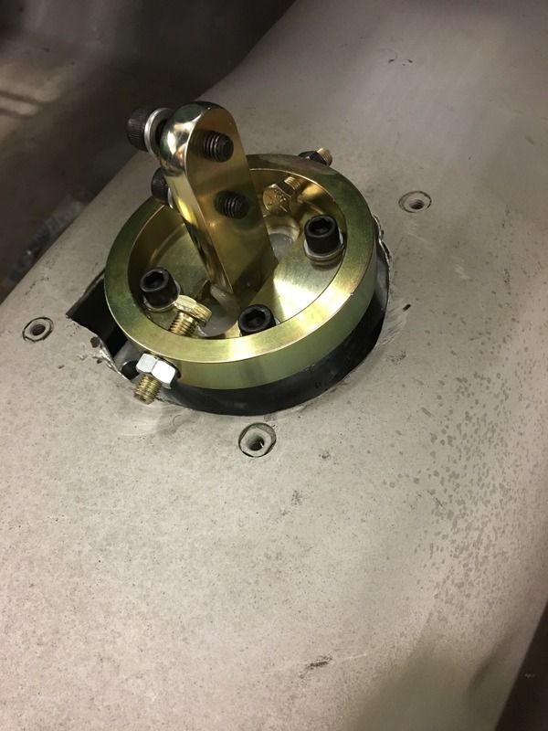

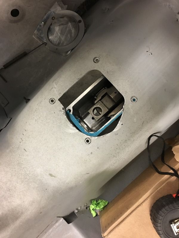

Test fit the shifter and cut a bit of sheet metal so I'd have 1/2" of clearance.
Had to see how the Hurst stick looked on it.
The shifter is tapped for 5/16" bolts but the handle has holes for 3/8" bolts. Wonder if I can find a collar to take up the gap?
Gonna have to figure out which shift boot & trim ring to use..I don't think the stock sized one won't fit around the Pro5.0 shifter. That's a challenge for a day far off in the future

Added some glass to fill in some gaps in the rear seat delete panel.
Before
Going to take it out today to make it look good
FFR5857
PS/PB/AC

Finished the glassing/filling/sanding to get the rear deck to fit nicely.
Going to wind up sanding down the rest of it and then using a roll-on bedliner called Monstaliner to get an even texture back. I'll wait until after I'm ready to install this for the final time before doing that (don't want to risk it getting damaged in my garage until then)
Ordered my AC setup today from Classic Auto Air. Doing custom line routing to keep the engine bay clean...so will have to figure that all out next.

Fit & Welded the rear valance to the car.
Since I'm doing a tight fit fiberglass bumper, I welded the bumper extension holes too.
Still have some finishing work to do (sand/fill/sand/etc).
I'm also going to fill in the quarter panel to rocker seam. The quarters are repops, but the rockers are original and I fear the metal might be a bit thin for welding (the car was sandblasted before I got it). I could use all-metal filler, but I really don't want to risk it cracking down the road, so I will most likely figure out how to weld it without blowing it apart.
Maybe if I used a thin metal rod to sit in the seam and then tacked that in place...anyone have any tips?

Time for a step backwards...I screwed up my radiator mounting. I welded brackets to the radiator a while back, but forgot that I needed room in front of it for the AC condenser. When I was looking for ideas, I used another build for inspiration, but didn't factor in that he didn't have AC. I feel like a moron.
I bought the AC kit from Classic Auto Air and worked on mounting the condenser. Doing a custom mount since my compressor will be on the lower passenger side.
The radiator needs to sit about 1" back from the face of the core support. It would look like crap if I just used spacers (test fit here with blocks of 1x1).
So I'm going to grid off the brackets (hopefully without screwing up the side tanks) and start over. I have a plan on a new mounting setup. Will post pics when I figure it out.
Wonder if Chip Foose made mistakes like this when he first started out.

Not really. I'm using the front racing valence and it wouldn't look good with the condenser sticking out past the face of the core support.
Attached is a picture of a car I found online for reference.
I'm making progress on my new mounting solution. Putting some 1" angle on the core support. I just need to grind the brackets off the radiator and get some flat stock welded to the side. The flat stock will bolt to the side of the angle pieces. Then I can drill some holes for the condenser lines to pass through. Once everything is painted, I don't think it will be a distraction.

Got the old brackets off the radiator and made up the side mounting plates. Going to get with a local guy to weld these to the tanks.
With the radiator sitting on 1" square tubes on the bench, it puts the brackets where I need them.
Reference marks on the brackets & radiator so it will all line up.
My plan is to get this in the car and bolt it to the side plates...then I can drill the core support to mount the L brackets to the car. Then everything should fit perfect.

Got my radiator back from the welder and spent a couple hours getting holes in the core support brackets drilled.
Once the brackets fit well, I got the L pieces temporarily mounted to the core support.
I might redo the L bracket I have going across the top and still have to make up a similar L bracket to block off the bottom of the radiator. Then I'll work on making brackets to mount the Ford Contour twin fans.
