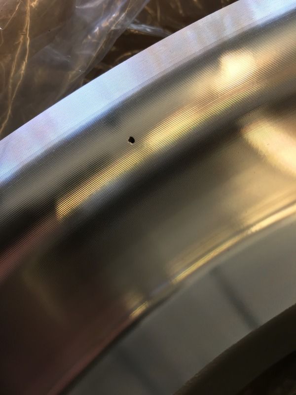

Wheels arrived
Wheels arrived today. Had to take a quick picture.
One of the wheels is pitted along the polished edge. Looks like a void in the metal popped during machining. So much for Cragar's QC. It's a pinhole sized 'pop', but they're new and it would drive me nuts every time I cleaned the car.
I notified the seller on eBay and told them about the problem. I said I'd keep the wheel as a spare if they would sell me another one for a discounted price.
They got back to me within 20 mins that they'd sell me another one for $79 (about 25% off what I paid for each wheel). I wanted to have a full size spare to put on the rear deck of my car (no backseat anyway), and I couldn't find a plain steel wheel with the same specs for less, so it was a no brainer.
So my wheel mounting is on hold until the new one shows up, but I have other stuff I can do in the meantime.

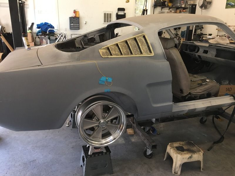

Dan, is that plastic stool (the one under the jack stand) strong enough to trust when you are under the car ?

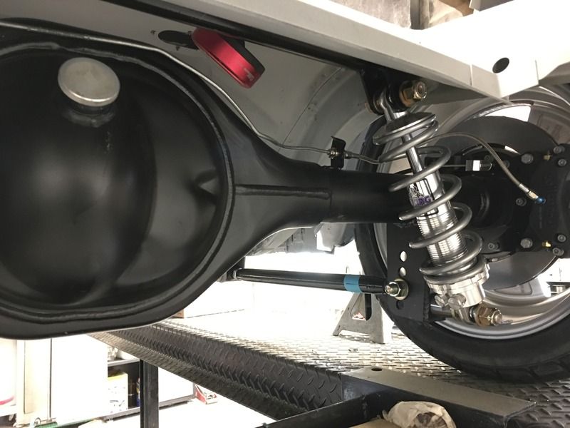

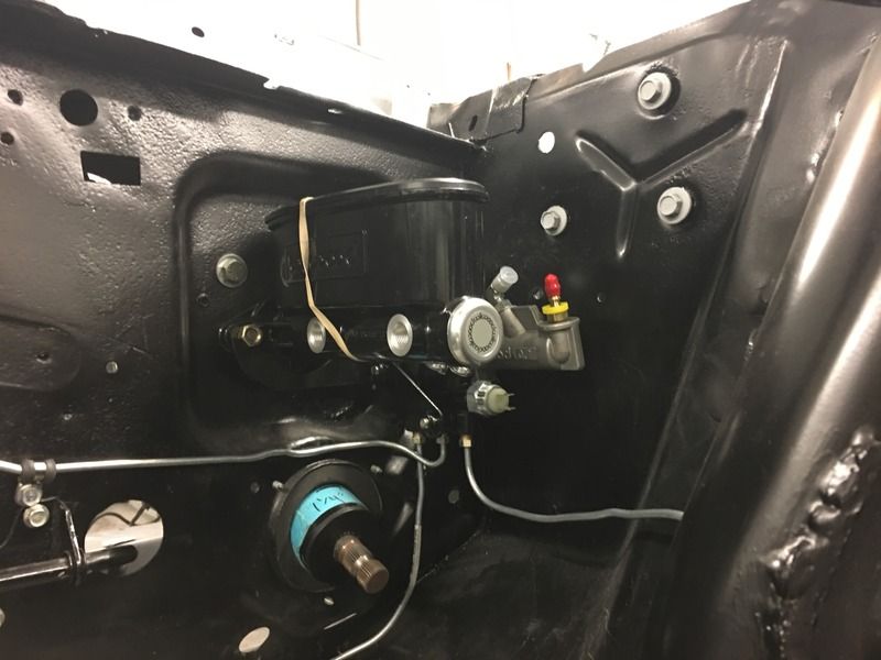

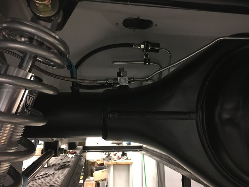

Been working on the brake and fuel lines since my last update.
When I started to work on the front brake lines, I realized that I needed to get the hydraulic master for the clutch installed before I could finish (needed to make sure the adjustable prop valve would fit where I wanted it), so I ordered the Modern Driveline setup and got it mocked up too.
I ordered a 24" radiator (originals in a 65 were around 16" wide), so next up is to modify the radiator support and battery tray.
I think I'm pretty close to being done with mock-ups. Just need to decide if I should drop the 302 engine & T5 trans in the car. I have the Ron Morris adjustable mounts. Not sure if there's any cutting or welding that needs to be done to fit the t5, so I'll research that first.

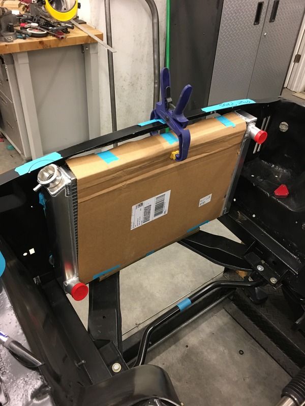

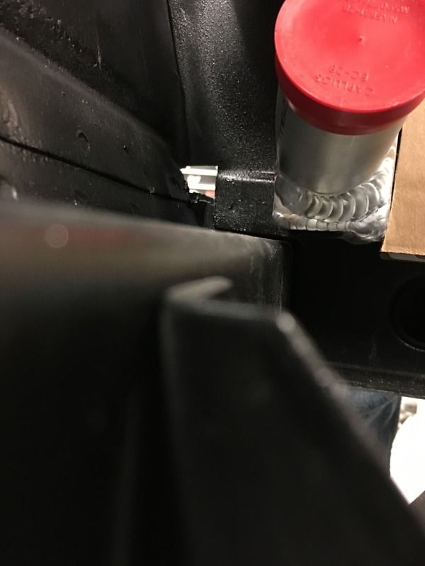

Started on the 24" radiator mod
Going to cut some cardboard to protect the fins before I position it in the opening to see if I need to trim a bit more.

Do you plan to completely strip the car back apart before paint?
AL Adkins
Stoneville NC.
raceral is offline
post #117 of 216 (permalink) Old 01-26-2017, 06:43 PM Thread Starter
FFCobra Captain
Dan Babb's Avatar
Location: Chapel Hill, NC
Posts: 11,663
Yes....I'll talk to Jeff to see how far down to a shell he wants it.
I can pull it apart and leave the suspension in or take it down to a shell and put it on the body cart I have. Probably better to take it 100% apart because the body cart is pretty easy to roll around.

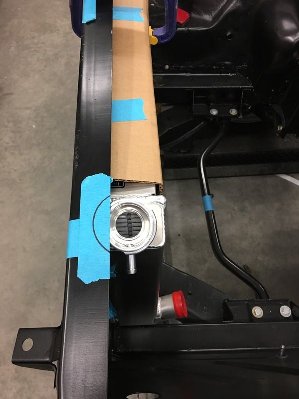

Still working on the radiator modification. Found a radiator that looks like it will work.
This is a BeCool 16x24" core 2 row radiator.
I'll have to clearance the lip of the core support just a bit. I might space the radiator back just a bit and move it up so I don't have to cut away as much...not 100% sure yet. Going to mess around with some ideas this weekend before I get brackets welded to the radiator.
With it at the current height, it just sits above the frame rails...so all good there.
