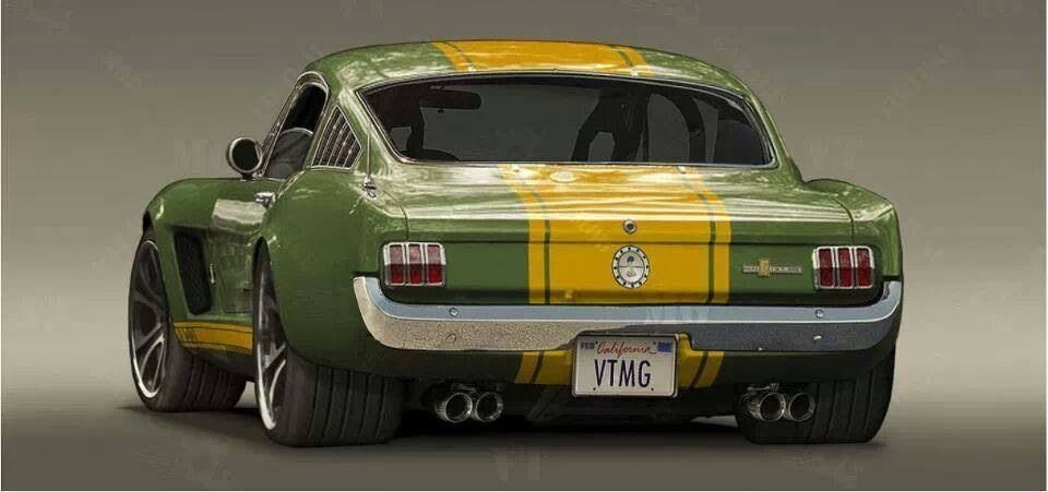

It comes with a CO, Louisiana is pretty easy, they just want to know where the parts came from and if the state taxes were paid. They will then charge me tax on the stuff I didn't pay tax on. Plates are about $6.00 a year. It also needs a safety inspection and a State Police inspection, I think they are just looking for stolen parts. There is no smog check in my area, so none of the heartburn that California put me through with the FFR. I'm not sure if it will be titled as a Mustang, or it could be a Dynacorn. It's anybody's guess.
It's going to be a restomod with a few trick changes. I never have liked the Elenore style, To me they look like someone threw a JC Whitney catalog at it and all the wings, scoops and lights stuck. Don't much care for Shelbys either.

Did you say fender flares? The sex appeal draws from the 427 Cobra.

Flares???
Maier Racing front and rear flares. 14X10 wheels all around. I did this one about 1988.
