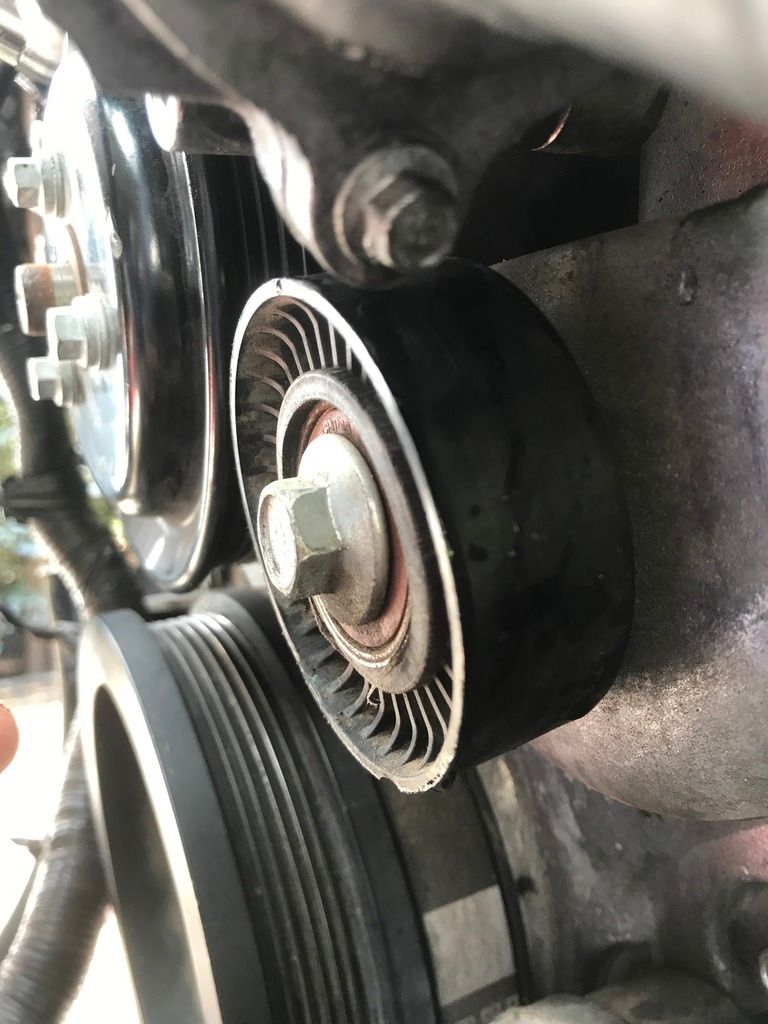

Part of of working on engine disassembly and cleaning involves removal of the water pump pulley wheel from the pump itself In doing so I notice the water pump pulley mount appears to sit further back on the shaft than it should be. I question whether this is just my perception, or something that I need to address. Reassembly of the pump pulley onto the mount confirms, the mount is pushed back further than it should be. If not corrected this will cause the belt to run out of alignment, possibly throwing it off the idler pulley. Maybe I can use a pulley puller and move the mounting wheel back out into place? After a few attempts at using a pulley puller tool to move it back out and not being able to budge it, I give up on that idea.
Then, after looking at the inside of the pulley and the body of the water pump, I observe the pump may have a leak, as some evidence of coolant leaking is on the water pump and on the inside of the pulley. That made my mind up; time to order a new pump. Tascaparts.com is a good place for new OEM Ford parts, and a new water pump is about $130. Not too bad, and after ordering a new pump and comparison with the old one my decision is confirmed. The pulley lines up exactly and the difference in where the mount sits is obvious. You can see the difference in the pictures.
