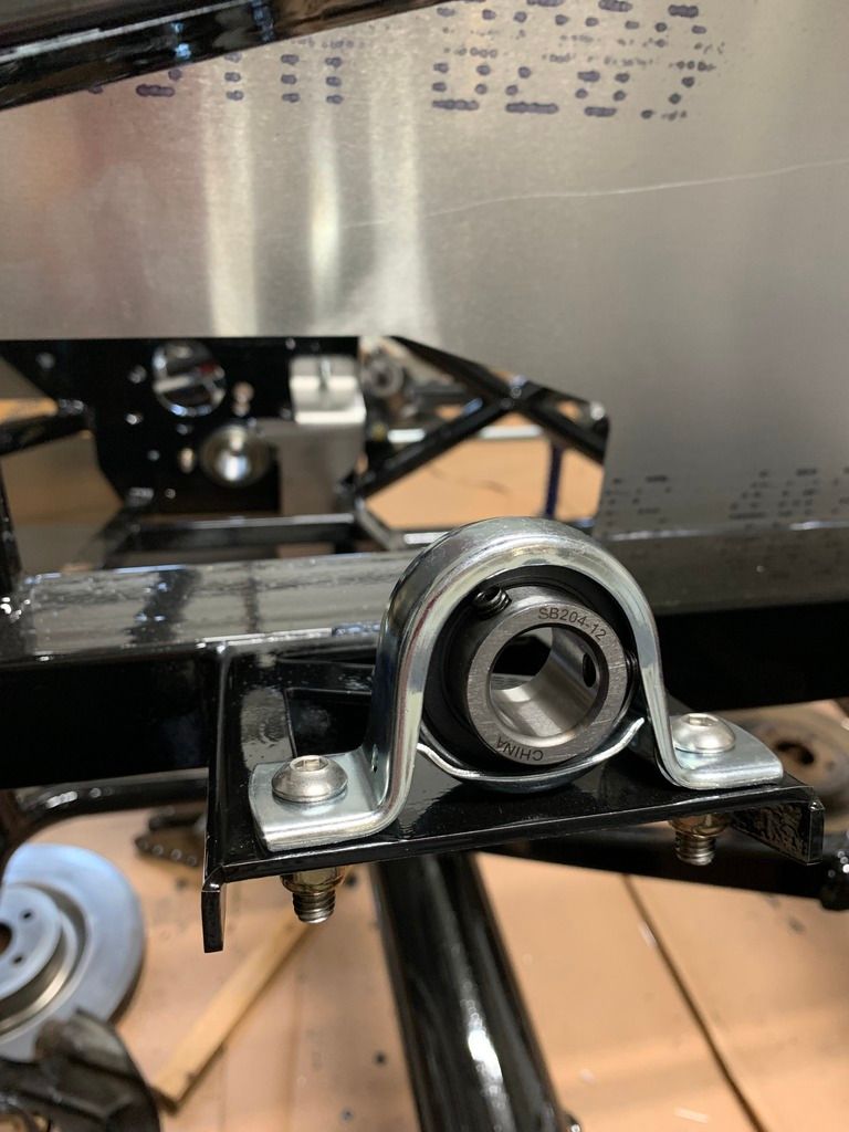

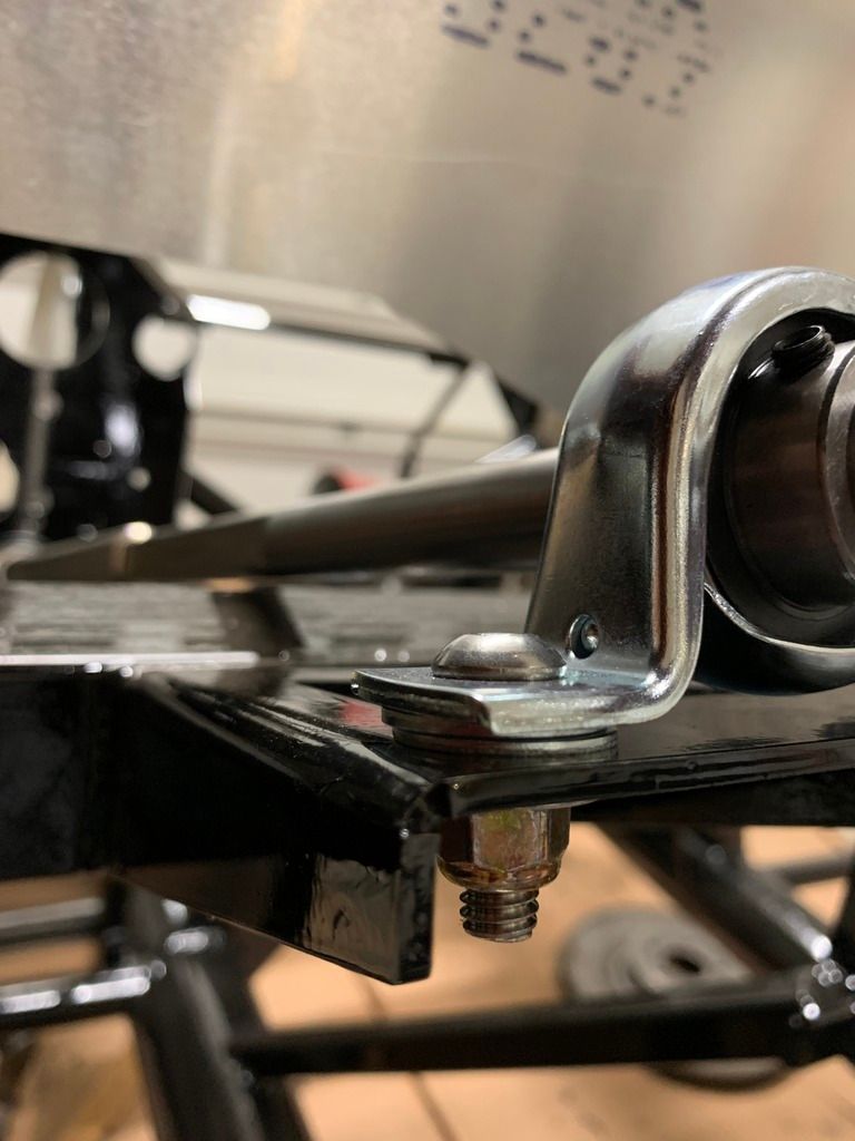

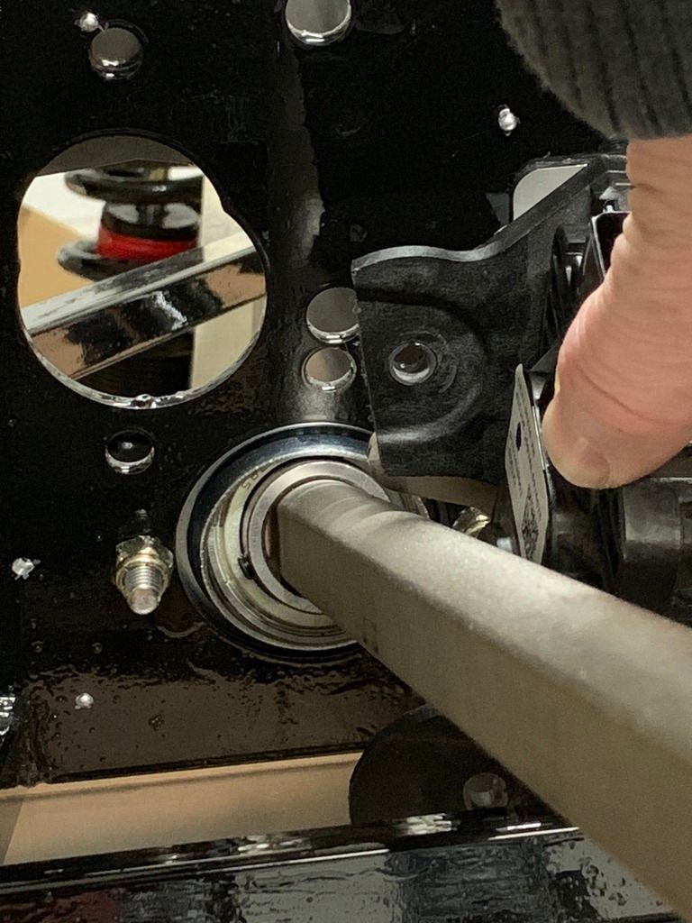

What pedal box are planning to use? Don't see that mentioned anywhere. Just so you know, that footbox front is for a Mustang donor pedal box. Meaning a second hole by the steering column for the master cylinder, plus the inner location of the clutch quadrant. If you're planning to use a Wilwood pedal box, there's a different footbox front for that and probably doesn't come with a base kit.
Two suggestions: You'll probably need to put a couple washers under that upper pillow block. Guys are finding that setup (it's relatively new) causes the steering shaft to interfere with the frame. Looks like yours does or is really close. And while you're at it, turn the bearing around so the set screws are on the back. That's per the manual.
Hopefully you also installed the two Belleville spring washers when assembling the upper and lower steering shaft. Guys often miss that, and then find there's play between the upper and lower shaft.
You're making good progress.
I see your point on the Pillow block, I’ll see about rounding up a couple washers and get some elevation on that shaft away from the cross-member. I’ll also check out the spring washers you mention. It does mentioning not cinching anything up on the steering until everything is dialed in on the steering rack, and leaving it loose until engine install sounds smart as well.
I have the Donor pedal box, that’s what I was planning on using.
On the Pillow block, I do have the set screws toward the rear of the car, which I thought was according to the manual ... Was this what you were referring to?

If by that you mean from the 2015 you're going to find that the chassis is not designed to use it.
Oops, my bad. Sorry about that. It's a lazy Sunday plus I haven't stayed at a Holiday Inn for a long time. My brain was remembering doing that installation with the Russ Thompson turn signal assembly. In that case, you do put the set screws on the other side. Toward the front. In reality, it doesn't make a lot of difference. Just so you can reach them however your car is optioned.

Picked up 4 washers this afternoon and installed the in between the pillow block and the block mount. They spaced the steering column up about 1/8th of an inch. Thanks for the suggestion, Edward. Wouldn’t want the steering column binding up or have some noisy or damaging grinding on the frame crossmember.

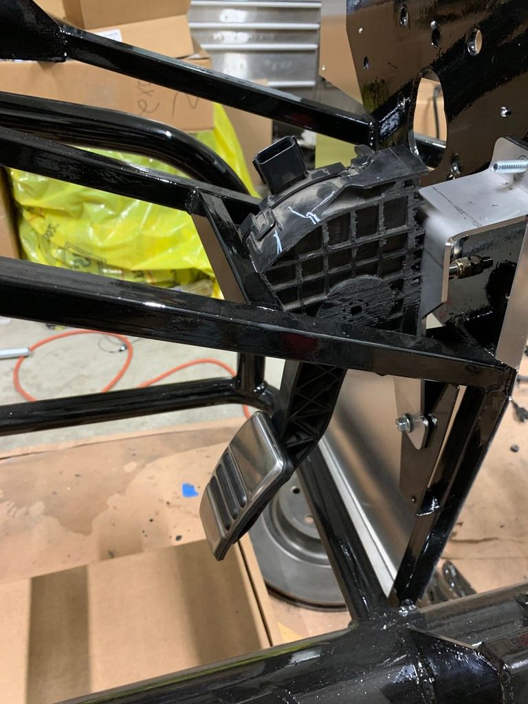

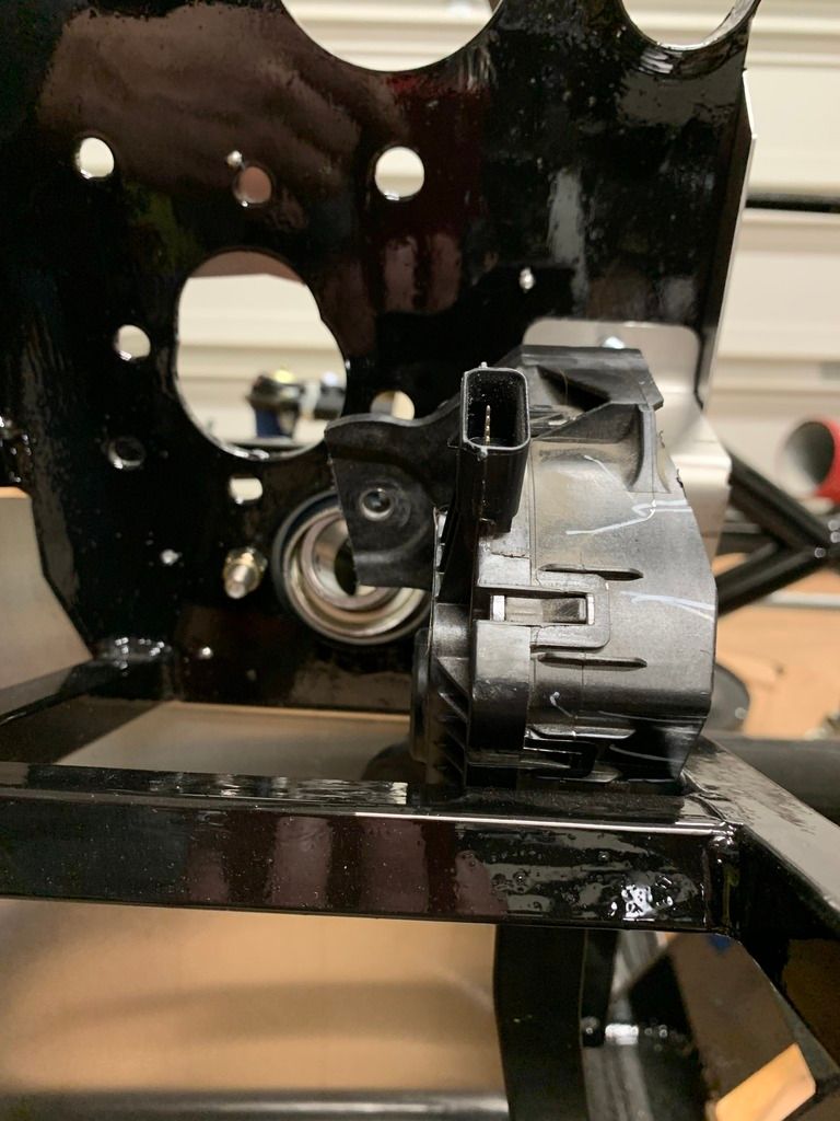

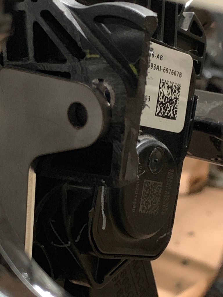

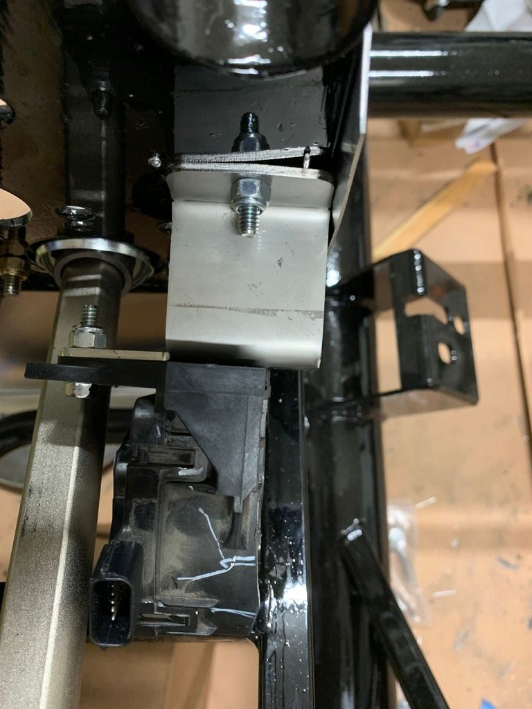

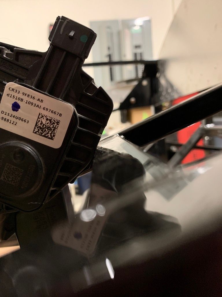

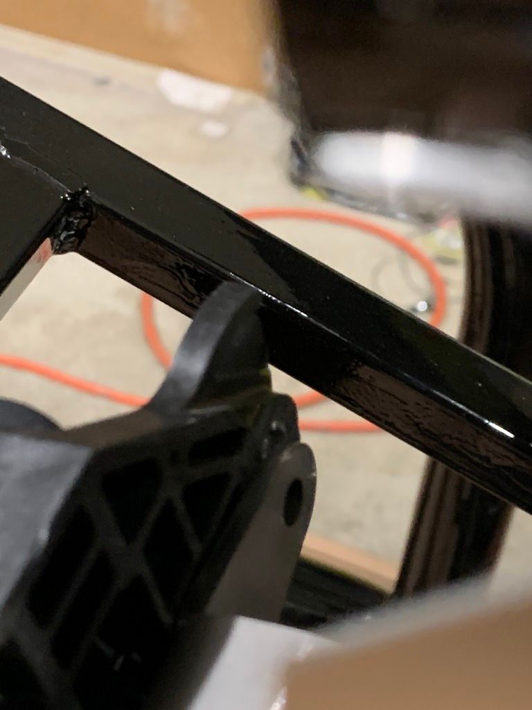

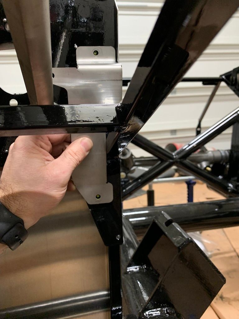

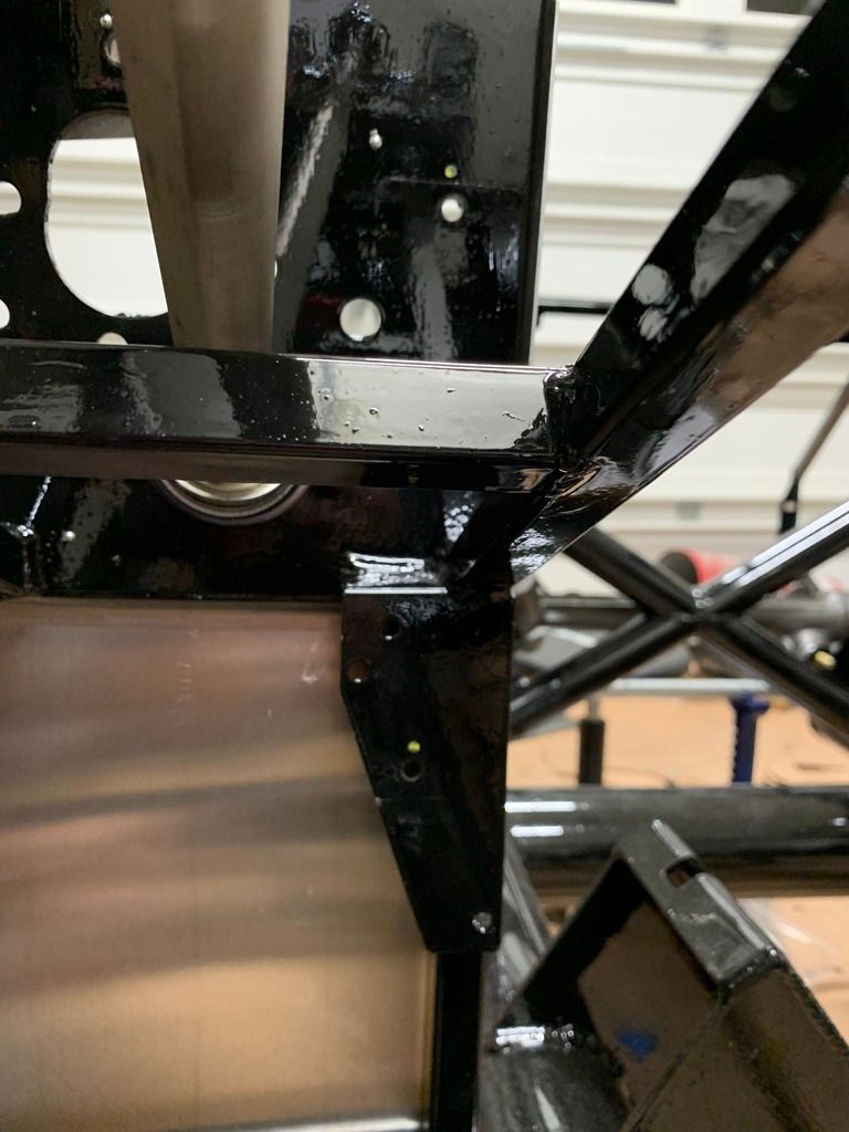

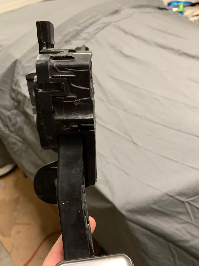

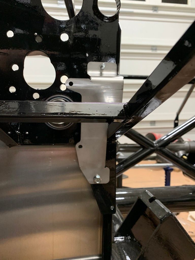

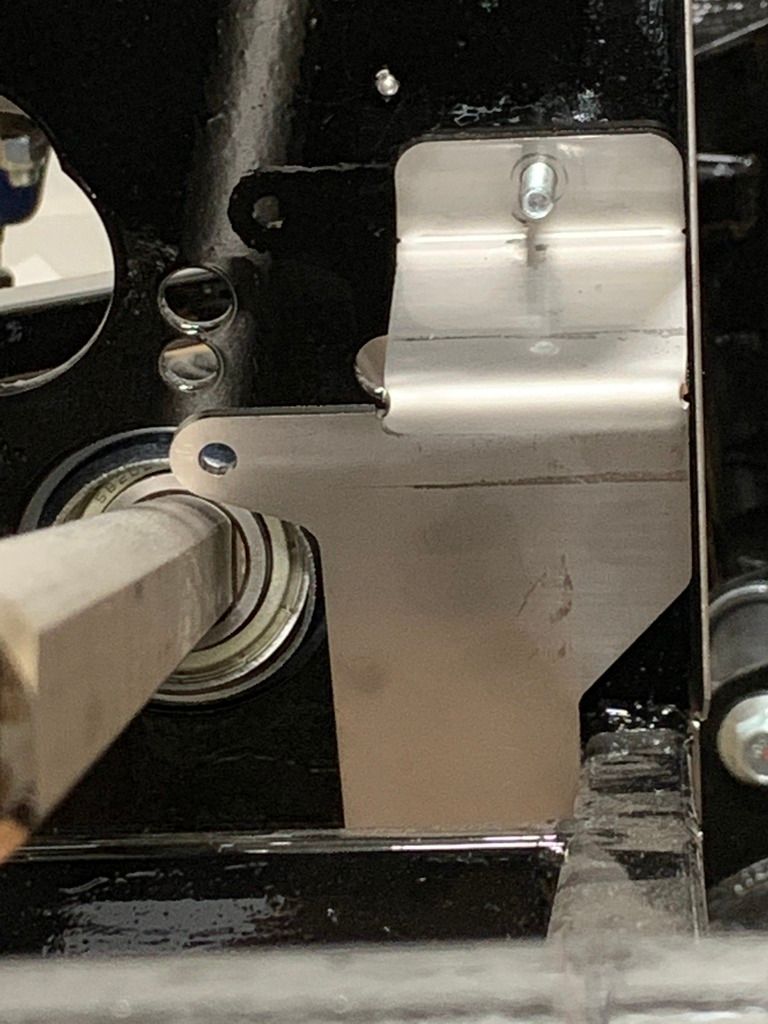

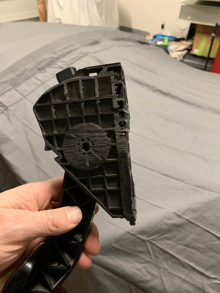

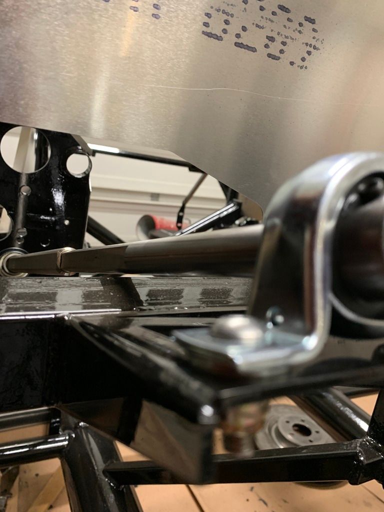

Well, I’m running into a serious fitment issue in the accelerator pedal, and add to that, interference with the steering column.
To start, I mounted the Coyote accelerator pedal mount as the manual prescribes, and it went in just fine. And I trimmed the pedal as the manual prescribes. However, when I go to slide the pedal into place, the pedal body contacts one of the frame members before it can slide down the final 1/8” of the way, and the frame member that parallels the steering column keeps the top mounting hole from lining up with the top mount hole. It needs to move about 3/8” over toward the PS, but it contacts the frame member before it can get over there. I’m at a loss as to how to solve this while not removing frame members and maintaining the integrity of the pedal mechanism.
On top of that, when I insert the steering column, the mounting ear of the accelerator pedal interferes with the steering column. It almost contacts the mounting adaptor. Judging by how it lines up with the mounting adaptor, I don’t think I can cut enough of of the ear of the accelerator and still maintain my confidence in the accelerator ear.
So, in short, there are 3 issues. The frame member toward the rear of the car interferes with the pedal moving down the last 1/8”. The Frame member to the Passenger Side interferes with the pedal moving to the right far enough to line up with the upper mounting hole. And the steering column interferes with the pedal mounting ear.
What a cluster .......
The last picture is from the exact view of the steering column end, you can see how the mounting ear interferes with the steering column. Should I move the pedal mount upward by drilling new holes slightly higher? Or am I asking for trouble? I am assuming that the pre-drilled holes are best.
I could be drastically overthinking this.

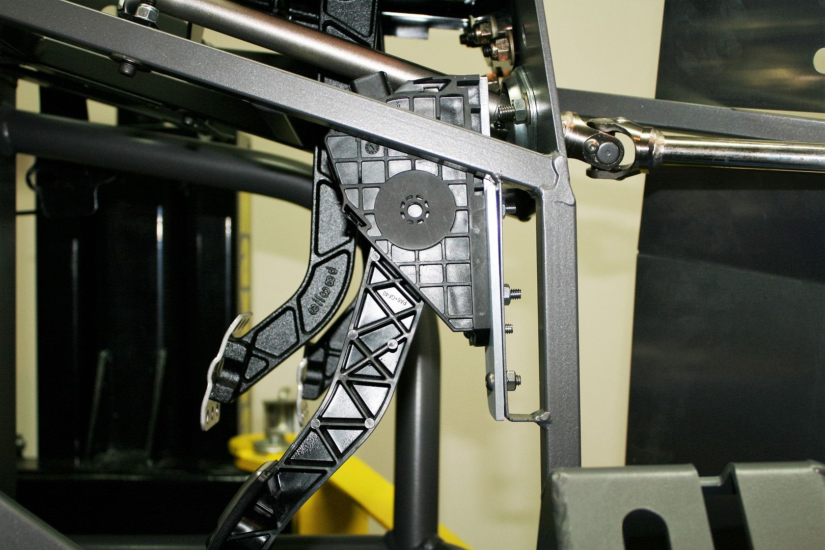

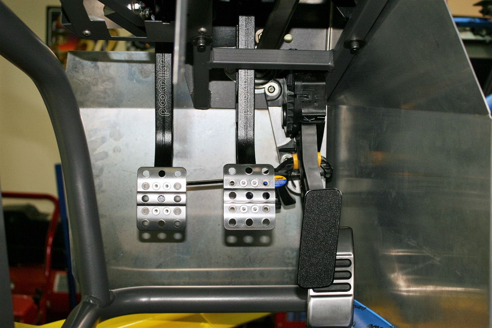

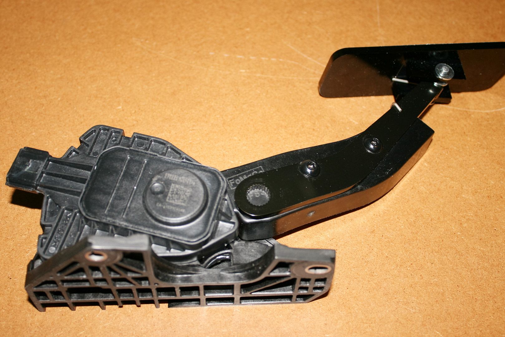

Nice looking bracket they're providing now. Nothing like that was available when I was doing mine. But obviously not too great if you can't get it to fit. It's hard to be very specific with any recommendations though. I've had to massage both of my Coyote accelerator pedal installations quite a bit to make them fit. Observations though: You can take more material off the back of the module assembly than you did. As long as you don't go any deeper than the flat part. Those webs can be removed more. Maybe not everywhere, but in the area where it's contacting frame members. I did that on my Roadster to get it over far enough. You can also take a little more material off that mounting ear. Don't compromise the strength by removing any material between the mounting hole and the case. But the outline on the other side of the mount could be cut down more and maybe eliminate some interference. Finally, if you do need to move some holes in that bracket and/or trim it down a bit, won't be the first (or last) time that's necessary in your build.
These are pictures of my installation on my Roadster build. I understand it's different because I don't have that bracket. But maybe it helps a little.

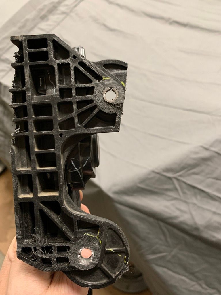

I think tonight I’ll try to see if moving the mounting bracket up by about 1/2” and drilling new mounting holes will resolve the issue. I just don’t want to have that cause a domino effect with other foot box items or a drive ability issue with the finished product. (I.e. gas pedal too high)

I relocated the accelerator pedal mount about a half-inch higher, and that seemed to resolve the issues. However, the pedal still is butted right up against the frame member directly on the PS of the pedal, and in order to make the back of the pedal seat firmly against the mount, I had to shim the right side of the mount out from the back of the foot box a hair. I used a leftover pin from a rivet, but I may want something a little more permanent for the long-term.
Photobucket is being a pain in the butt right now, so I can’t upload all the pictures.

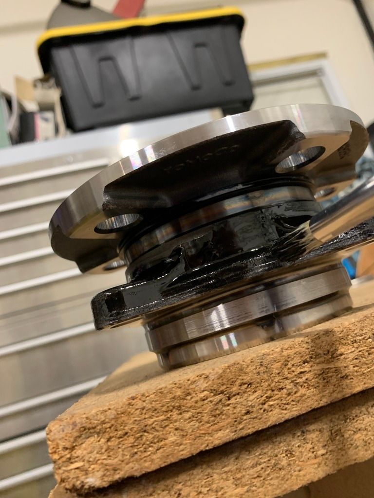

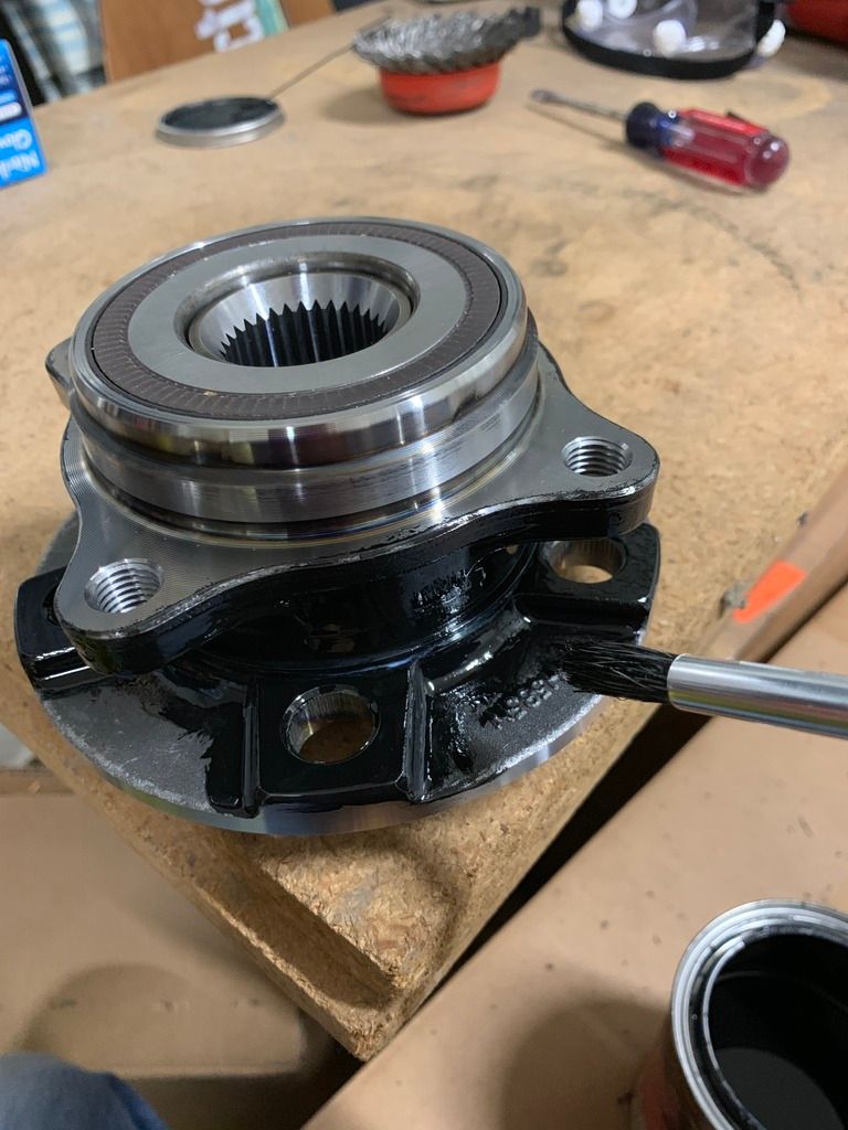

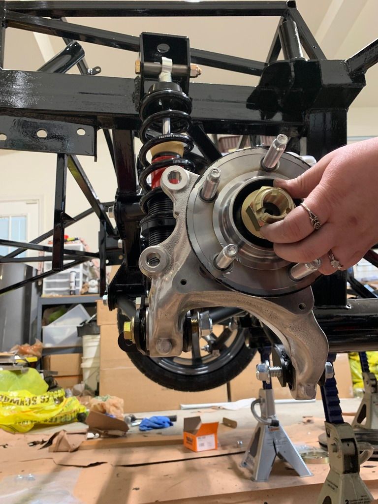

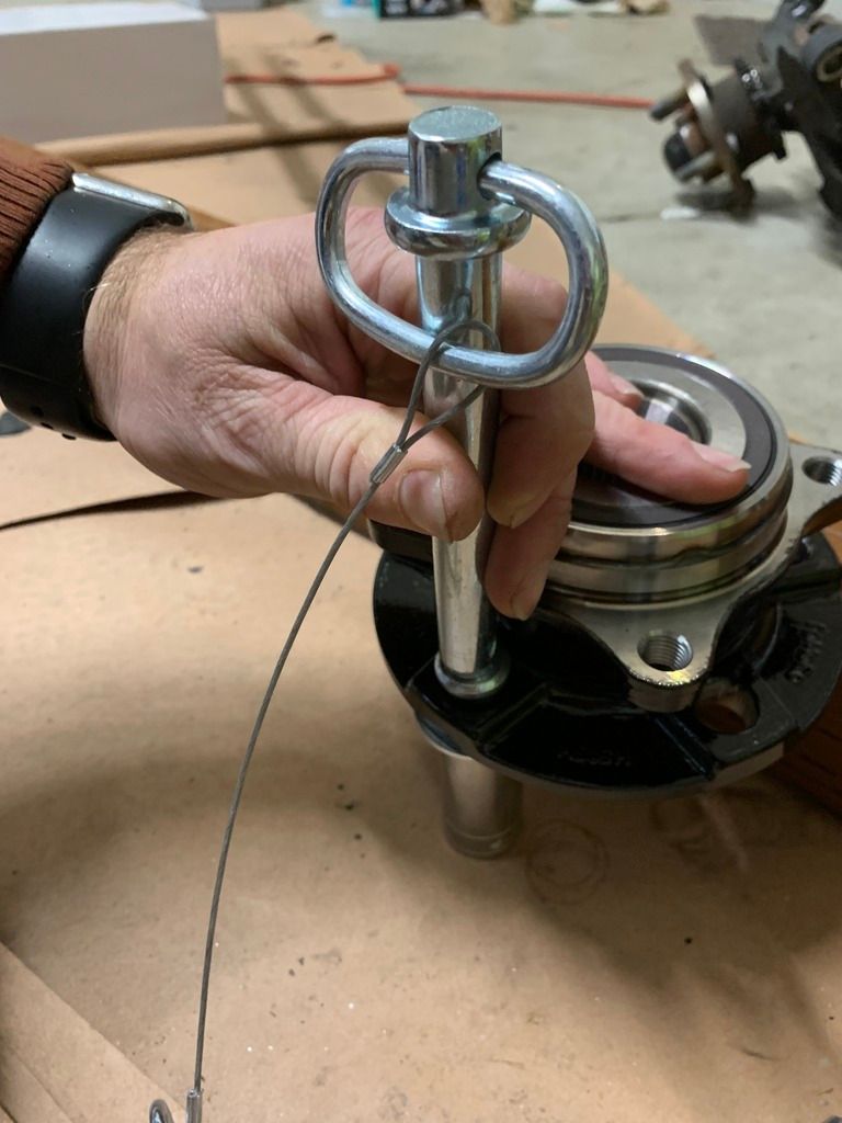

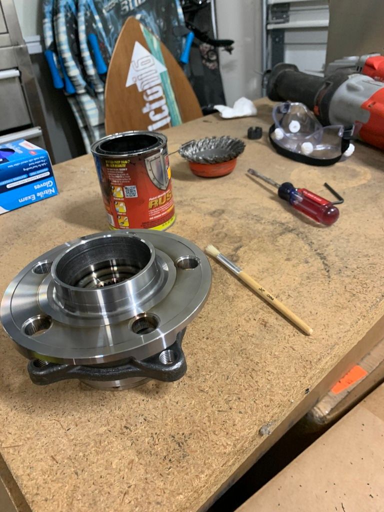

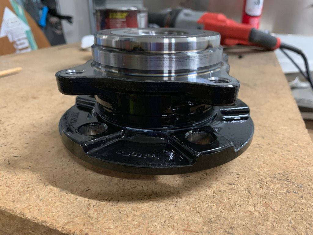

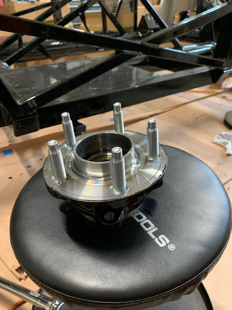

After receipt of the hubs I got right to work on knocking the wheel studs out with a 2 lb sledge and hitting them with POR15 on the exposed areas..... following in the footsteps of the greats before me. The directions say 2 thin coats, and these 2 coats are a little closer together than I’d like; 2 hours, but I think it’ll be ok. I want to get working on the IRS tomorrow morning and not have to wait for another coat to dry.

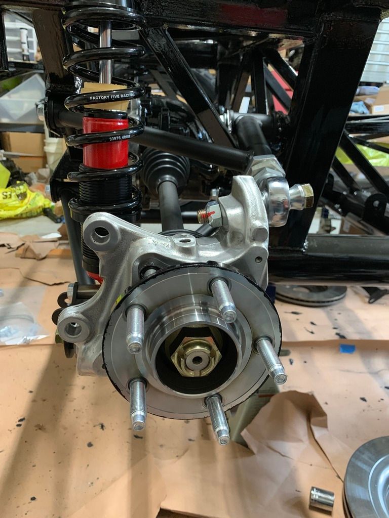

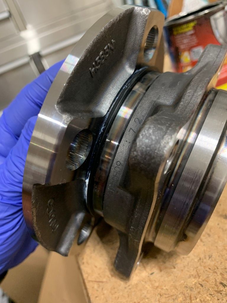

Installing the Wheel Studs proves to be a challenge, and here is one spot where I believe I actually have something to contribute. The instructions to ‘draw the studs into the holes using a washer and a nut’ prove to be worthless as the stud nut starts to bite into the tapered shaft of the wheel stud before it even starts to cinch the stud into the hub. Other senior builders have used a deep well socket in a vise to hold the stud and brace the hub, which is good, but even a long bolt with the threads filed off will damage the side of the hub as you pound on the back of the studs. So I went looking for a smooth-sided tool to help me pound these in while picking up another grease tube. So this is my solution. It’s a Clevis Pin, similar to a hitch pin for a trailer hitch, but straight. It costs about $4.78, and is ready to use right out of the package. I do end up using the socket with a couple washers to back the hub, and it worked very well as a thick punch tool. I think It will only last for one set of 4 wheel hubs, though. It deformed past being able to use it for its original purpose.

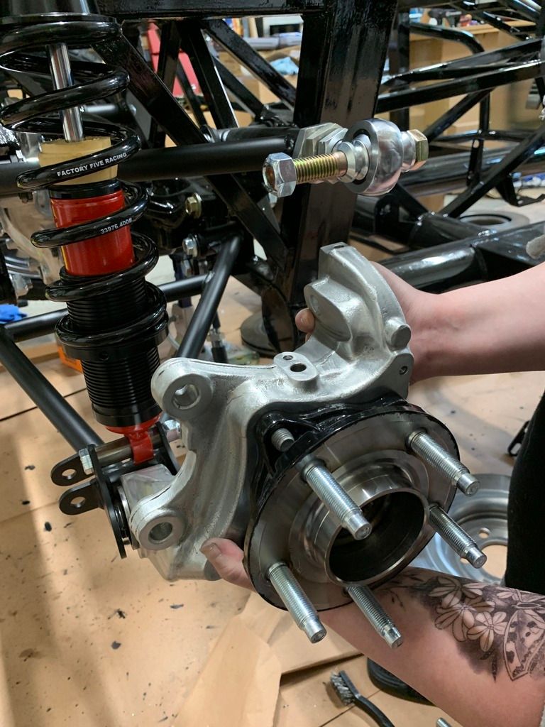

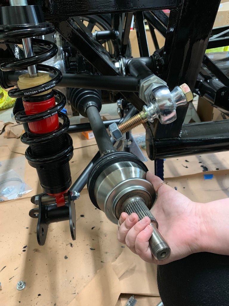

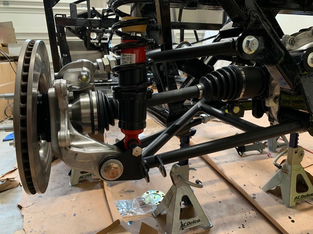

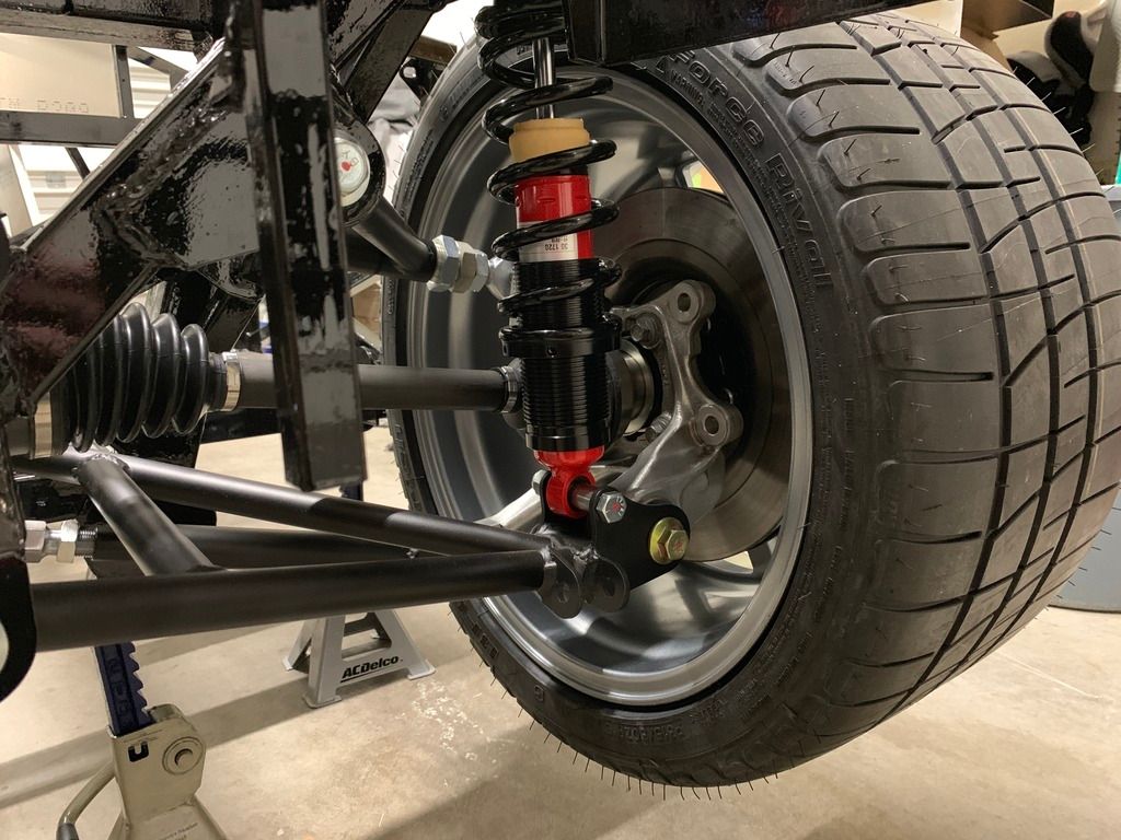

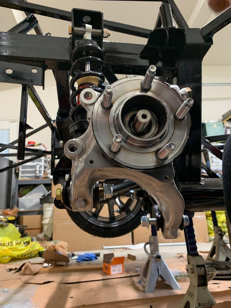

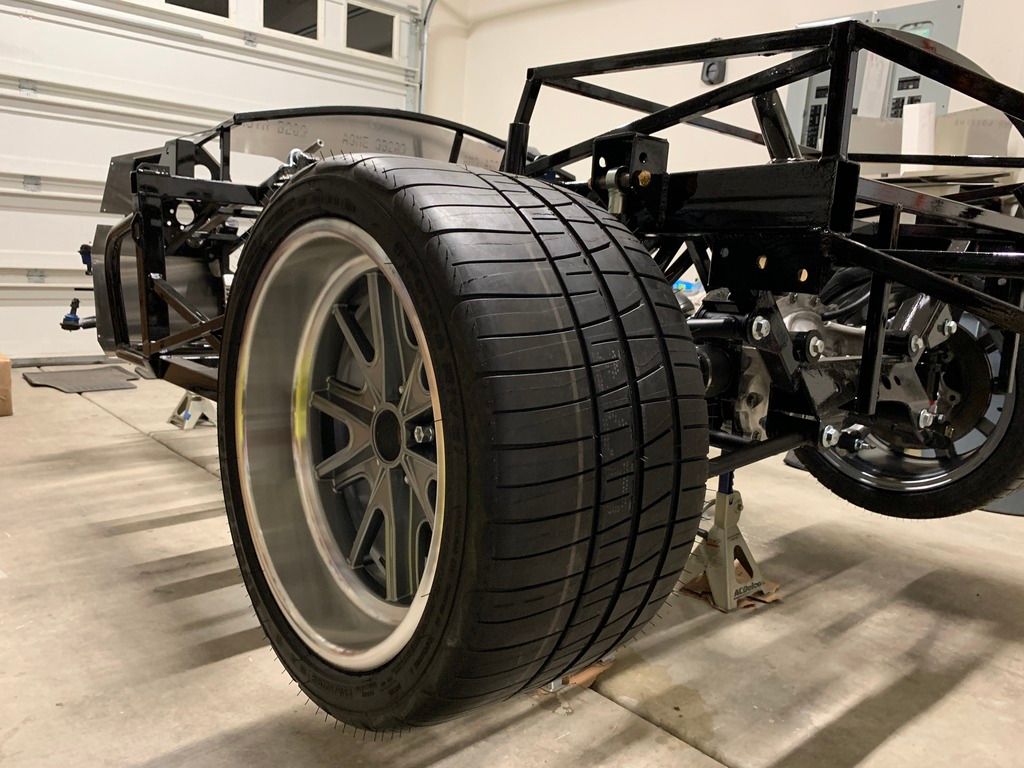

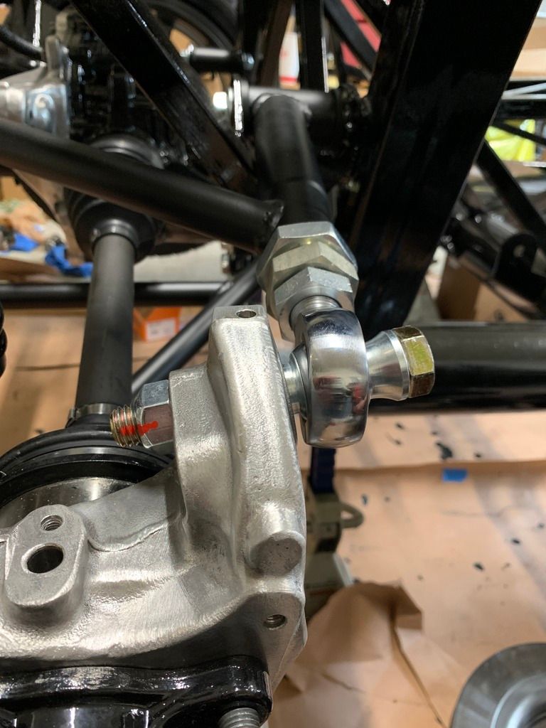

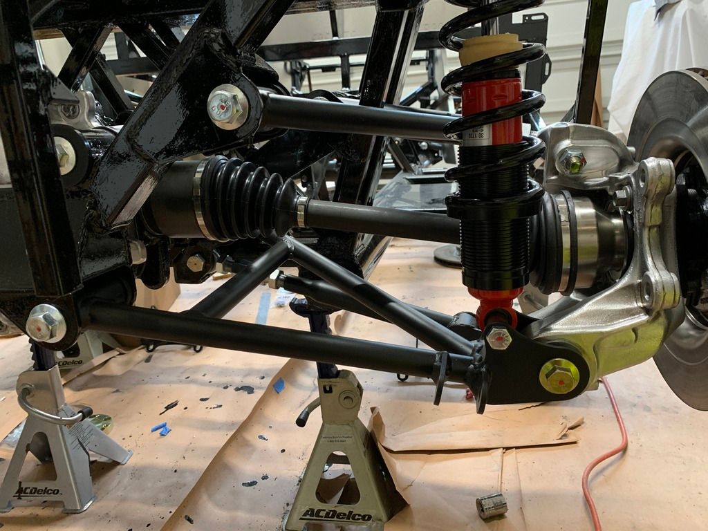

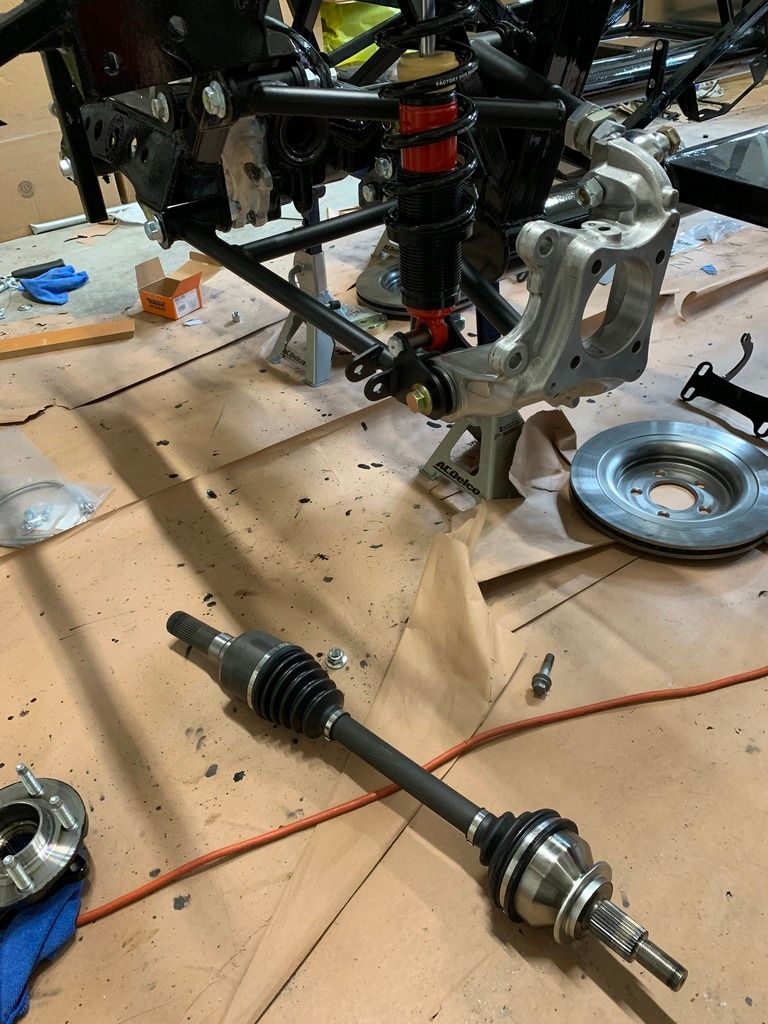

We completed the IRS installation today, and man is it sweet.
We already had the Control Arm and Toe Arm-to-body bolts torqued in and the hubs mocked up in place, so we took the hubs loose and unboxed the Half-shafts. They are beefy and come wrapped in plastic with the Axle Nut threaded onto the end of the Axle. To set the Axle we lined up the times by inserting and turning until it slides in, and then as it neared full insertion we could feel the shaft click into place. However, both sides required a few firm taps with the rubber mallet in order to get them seated. They should be about 1/8” from the flares shaft edge to the Differential housing, and they went in hand-tight at about 3/8” out. Nothing a little hammer love couldn’t solve.
The knuckle with mounted hub went on smoothly and thanks to my work with the spreader tool, the Control Arm Mounts came together just fine, the bolts slid through with a few mallet taps, and we hand-tightened the nuts. All three bolts in place, we torqued them to spec. Marking them with the paint pen will indicate any future prospective loosening of the nuts, although that will be unlikely.
All in all, smooth installation of the rear of the IRS parts.

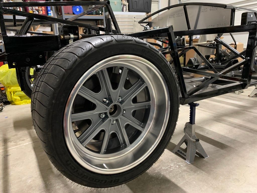

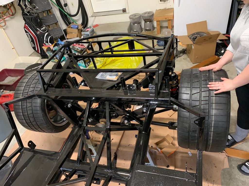

Man am I itching to get those wheels on. I couldn’t help myself, I slid the brake discs on and put the wheels in place with a couple hand-tight lug nuts. Those tires sure are meaty. I’m loving everything about this car so far.
Cleaned out the work area a bit too, you can see in the last photo.

Following recommendations from Senior Members, I placed an order for F5 front Spindles. Contrary to what their website says, they were in stock, and will ship today. I also had to order the Power Steering rack adaptor for the steering shaft and the aluminum radiator. Looking forward to receiving those and getting the car to ‘Roller’ status.
Also ordered a Fuel Kit and a few other items from Breeze, and a Cleco set from Amazon. I see lots of sheet metal work in my future. I’ll also be looking to pick up some basic alignment tools once I get all 4 wheels on.
