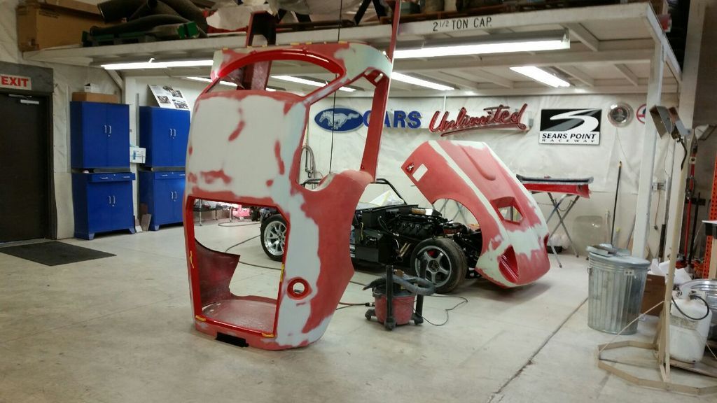

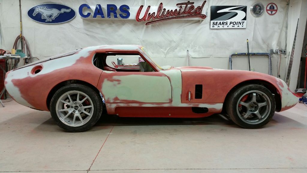

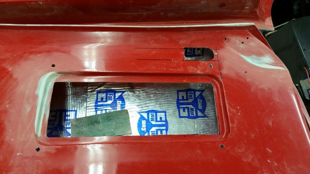

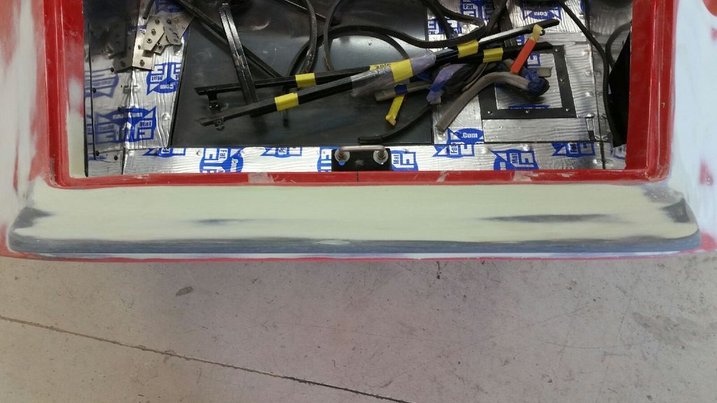

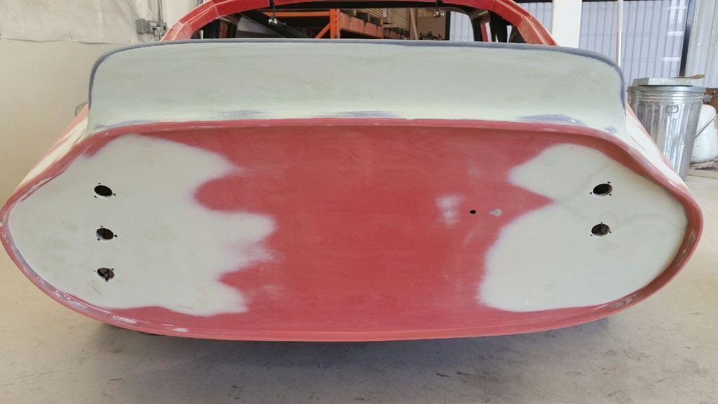

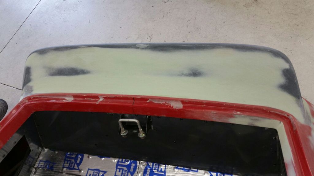

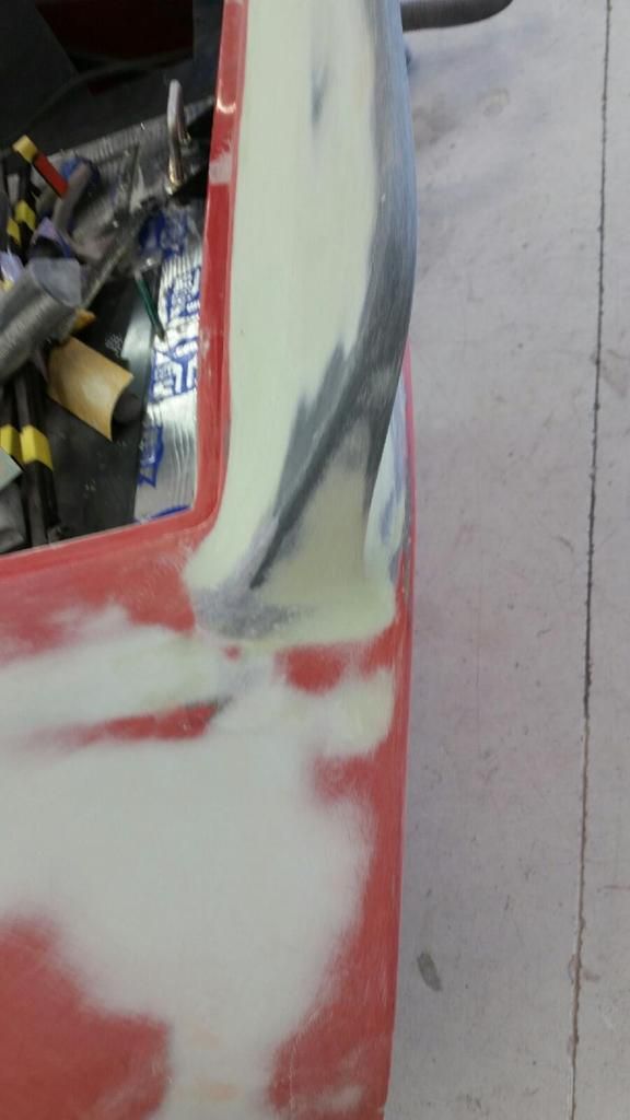

Progress!!!
Got a few pics from Gary and I am very happy with the progress!!
I am also happy to report he fixed my major two mess ups on the drivers door.. The door solenoid got in the way of the door and where I cut a hole before i ended up grinding down the door frame. For the now famous SeattleDad mod
The rest of the pics I got were minor things he had been fixing for me like the passenger wiper bump.

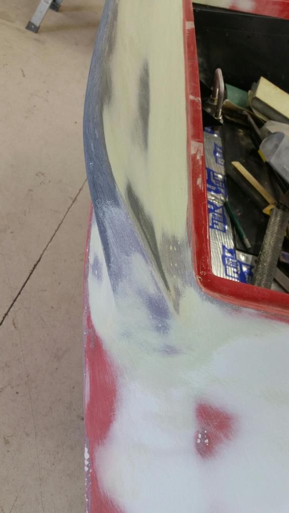

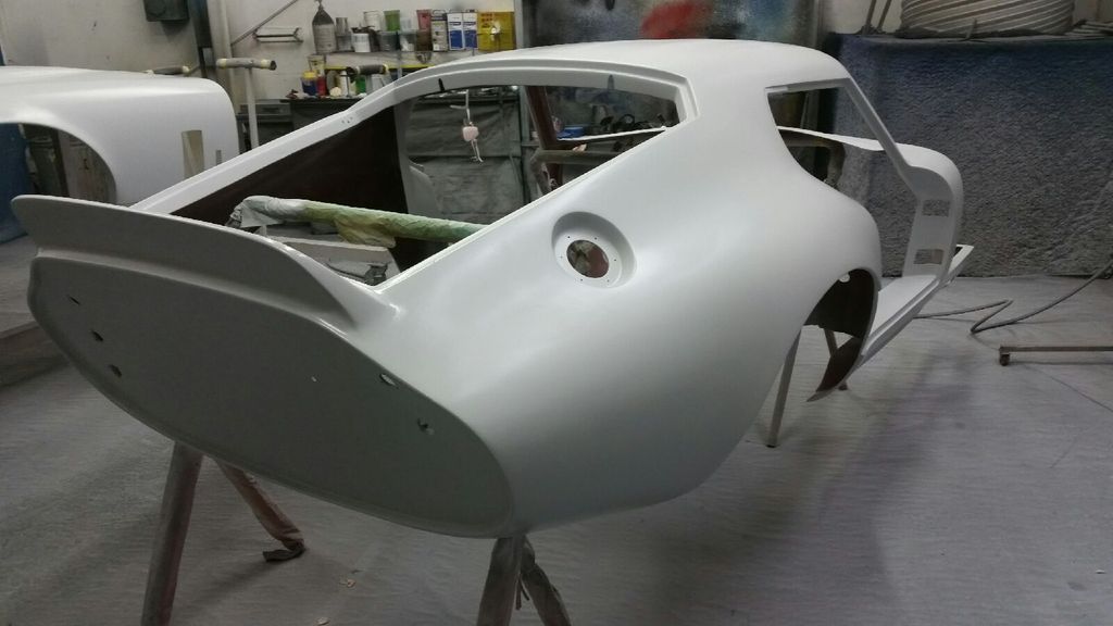

Kind of a repeat from my build thread but this thread is good for people searching for painters IMO.
The windshield issues were solved by screwing down the bottom of the windshield opening to the center frame/firewall post underneath. The Gen2 coupes only have a small tab in the middle Vs. a bar running across the whole bottom of the window opening/top of the firewall. It all fits very well now.
Gary finished the spoiler (which I really wanted glassed in) and primer started going on!! Super exciting day!!! It all looks awesome.
I could not be happier with Gary's work, his speed, and his communication. He has had it one month and estimates a March 26th completion. 2 months total!! All very good things.

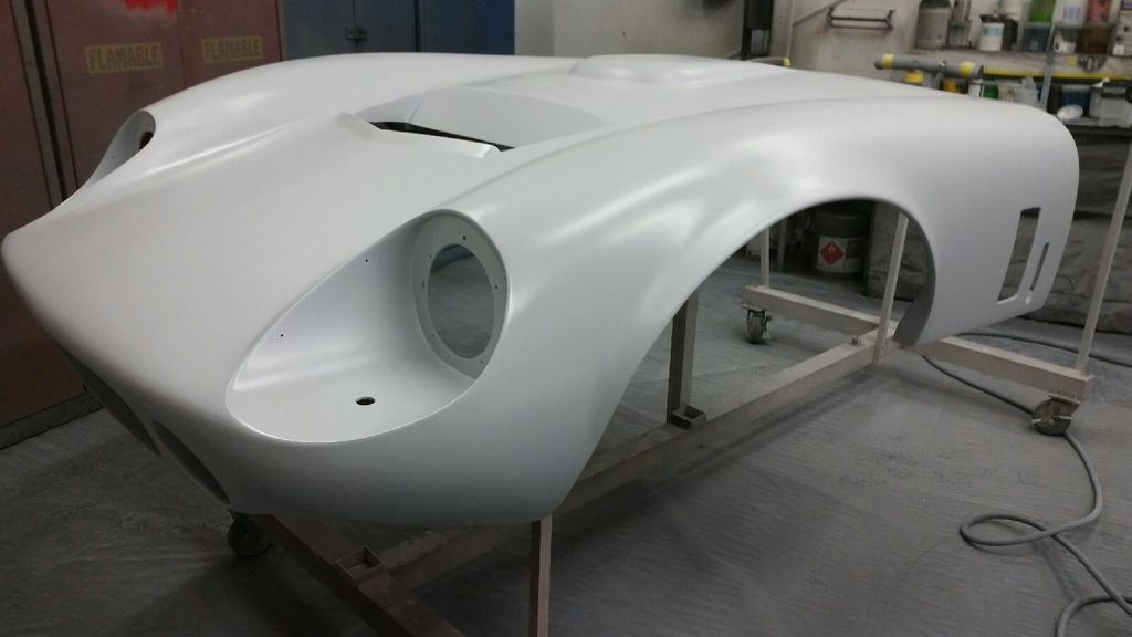

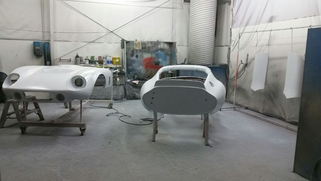

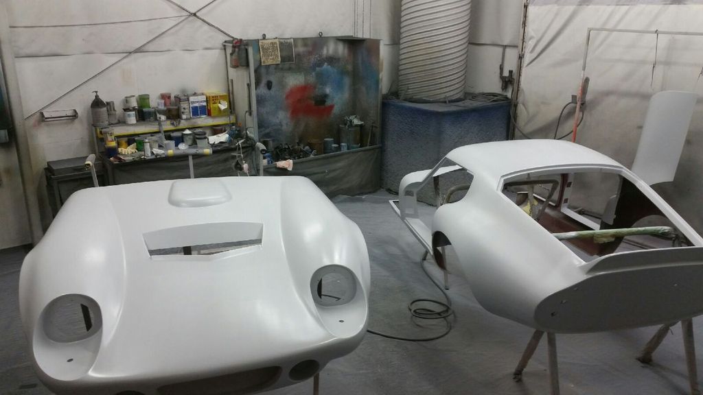

More primer..
Not much of anything different than the last photos but thought I would share.
Working that primer
