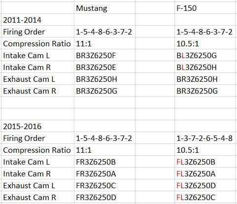

Since there's been a lot of bits and pieces of information, I decided to go and compile what I can find. *It does look like Ford changed the firing order on the F-150 Coyote only for the 2015+ model year back to the old modular V8 firing order*
To help anyone in the future, I may create a separate thread in the Coyote forum or guide of what parts are common or what changed between models and years since this has been an issue to track down.
Pulled from Ford's owner manuals:
Here are the camshaft part numbers for the Mustang GT and F-150 for the various model years:
This is why Ford says the control pack does not work with the 2015+ F-150 engine without modification.
