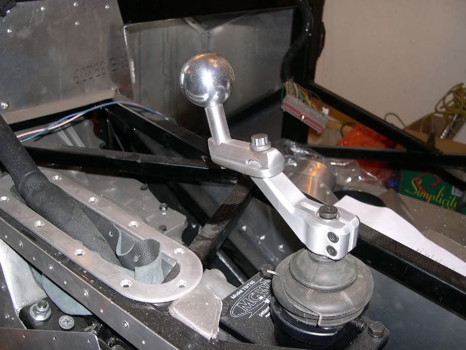

However, there is no mid-shift location on the T-5 case, and after determining driver's seat location, the shifter handle was too far back for quick and comfortable shifting. Here's a pic with the MGW handle, turned forward. Its billet aluminum, and looks great but too far back.
I've seen, as I'm sure you have, all kinds of approaches to solving that problem, most of them ugly, involving linkages, etc. None of those were very appealing.
Unlike a stock T-5, Pro 5.0, Steeda, UPR, etc. shifter, which attach the handle to the shifter with two bolts and nuts on a flat bar, the MGW uses a pinch bolt on a round shaft.
Enter my talented colleague Fast Freddie, who came up with the best and most elegant solution I have yet seen to the problem of using T-5s in an FFR. Working with a fellow autocrosser who has a parts design shop, he came up with this extended billet shift handle:
There was a minimum quantity on the order, so he had to get several. He polished one, and had powdercoated a couple of others, one in satin black, and the other in the charcoal finish we are using for the main elements of the dash.
I like the Dash color best, and that's the one we're using. The location is now perfect -- close to the plane of the wheel for quick shifts.
They came out great, and express the design imperative of No. 410 -- function first, and functional is beautiful. There are a few left over, so let me know if anyone wants one.

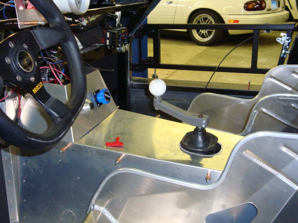

Thanks everyone. Here's one of it in place. Nice and clean.
