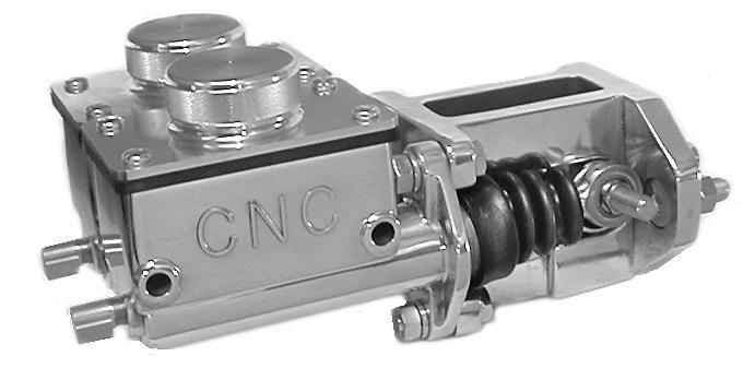

I'm installing my break system. It's a CNC duel master cylinder system. For some reason, there is no flair accepting nipple on the end of the master cylinders.
There MUST BE some type of adapter.
Any insights?

Mine have brass adapters 1/8 pipe (guessing) to female brake line flare. looks like this
https://www.ebay.com/i/263370186193?...BoC96cQAvD_BwE
I don't know about the 1/2-20 spec. Whatever the standard size is on 3/16 brake lines.

Call Mike at Forte's Parts Connection. I had this setup on my car years ago and can't remember exactly... but I think there was an adapter and they called for red loctite on it. I think it was a 90 degree adapter. I bought the setup from Mike and he probably recalls what's needed and probably can sell you the fittings you need. Or, if you take the cylinder down to Napa and fiddle thru their fittings you'll find what you need.
Update... see picture here:
Barry Gerard thanked this.

THIS is the answer. THANKS!

It might be worth checking the red loctite thing. I think it needed it because you want to orient those fittings a certain way and you also don't want to crank them down too much into the aluminum case as it could crack.
