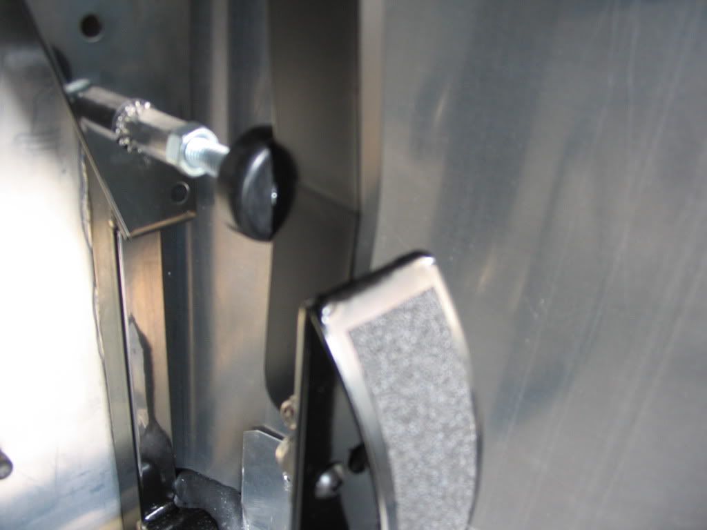

Mechanical Linkage
It wont help you in the short term but I would seriously consider going to mechanical linkage.
Russ Thompson Pedal Assembly
FFR Throttle Pedal at the MK3 Roadster Shop of RT's Custom Cobra Car Parts
Mike Fortes Mechanical Linkage Kit
Mechanical Throttle Linkage Kit | Fortes Part's Connection
I made my own setup and i love how positive the response is. It also helps set up how aggressive you want your pedal to throttle response to be. I set mine up for more pedal travel which completely does away with the ON/OFF feel of a cable setup. I have a Ford Racing 427 and it was ridiculously (scary) jumpy until I setup the throttle.

Mechanical Linkage
Originally Posted by davekp View Post
Got a photo of your set-up?
These are the best photos I could find.
