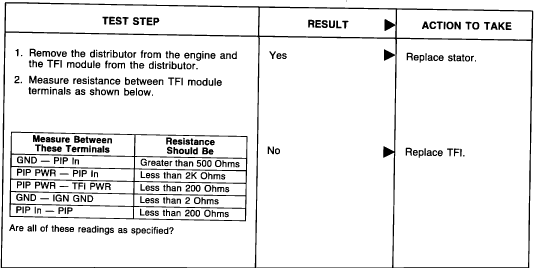

There is a way to test it but not conclusive because it doesn't take in to account the heat soak issue.
So, that being said, there is a way to [maybe] recover it if you get out there on the road and it quits on you - carry a water bottle that you have frozen over night, pour it over the TFI module and it probably will recover.
Another fact about the TFI: IF you are running the "grey" colored module, even if it won't "crank" start, you should be able to push start the car.
This method won't work with the "black" module.
There are a few solutions to this issue with the factory placed TFI module, the best is to relocate it to an off-engine place - that is what I did to mine after two episodes exactly like yours . . .

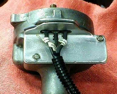

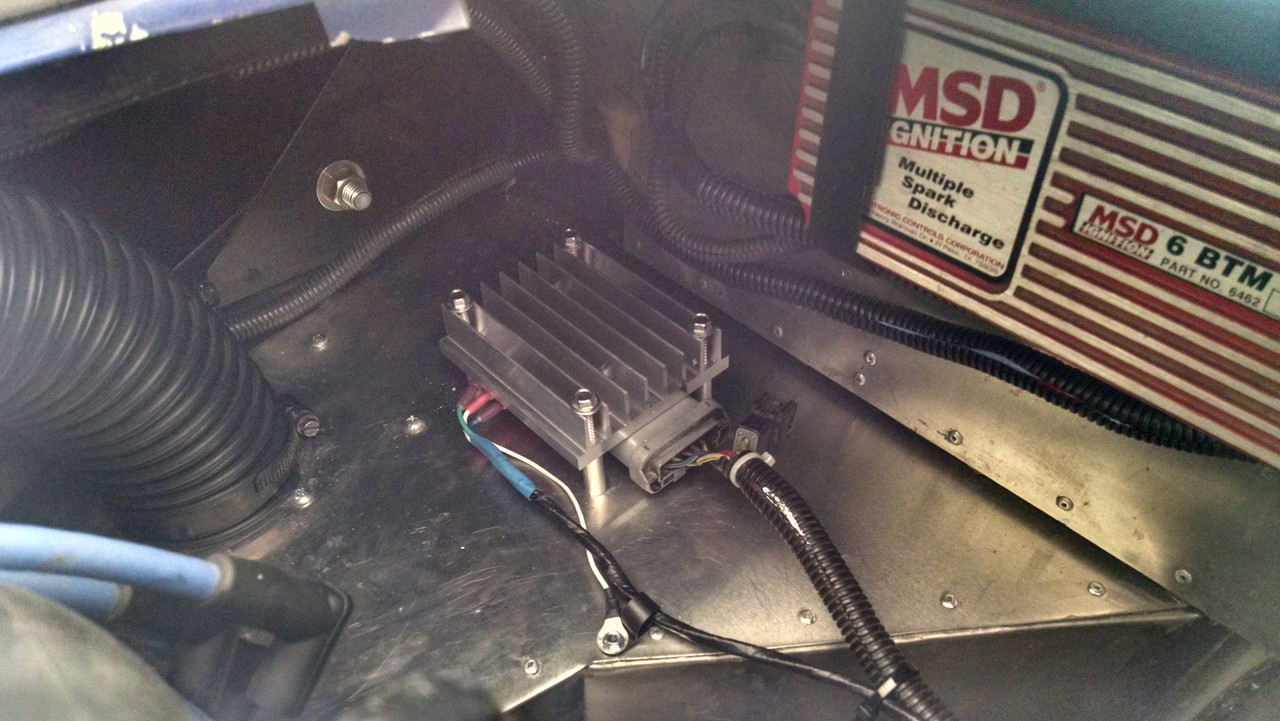

Here's mine, relocated to the PS footbox
And the block off plate to cover its old mounting location:

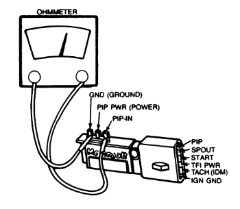

TFI Testing
IF you really want to test it . . .

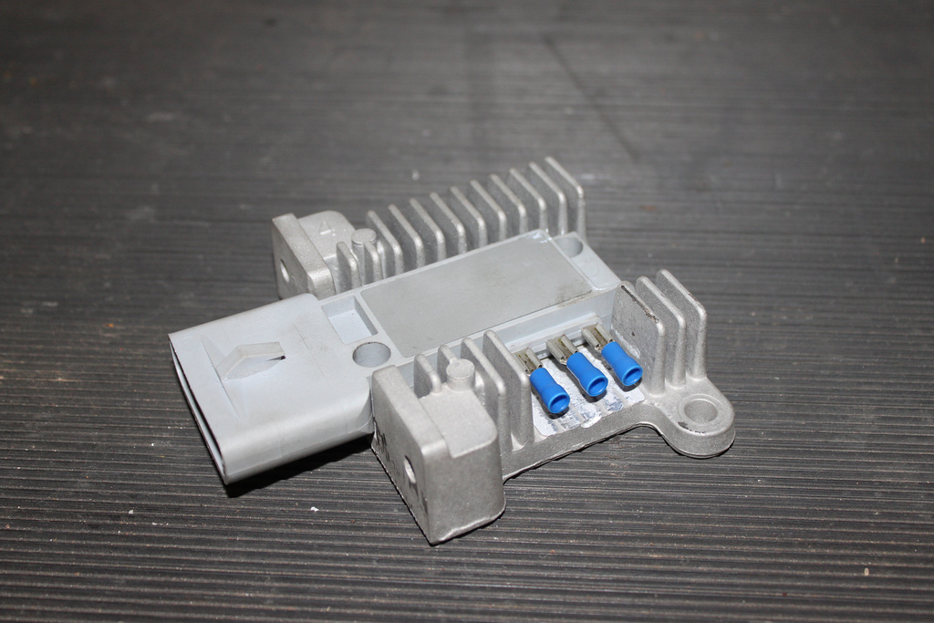

I'm using the McCully Racing relocation kit but a search for them wasn't any good. LMR has a kit. Also Summit Racing and more. Just search for TFI relocation kit.

Here's the link to the vendor mentioned (I don't believe a FFCars vendor):
McCully Racing Motors- We have exactly what your over-heated TFI Module Needs!
( - probably going to get myself in trouble for posting non-participating vendor links - )
Scour the bone yards / pick-a-part lots for the one FORD made for this issue. (Bronco's and Rangers - early 90's) don't forget to get the "extended" harness.
Built my own block-off plate from 1-1/2" aluminum 90° angle
Doc
Doc
Hi Doc: Well old module tested OK but it was cold of course. Considered putting it in the oven but I am replacing it anyway.
So your block off plate: Did you seal it to keep out water or is it just to stop wasps building nests in the dizzy?

Block off plate
Keep the Wasps out, of course . . . now that there is funny.
Didn't seal it at all, just there to keep most of the dirt out. It's been on the car a few years now with no issues. I don't tend to do a lot of driving in torrential down pours, not sayin' I haven't been caught in one but . . .
If you build one, as opposed to buying one from McCully, the hardest part is getting the hole for the leads big enough to keep the leads from shorting out against it . . . a little trial-n-error worked for me.
FWIW, once a year I do a complete nut-n-bolt session on the car and one of the things on the list is blow/clean out the dizzy PIP area.
Everything in the dizzy is hermetically sealed cuz it's an electronic part.
Also FWIW, I believe the FORD spec for failure is 254°F. If you are interested in the law suit wording,

So have replaced and relocated the TFI module. The relocation kit was a little finicky but fairly straight forward. Had to bend the spade connectors to get them to fit tightly in the distributor. Turned the key and after lots of cranking she fired up. I guess only a long drive will let me know if I have fixed the hot-no-start problem.
Obviously this does not seem to fix the cold start issue. Seems to take a lot of attempts to get her going. Fuel pump runs every time I turn the key. Is it possible it is never getting up to pressure or leaks down fuel pressure when it has been sitting?
