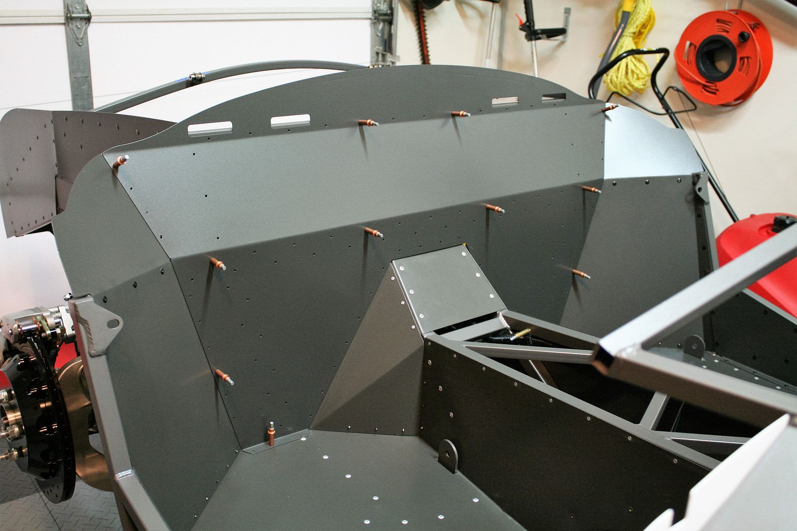

PS cockpit floor and under door panel drilled and riveted. Do you rivet any of the panel along the trans tunnel? I figured the top of the panel gets riveted together with the top trans cover but wasn't sure about the lower portion of the vertical part of the panel.
If you're not doing a removable trans tunnel cover, then the top will get riveted at the same time you install the cover. For the rest along the sides, there's a few inches that one of the diagonals is touching the panel, so I put a few rivets there. But the rest doesn't touch anything. You can see what I did in this pic. I did do a removable cover on this build, so the rivets along the top are flush rivets.
Everything looks really clean. You are using silicone or some kind of adhesive in addition to the rivets, right?

Everything looks really clean. You are using silicone or some kind of adhesive in addition to the rivets, right?[/QUOTE]
yes, silicone. I'll add some rivets to the diagonal cross members of the trans tunnel. thanks

Got drop trunk kit assembled and trunk aluminum opening trimmed. The trunk aluminum is a bit difficult to clamp due to the bend so I ended up putting some 2x4s underneath to that I could clamp it to my work bench and get a jig saw to cut the metal. Got my breeze front battery box in as well. Do I really need #21 and #7 tap bits or could I just use appropriate sized drill bits and then tap them?
