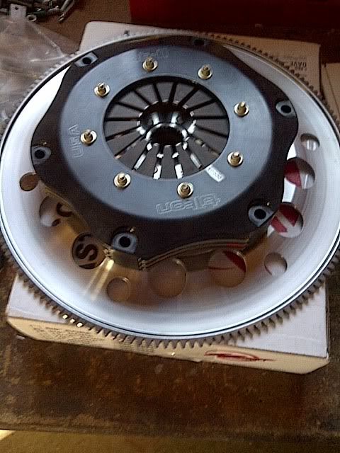

I started with a 1988 Mustang 5.0 engine, went with aluminum Brodix heads with 1.94/1.60 valves, stock 4" bore & 3" stroke, Eagle internally balanced forged crank, OEM forged pistons, OEM rods, ARP hardware, Engle cam, solid mechanical lifters, steel roller rockers, and aluminum flywheel with a King Cobra clutch. I'm hoping for a fairly quick-revving engine that's reliable and has a vintage sound to it. For now it's only got 44mm Weber IDFs but will either put 48s on it when I get bored with it or will swap it out for an LS to take some weight out of the car.

That king cobra clutch looks mighty nice too (small/compact) - I have a cheap 11" on mine / we'll see how it does. I added 295 radials and hopefully it can handle a warm day on hot asphalt
