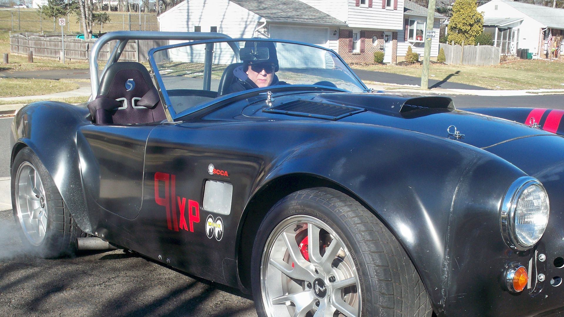

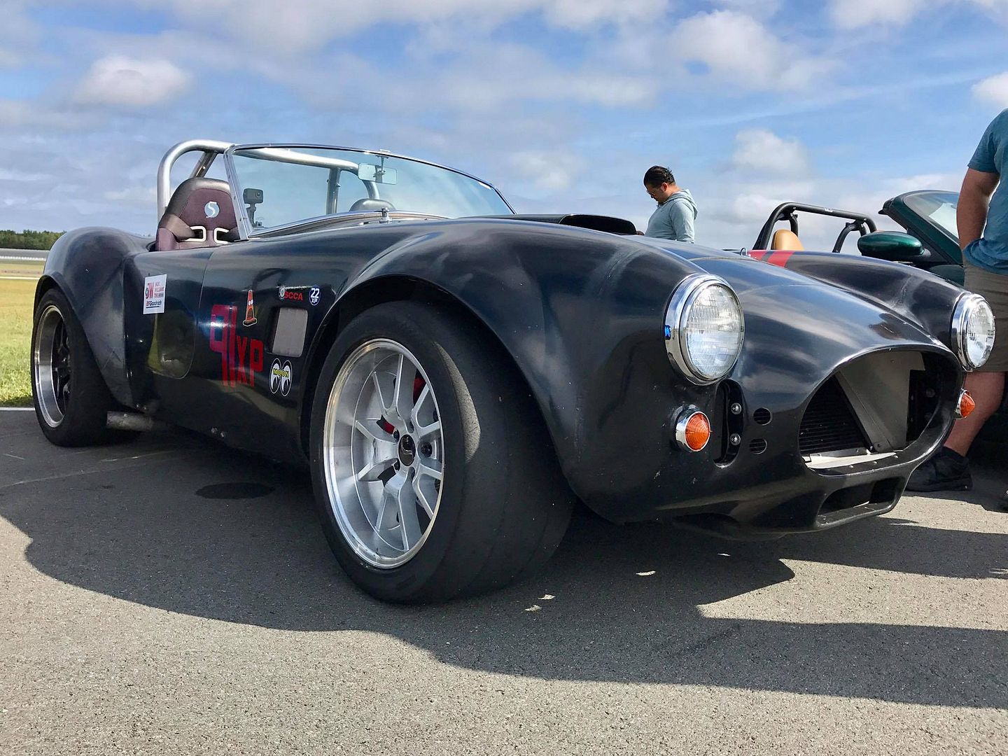

Or you can just have a front ride height over 4" as Doc said depends more on wheels and alignment.
These are 255 x 17 on 9" rims on Mk3
295 x 17 on 10.5 rims

In addition to added cornering power if tuned properly, the 275s help a lot w/ the usual FFR too much front brake problem. Mine is a MkII but I have never run less than 275s since 2007. For autocross rubber in 2015 I ran 295s on 9 in wheels first and then on 10.5 wheels for the last half. In 2016 I ran 315s on 10.5s on all 4 corners
