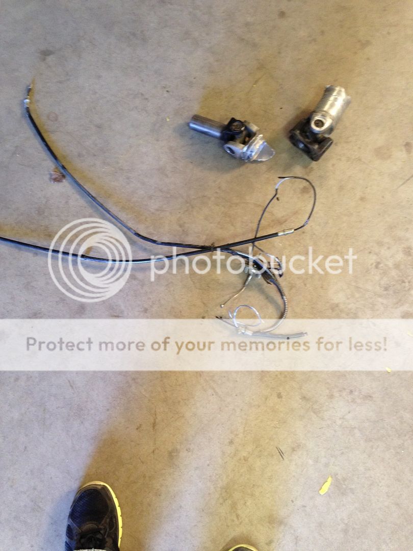

Not chancing a second time. I got lucky the first time!
Very interested! I like the bolt on and apart option.

What was the cause of that? What engine/HP are you running? Where did you source the driveshaft? Never seen welds like that around the shaft to yolk.

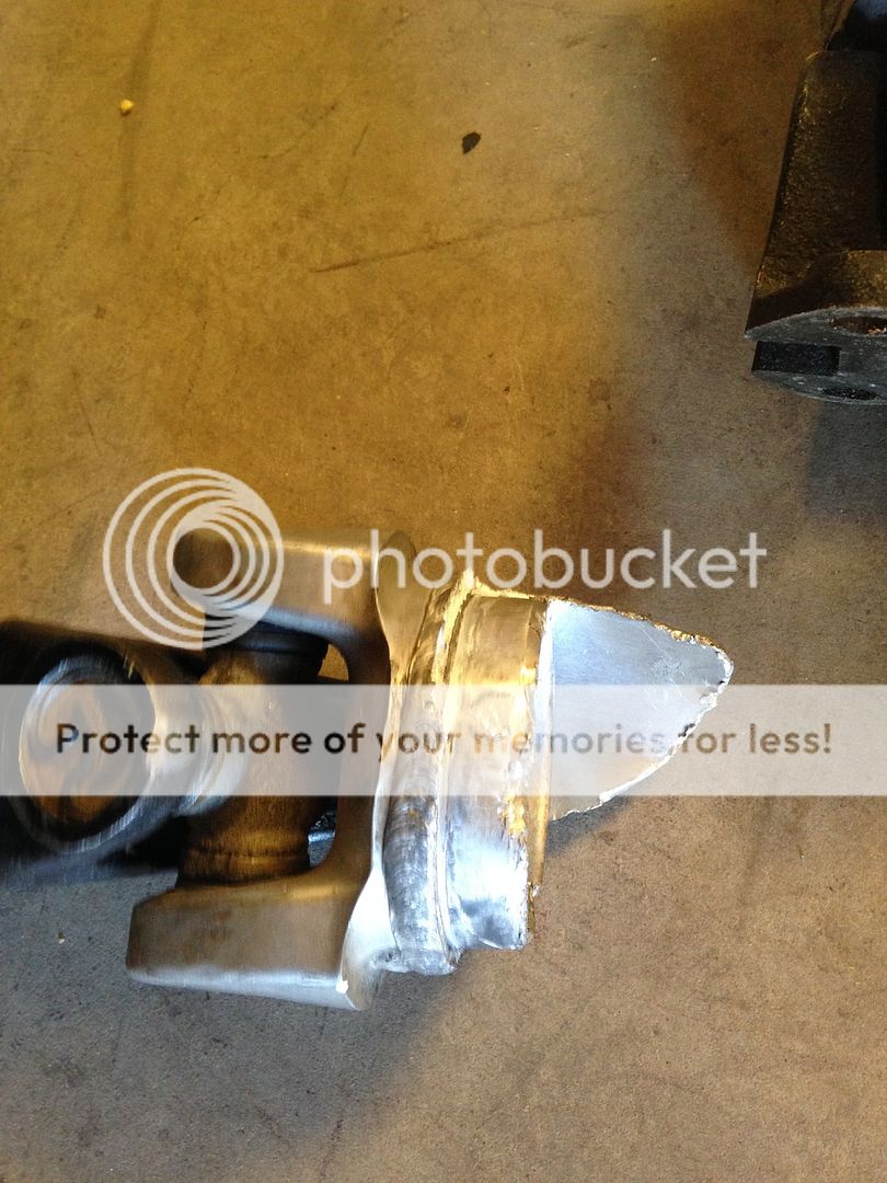

Cause: Weak weld due to heat stress (crystallized AL)
Source: MPE racing, now this is very important It was not their weld that broke or caused the failure. What happened is it was a 1/2 took long and the shaft was shortened. I believe that they threw it on the lathe and cut the weld and then just took a 1/2 inch out of the shaft and rewelded. This further crystallized the AL and caused the failure.
Engine/ hp: Rousch 427r 530hp/ 524 torque When it failed I was rolling away from a stop sign, not on it or in it by any means. 60 degrees out and cold tires, you don't play with. I was taking it to the interstate with my boy to run it out a little, nothing serious just taking it out.
The original weld which is on the other side, is much wider and overlaps the starting point. A very clean and well done weld.
I'm taking the drive shaft in this week and having a new one made. I haven't decided on the material that will be used. There will be a long conversation about this. The shop came recommended by a race/rod shop down here. They mainly specialize in drag cars is my understanding.
I welcome any input on this.
Back to the subject at hand, I am very lucky that I did not get hurt or my boy did not get hurt. What you see is the only damage besides a hole in the AL about the size of my pinky. It broke at the tranny end but a hoop still would of helped.
