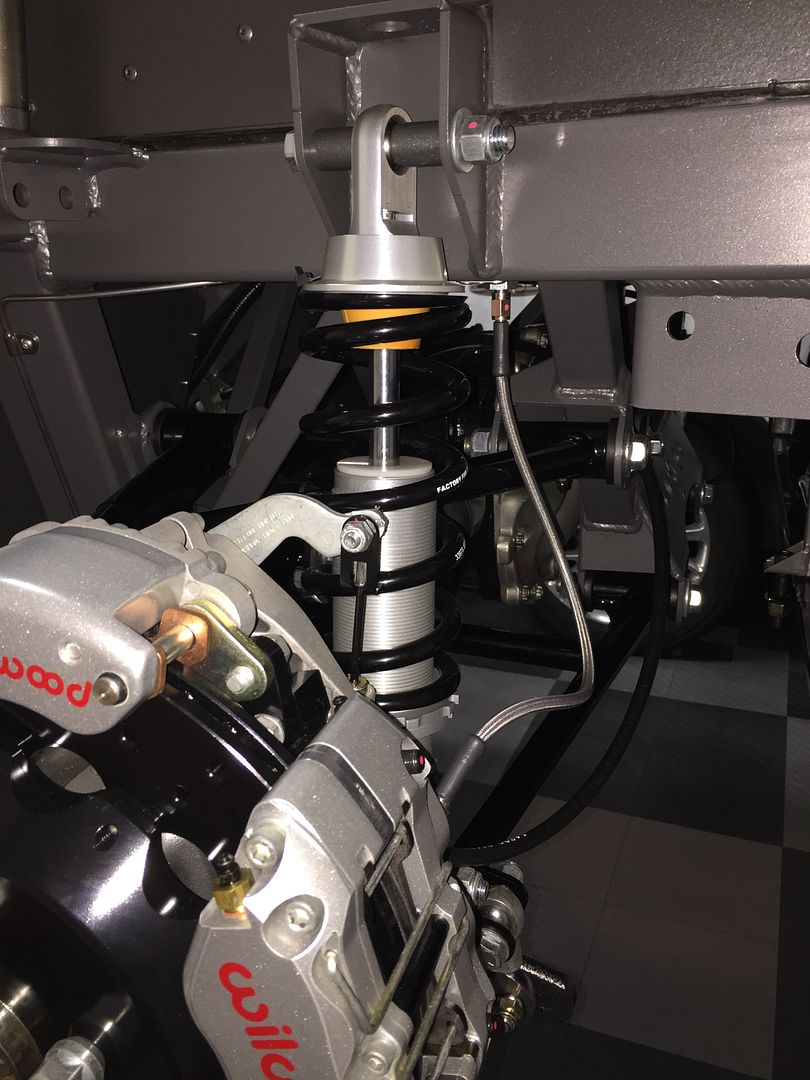

Parking brake cable
Hi Paul, I've been looking over your build thread and admiring your work. I recently installed the Wilwood 12.88 brakes on my build. They appear to be the same as yours and my question is did you use the Wilwood park brake cable kit P/N 330-9371? Thanks for your detailed build thread.
JR

Hi Paul, I've been looking over your build thread and admiring your work. I recently installed the Wilwood 12.88 brakes on my build. They appear to be the same as yours and my question is did you use the Wilwood park brake cable kit P/N 330-9371? Thanks for your detailed build thread. JR
Thanks, and you're welcome. To be honest I don't know much about the e-brake cables I used. They were what came with the kit. What I can say though is they weren't the 330-9371 kit you reference. I suspect they were just regular cables (as opposed to Wilwood) and required the adapters they supplied at the calipers. I painted them, but you can see them in this picture.
The other ends were the right length to attach to the FF e-brake handle when routed under the chassis tubes. I cut them off and routed above the chassis tubes and attached with the Lokar clevis shown in my build thread.
