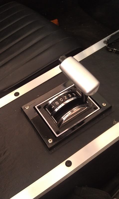

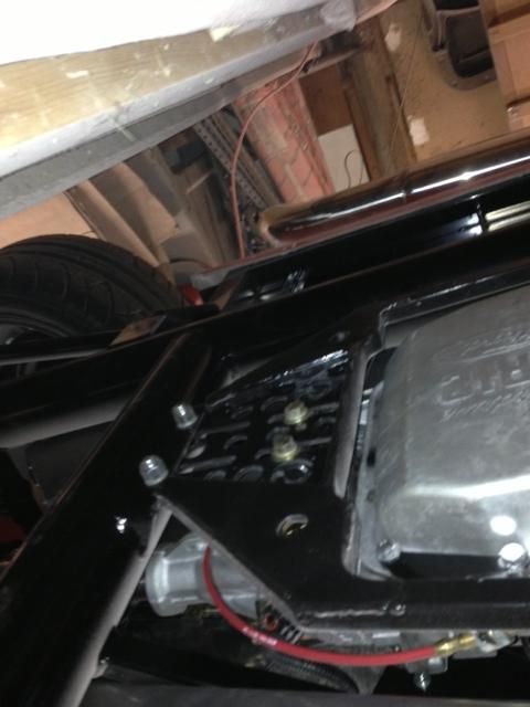

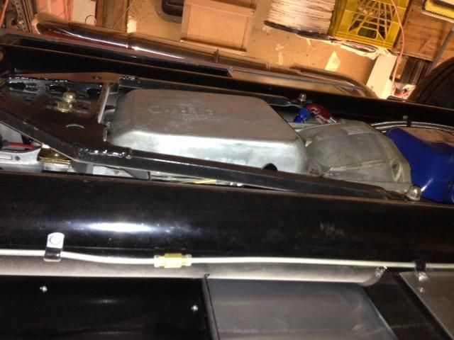

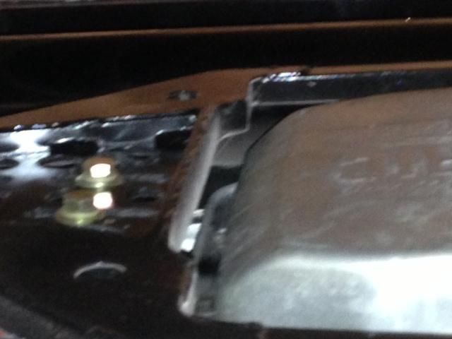

This is from one of my other threads, it may be of some help. As for owning a roadster with an automatic, I think its great. My AOD has been lighlty modified with some stronger elements and a manual/auto valve body. I have a ratchet shifter which lets me control the shift points if I want to or not. If I recall my torque converter stall is at 2400 (I think...). It shifts almost instantly.
Originally Posted by evvander11 View Post
As an update since I had a forum member request some additional photos of this modified A-frame installed, here are some photos of it. Hopefully this might help some others.
In this photo you can clearly see where the cross-member bar was cut in half on the vertical and a piece of 3/4" strap steel was welded in to make clearance for the pan bolts for when it needs to be removed:
This one is zoomed in on the strap steel part, sorry for the blurriness:

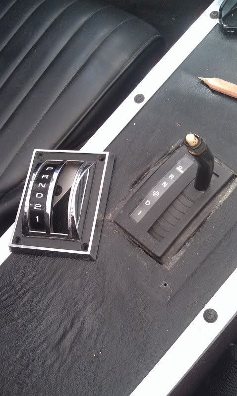

I made the switch from T 5 to AOD this year after thinking about it for two years. I absolutely love it. One of the main things I like is all the room in the footbox with the pedal out of the way.
I had to do a lot of the stuff mentioned above. I did install a cooler. I have Tangent's light kit in the lower opening but mounted the cooler behind it. I still need to install a gauge.
I had to re-do the transmission cover since the shifter is way further forward.
I kept all the T5 stuff, including the tranny cover so a guy could switch back easy.
Very happy with the change. I've had a bunch of nay sayers when they see it but a couple of them have driven it before and after and they all LOVE it. I can just roll into the throttle and light 'em up!
