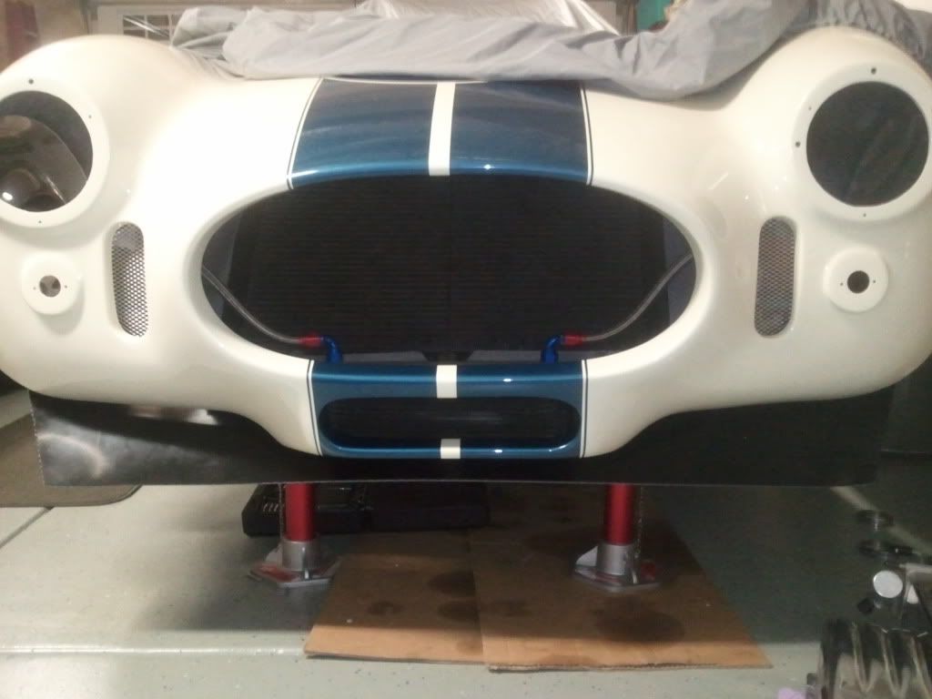

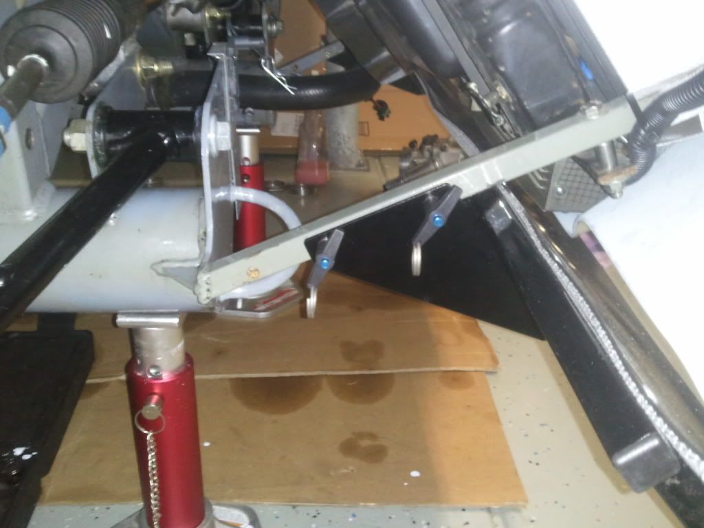

Just finished my quick release (push pins) front spoiler, got tired of the FFR spoiler getting bent,, wraped up under the car this way I can run either the FFR alluminum one or the conveyor belt material on the same frame and remove it in 10 seconds

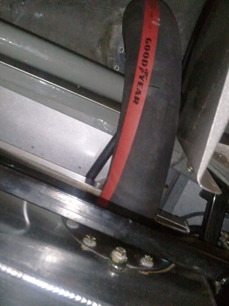

Installed Goodyear flexable fuel filler hose, got rid of the clunkly metal elbow
