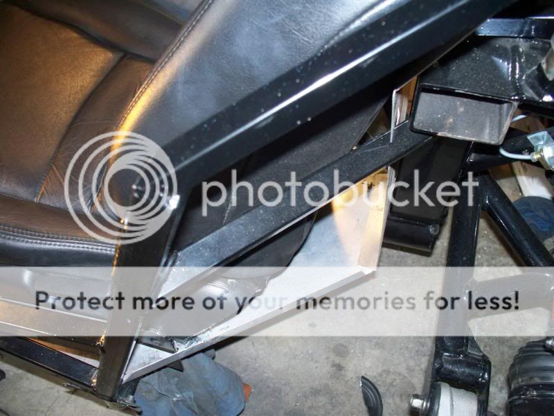

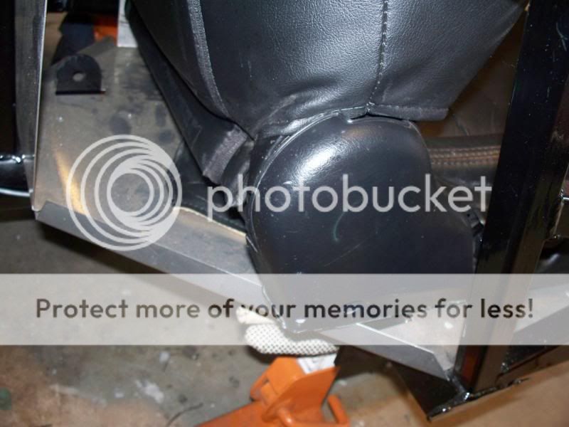

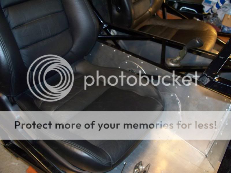

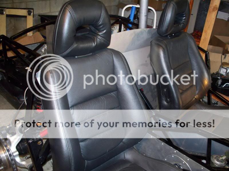

Originally Posted by JJ'snakepit View Post
Plan A to bolt down the seat, didn't work out so I revised my thinking and went with plan B.. I worked all day getting my hardware set up and was fitting every thing in nicely when I drilled through the bottom and hit a brake line.. Got fed up and went inside fixed dinner haven't done any more... One step forward two steps back...Tomorrow... JJ
This is kind of odd Quoting one's self. This thread started yesterday. Today I got back into it after church and a trip to Home Depo.. I don't know how you other guys mount seats with out tracks and all my side and back panels are still off... It was still a major PITA.. I got the one seat mounted and the other one 90% done. I am using OEM seats from an Integra... All the bottom sliders were cut off to lower the seats and then I used universal sliders to reinstall them in the Cobra. I mounted the sliders on the bottom of the seats inside towards the center which allowed it to skim about a 1/2" off the bottom.. With the tracks I could move them forward then backward to line up to drill holes an such.. Major PITA. I had to do a lot of custom work on the seat to make em work... a couple of pics
