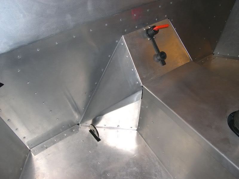

Some updated pics of my parking brake mod with the aluminum handle I made up on the lathe.
Finally time to put on the rest of the trunk and rear cockpit aluminum. First step was to mount the panels (I drilled them some time ago) and mark where all the frame members go. I then masked them off the two main panels and sprayed them with rubberized rock guard wherever they are exposed.

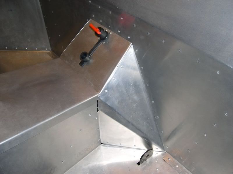

I went a different direction with the cockpit aluminum and installed it so that the majority of the seams would be on the outside. The seams would later be coated with the rock guard that hides them pretty well on the outside.
I also used a 1/8” x ¾” spacer between the rear wall and the upper ¾” tube to get rid of the weld bead issue that can cause the rear wall to buckle a bit.
Passenger side uncoated.
Driver side coated.
Comments are welcome.

We took the other approach and fit all the tabs inside the cockpit which will ultimately be covered with carpet.
In hind sight our approach took way too much time re-shaping all the panels and no one will likely ever notice the difference.
Your sheet metal looks perfect! Nice work.

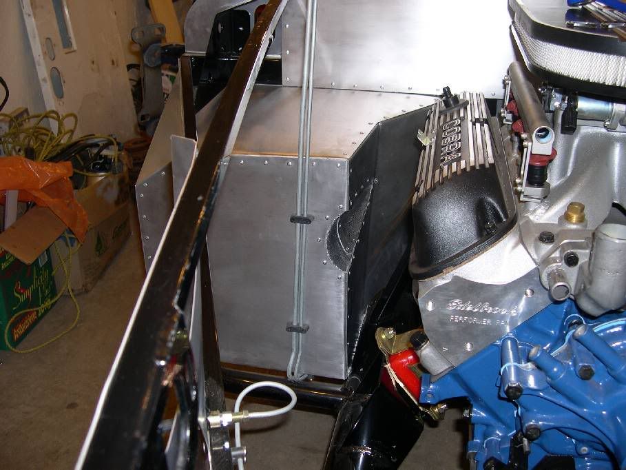

Curious - I may have missed it in another post but in the picture below, you have a special piece in the passenger foot-well - Is that for header clearance??

All the posts I've see seem to say the panels are designed for the tabs to go on the inside. But I did have very little fitting to get them to come out with with the tabs on the outside compared to what you describe so maybe that isn't the case.

Thanks bud!! You got it right about the little piece in the pax foot box. I got a little carried away with my expansion and had to make this up to clear the headers. Here's a couple of pics from the other side.
More pics of the footbox here:

Is your engine a 302 or 351? I am also running the 4 into 4s with a similar PS footbox mod with a 302. Could end up having to perform surgery.

Mine is a 302. I moved the side of the footbox right over to the 4" tube so if that is what you did you probably will need to clearance it.

What are you using for the rubberized rock guard spray on the panels?
The pic showing the coat on the wheel well alumn looks like something else. Is it?
