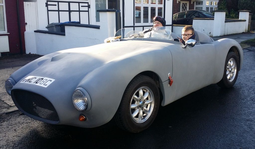

So I, legally, transferred my car over to a 1965 "C" registration number, while still retaining the 1980 date on my car's documents.
( The car should look older to the casual observer. )
The new rear number plate I ordered slightly longer than my old one, as the "V" reg only had 2 numbers in it.
( Numbers 1 thru 999 can be used. )
Note: The use of "raised" plastic digits is also an old fashioned approach, which should add to the illusion.
Previously, the rear number plate light was bolted into position thru the number plate itself.
But the fact this new number plate is "raised" allows me to fit the light underneath the plate.
( Once I had filed a section of the top edge away, so it would fit around the light bracket. )
After drilling some holes and using a couple of washers to make sure the plate cleared everything, it was bolted into place.

It seems that most 'smart' devices will not allow my YouTube car video to play, not just Apple ones.
Anyway, here is one of the many 'out takes' from the original footage.
"Is the camera filming?"
The young boy in the shot is my friend's son who came along to help with the filming.
So it only seemed fair that I have him a lift to the locations.
He had a lot of fun on the day and we might get him some suitable accessories if he joins us next time.

Prepping for Paint:
Given the Frankenstein nature of my build, the on the road shakedown in primer idea was a good one.
As you can now see some of the 'lumpy' bits that have been brought to the surface under the stresses of driving.
( Although this side also includes a reminder of a small slip I had with my angle grinder still spinning. )
So my next big job is to go through the final round of body work preparation and get some paint on the car.
The good news, for me at least, is that I am now happy to accept some imperfections in the body work.
I gave up trying to achieve perfect symmetry in the car a long time ago to give myself a very slim chance to finish it.
Since I've been on the road, I've yet to hear a single negative comment about issues with my wheel arches/aero humps/bonnet, etc.
As the reality is that I have built a great little car that is fun to drive and genuinely brightens other peoples' days.
If I look back at this photo of my last racing motorcycle, I quite like the way the dent in the tank is simply painted, not repaired.
Which leads me back to one of my favourite quotes from another UK builder.
"… like a 50 year-old race car that has been into the hay bales a few times in its life - perfect…"
So I am sure that a less than perfect British Racing Green will still look miles better than the grey primer.
