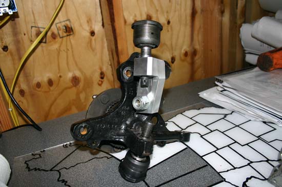

[quote}Kingpin inclination angle. The FFR roadster has a terrible SAI due to the requirement to adapt the stock mcphersion type spindles to a double A arm suspension. About the only thing you can do to improve it is to adapt a different spindle to the chassis.[/quote}
...or you can install these from Whitby Motors:

David, I'm a complete noob when it comes to suspension stuff. What exactly does this invention of yours do to help the suspension in a Roadster? Is it it a "track only" part, or would this be beneficial to the street and country back road drivers as well? I saw this posted quite some time ago in the spec racer forum, but don't have a grip on what it actually does.

Obviously David can tell you exactly what the SAI mod does better than I can, and there is a good discussion of this mod on the auto-x forum, but the adapters that David and others designed will replace the IFS bracket along with changing the mounting point of the upper control arm to help eliminate suspension design compromises that FFR was forced to make by using donor suspension parts (the spindles). Not too many people have done this mod yet, but I remember reading that at least one person felt that stability was improved on the freeway. Also I dont think that the kit was intended for cars with pindrive length control arms.

f4sfed, It doesn't have anything to do with the bumpsteer, as that is a rack/tierod location issue, so that still needs to be dialed in on a case by case basis. Should matter which MK version the car is...
I'm really curious as to whether it is worthwhile to do the SAI mod for a mostly street car.

Guys, go over to the auto-X forum and check out all the comments made about the SAI mod. There are also lots of fixes for the bumpsteer problem in these cars, Levy has a good kit, some have made rack extenders, others have bought custom racks. Do a search on bumpsteer in this forum and you will find way too much information.
