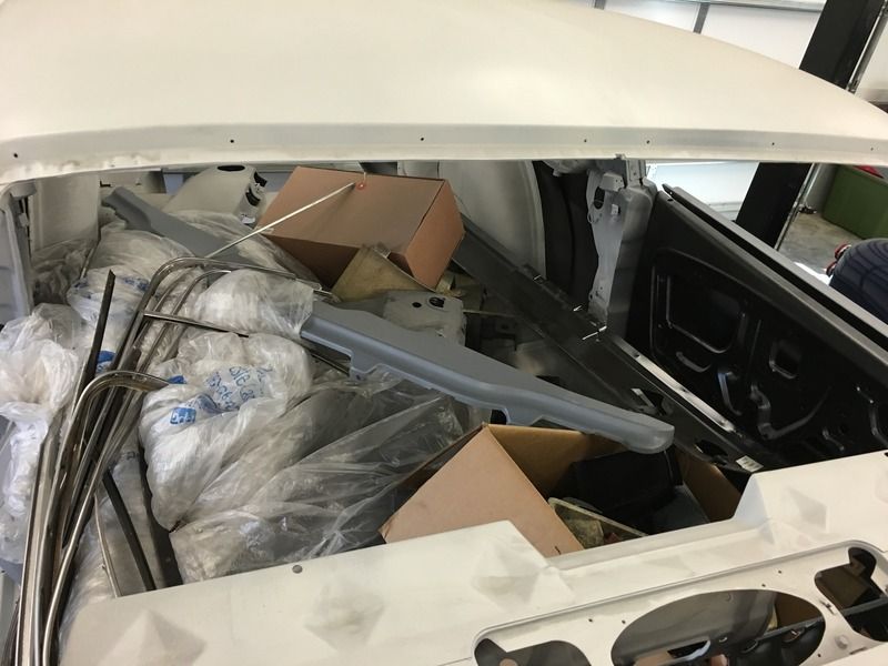

It's here
Car is sitting in my shop now.
Step 1 - Empty out the interior and inventory what I have.
Been killing myself deciding what I want this car to be when it's done. I think I'm going for a loose interpretation of a Street GT350 (but with a rear seat delete and more modern front seats).

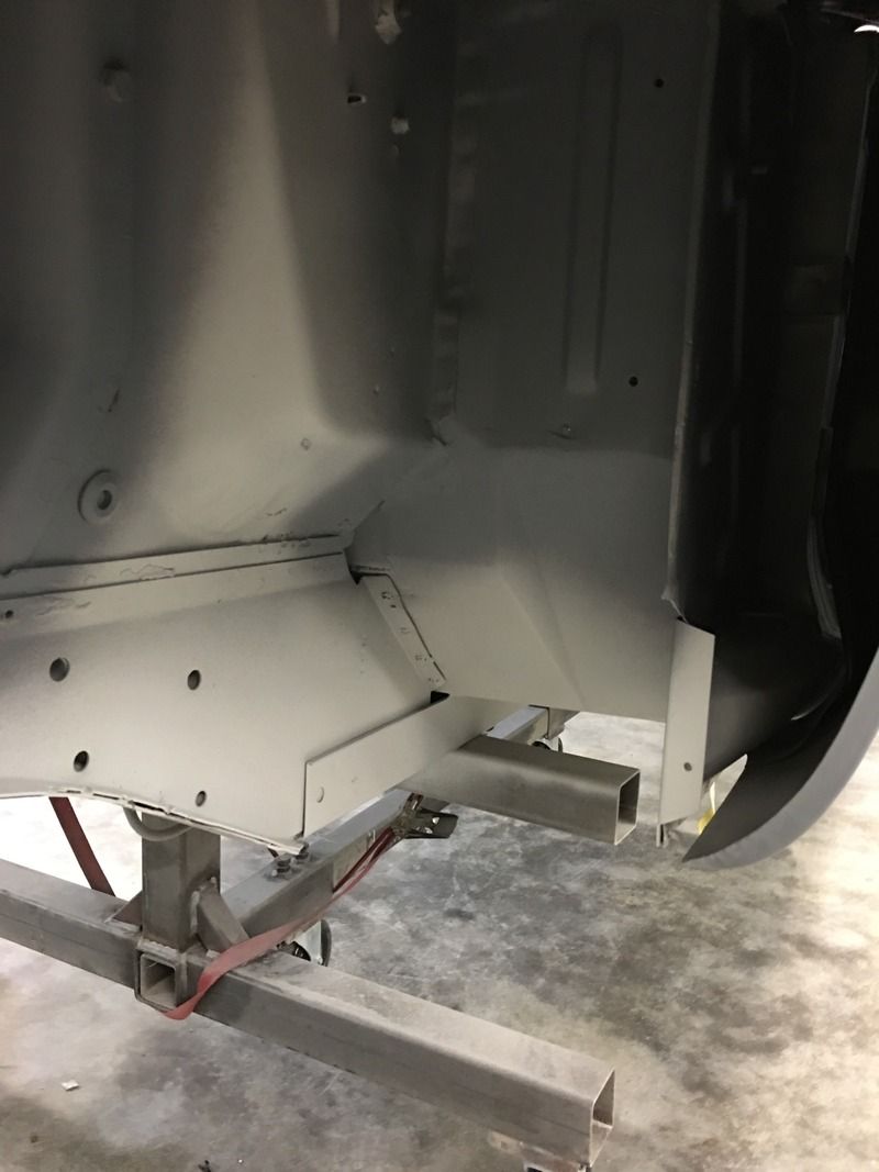

All joking aside - he is right... the early Mustangs can use some help in the stiffness department.
From the pics, it looks like yours doesn't have the front torque boxes inside the fenders - they cover the angled part of the floor pan / toe board and work to stiffen things up by connecting the front sub-frame to the rocker panel and the floor pan itself. They're not easy to install, but they do make a difference.
Also, even though it probably already has seat platforms in it, you may want to consider removing those and replacing them with the convertible version, which is a one-piece affair that crosses over the top of the trans tunnel. And, while those are out, you can add the "C" channel convertible inner rocker reinforcements, too.
Check out any of the sources for sheet metal and you can get an idea of what all these parts look like.

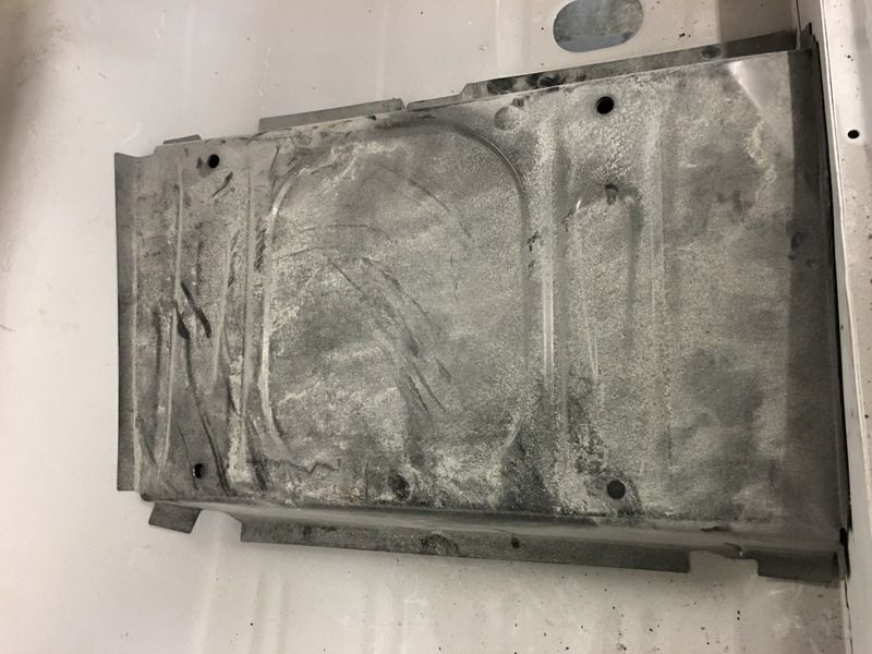

Oops. Here are pictures
Seat risers aren't attached. If I do a roll bar, won't that stiffen things enough so I can use these?
Am I missing torque boxes? I thought I read that they weren't in the 65 model.

Inside passenger wheel well

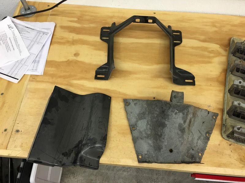

Some of the parts on the tables
We stored the stainless trim and interior panels up in the loft since I won't be needing those for a while.

Torque box is driver side only

This is inside the driver side wheel well. Am I missing anything?

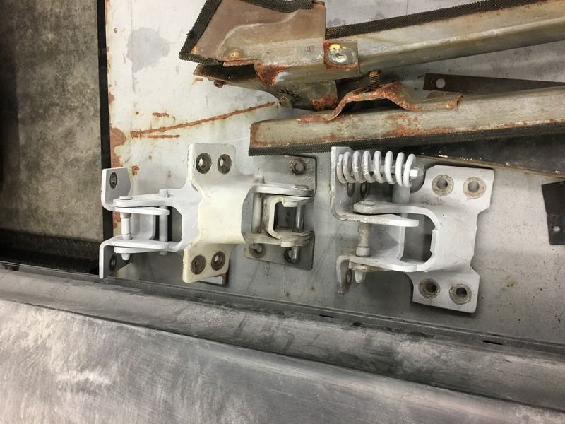

Here are some pieces I found in the car that I can't figure out where they go. Any ideas?

Torque boxes are available for all 4 corners.
Search results for: '65 torque boxes'
