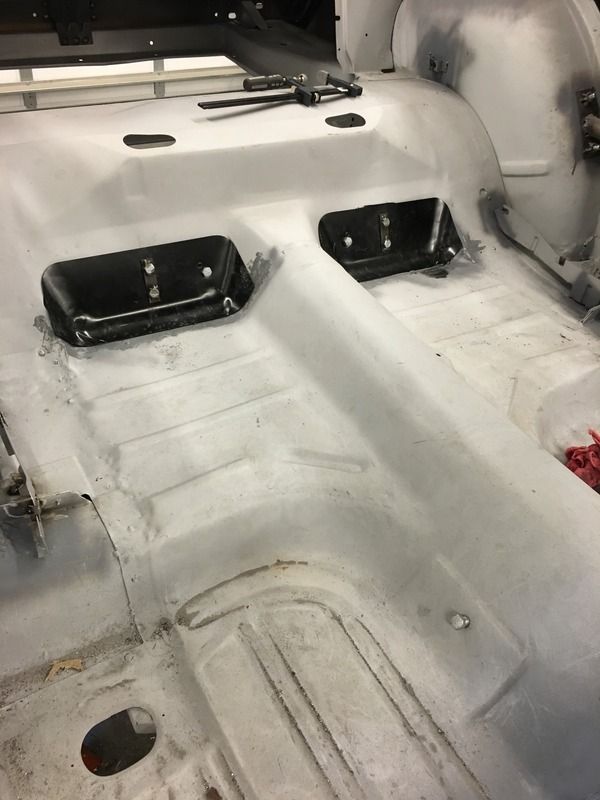

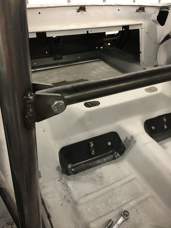

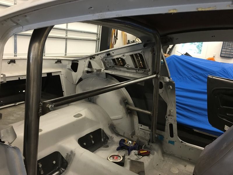

Got the fox body seats modified for the stock mustang rails and fit them in the car.
Took measurements and cut the harness bar to fit between the roll bar tubes.
Waiting for the mounting tabs to show up and then I can finish up the roll bar.
The picture is deceiving...the bar is just below the top of the seat back ( so it will be safe for short passengers) and with me in the driver seat, it's about 9 degrees down from the top of my shoulders.

This doesn't look like much progress, but I welded in the removable harness bar tabs. My welding is getting better with each piece.
I need to remove the bar to put a bead on the inside of the brackets and clean up the welds a bit. Even with the seats installed, I can get the whole rollbar out in one piece (which was my goal).
Anyone have an idea how thick powdercoating usually is? I used some painters tape to try to create a bit of a gap between the bar & tabs, but it's still a snug fit. I'll need to grind away some metal for a bit more clearance, but don't know how much I need.

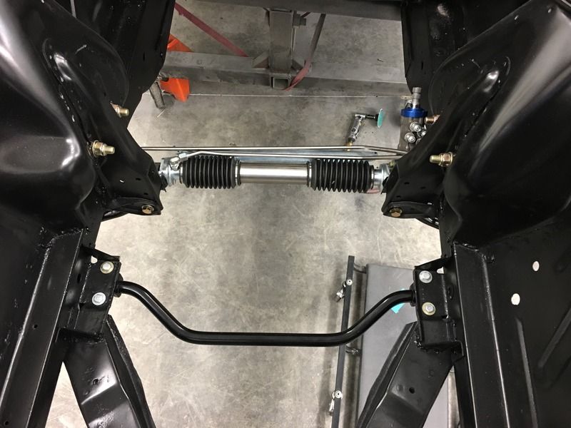

Sure am glad that I'm mocking everything up before paint. Seems like every piece (even things that I thought would be a quick bolt-in) needs to be tweaked.
I installed the Scott Drake 1" sway bar last night. The brackets needed some grinding an widening of the holes to line up. But it was probably the easiest part I've put on the car so far.

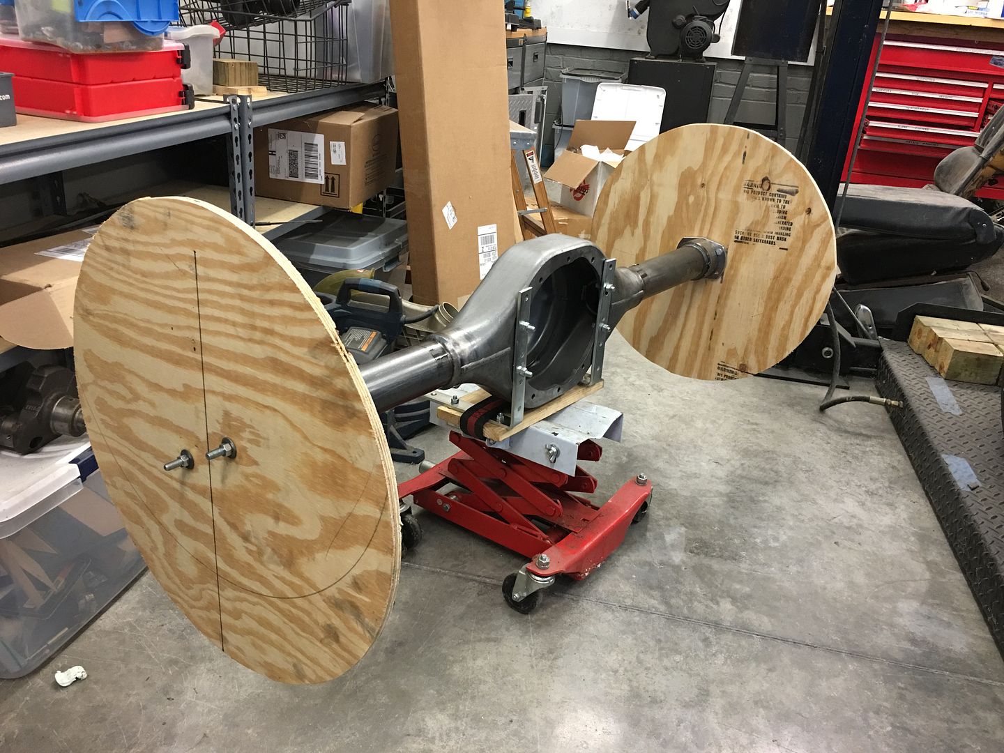

Other than needing to get different bearings for the hubs, the front disc kit from Wilwood is going in easy.
I'm using a drop spindle and didn't realize that the "pin" is based on a 1970 model which is thicker than the 65 spindle.
Expecting to get my gears very soon, so I made a cradle that will make positioning the rear axle a one-man job. I will be able to tilt the housing to get the right pinion angle too.

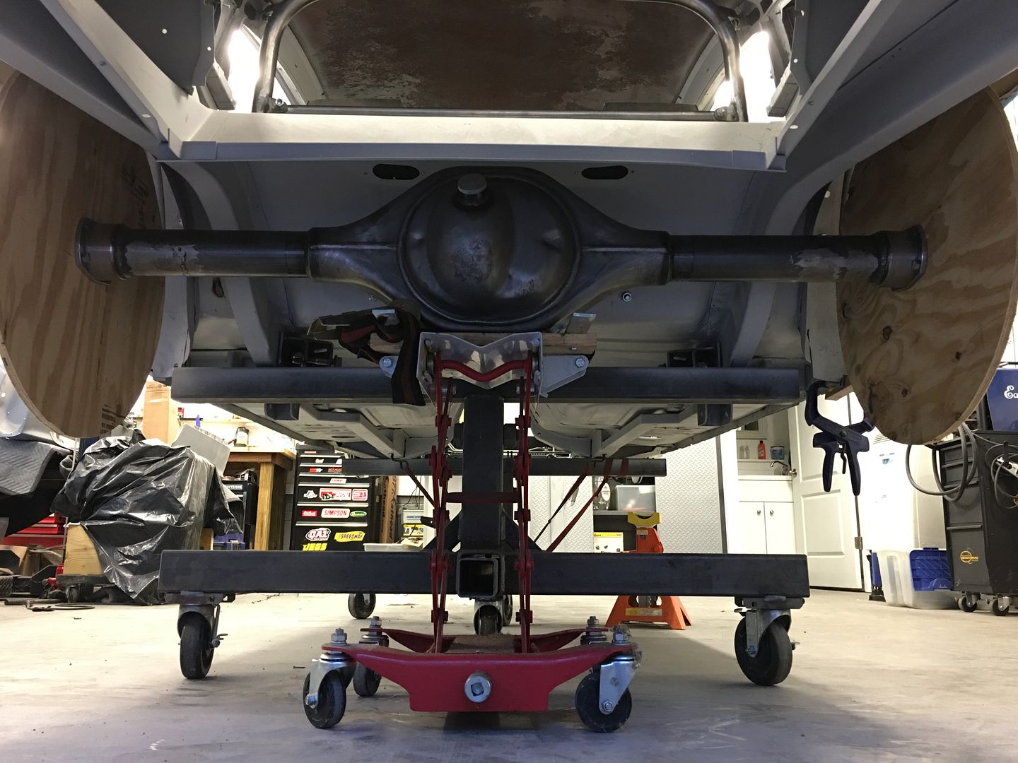

I'm done with the front suspension, so time to work on the rear. Still no gears, so I made some 'wheels' out of plywood. They're 24" in diameter and using a template I found online, they're bolted to the axle housing pretty close to dead-center.
This is just a rough fit. The plumb bob is hanging with the wheelbase measured at 108" and the 'wheel' is pretty close to centered right on that line. Does it look right to you or should it be back a bit more?
The wood I have clamped across the bottom is so I can get a measurement from the bottom of the rocker to the ground. Should be able to figure out my ride height using that for reference.
I haven't messed with the left/right position. I might cut some 'windows' in my wheel so I can easily measure each side using the frame rail as a reference..but I think visually I should probably measure from the fender lip to the wood wheel to determine if the housing is centered. I think it's more important that it look right with each fender lip than to be perfect where people can't see it.
I think I'm going to draw in a 17" circle to simulate the wheel...that way I can see where the wheel rim will be in relation to the fender.
I need to move the dolly forward (or get it off the dolly and onto jack stands) before I can weld any brackets, so I'm going to try to find some help this weekend to do that. Then I can get serious about the axle position.

Rear end is assembled and installed.
Next I will order tires and will find someone to rent a wheel measuring tool from ( just to make sure I get the wheel fit perfect since I want a couple inch drop).
Once I have the wheels, I can move the car over to my lift so I can trial fit brake and fuel lines before coating the underside with sound deadener and then doing the sound & heat coating on the inside.
Attachment 273593
Attachment 273601
Here ya go. Wheel Fit tool
Wheel Fit RENTAL (Ultimate Kit) - $49.99 : 1320 Wheels
I have the Percys Wheel Rite tool, and it's not all it's cracked up to be, the one in the link is much better.
