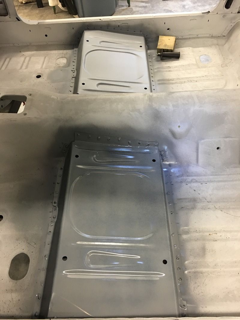

Spent the week getting the seat risers ready to weld in. Have both of them done (had to do some beating and bending on the driver's side to get it to sit flat.
This shows the passenger side, but both sides are done now. I also sprayed the areas to be welded with a weld-thru primer.

Got the seat risers welded in.
My welds aren't pretty, but they are solid. Got good penetration through the floor pan and didn't blow any holes through it. I put the plug weld holes about 1 1/2" apart, so I hopefully that will help make up for the spots where the holes aren't 100% full of metal.
I'd need more practice before I'm comfortable with some of the other things that need welding (going to shore up the shock towers and have a shelby style roll bar coming soon), but I'll keep at it.

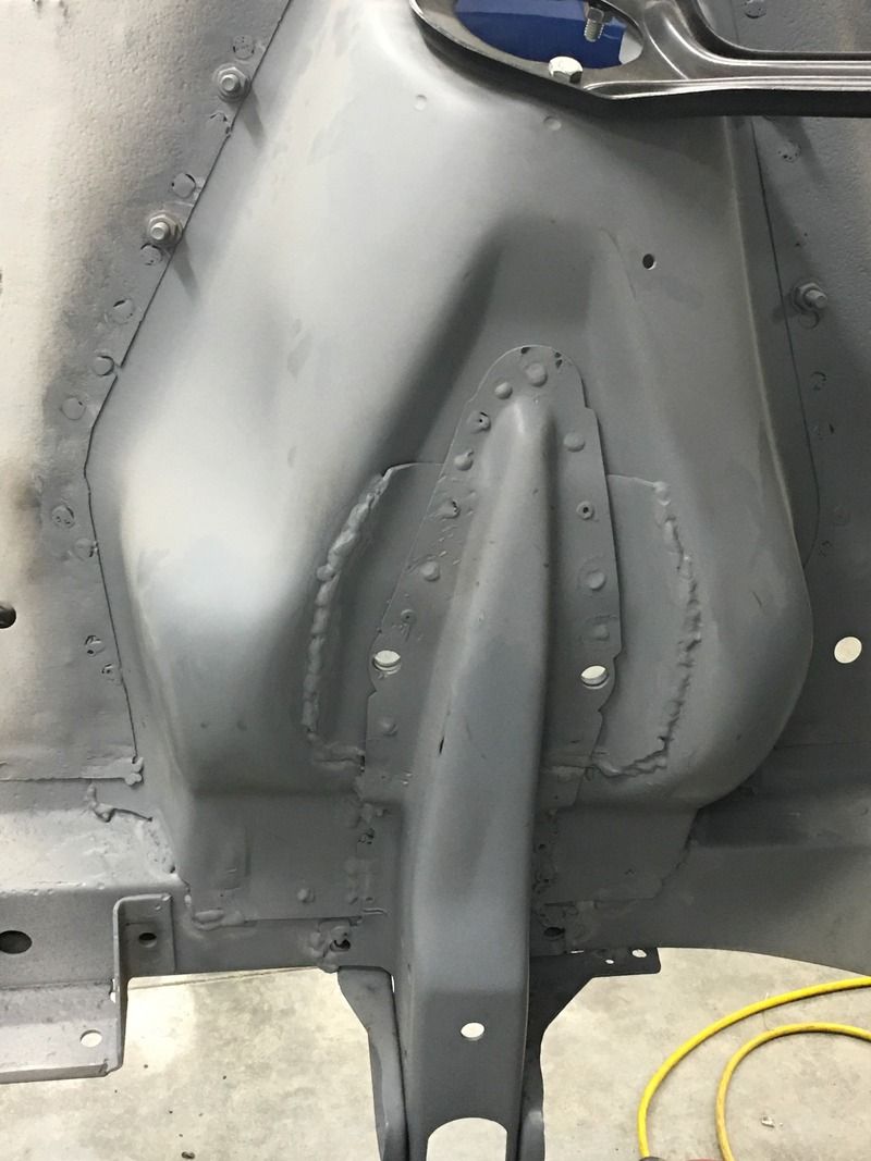

I'm installing front torque boxes to stiffen up the frame. Started on the passenger side last Friday and finished it up tonight.
Taking a short vacation to see the nascar race is Vegas this weekend, so I will tackle the driver side next.

Driver side torque box installed.
This side when a bit quicker and my welding skills are improving as I go. Still not good enough to want them to be in an area of the car that would be seen...but better than when I started this project a short time ago.

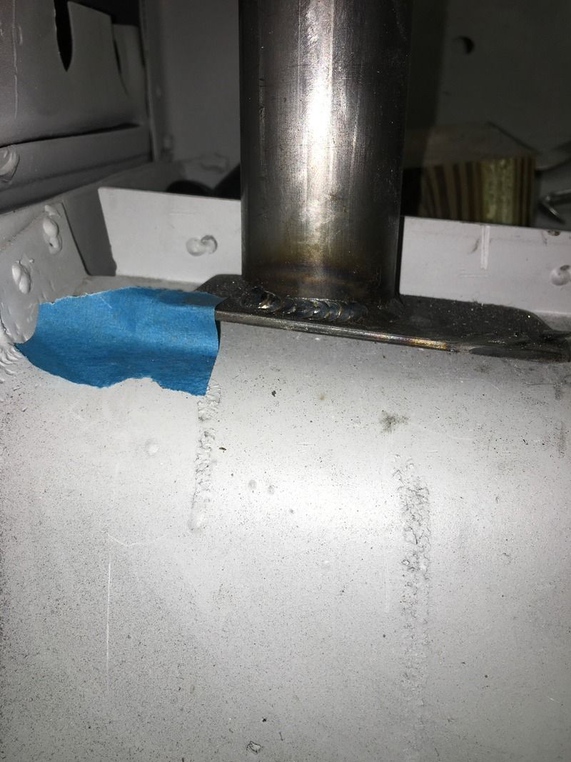

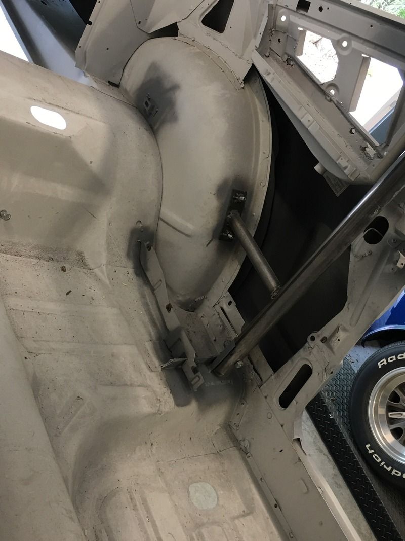

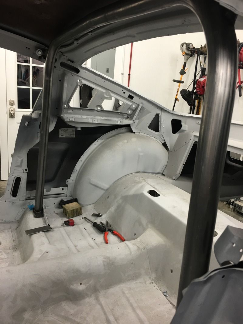

I'm installing a Shelby style roll bar. It doesn't do much for chassis stiffening or rollover protection, but it will give me a place to mount a 5 point harness and it has the vintage look I'm going for.
The bar came with brackets and was supposed to be a close fit, but since my car had the floors replaced, it didn't fit that well. So I cut off the lower mount and am making mounts from scratch. Found the idea on the Mustangs to Fear website.
This shows the gap at the bottom.
Here's the mount on the driver side tacked to the floor.
First time notching tube…fit came out pretty good. Found a couple of videos on youtube and practiced on a piece of scrap tube I bought at the recycling yard first…then dove in with the real thing.
Here's the passenger side with the lower mount welded in and the rear leg cut and ready to weld.
My welds still won't win any beauty contests, but I'm getting better at it.
After I get seats, I'll mount them so I can put the cross-bar for the belts in the right spot. I'll make the cross bar removable too in case I need to get into the back of the car for anything.

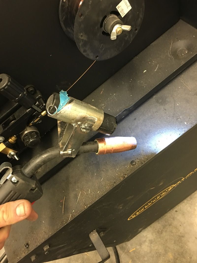

My night vision isn't very good (laser treatments to treat retinopathy from being diabetic ruins the night vision), so getting the weld torch in the right spot hasn't been easy. I made up a small flashlight holder that attaches to the handle and it helps a whole bunch (and it's not in the way).
I know there's a tool made for this, but I couldn't find it online and this one was free - even the flashlight was a freebie at Harbor Freight last week.

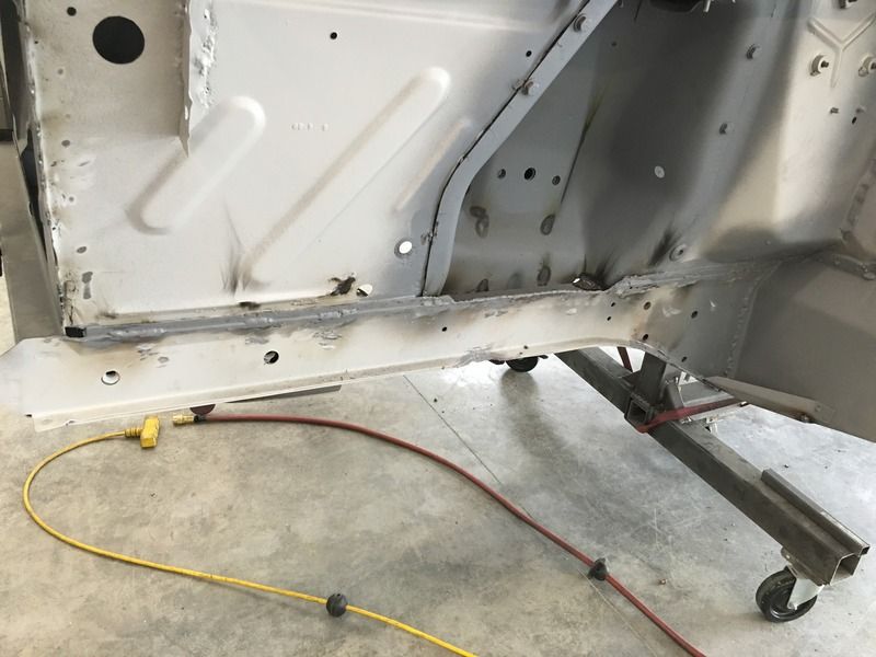

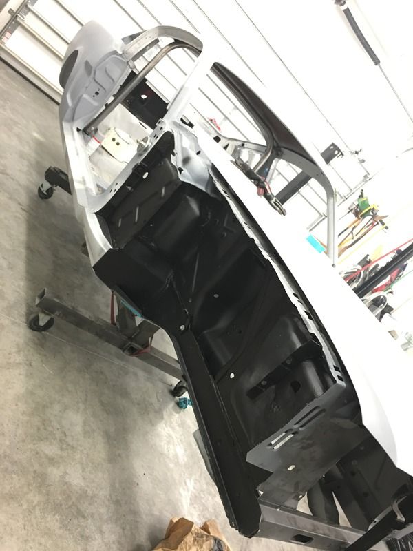

Welded the from frame rails to help keep things together a bit better.
The passenger side section area where the upper & lower control arms will straddle the frame (where the shock tower is) needed more work than the driver side. But I was able to get in there nicely with my welding torch and get a series of good tacks & short beads in there.
I seam sealed the driver side too...waiting for more to come via Amazon so I can do the passenger side and finish up some spots on the driver side frame.
Passenger Side
Driver Side

That light is a good idea Dan. Do you have an auto-darkening helmet? I often aim a standup flashlight where I need to see but it sometimes affects the auto-darkening so it darkens before I get into position. Any problem w/ you torch mounted light? I also have trouble, especially w/ on the car stuff where it is an awkward position w/ my glasses sliding down my nose so I am looking through the long distance top half. This getting old crap sucks doesn't it?
CraigS is online now
post #42 of 129 (permalink) Old 04-11-2016, 08:21 PM Thread Starter
FFCobra Captain
Dan Babb's Avatar
Location: Chapel Hill, NC
Posts: 11,248
I have an auto darkening helmet I picked up from harbor freight a few years ago. It has a dial for the settings. Would a helmet from a better brand make a difference?
Even at it's lowest setting of 9, I have a hard time seeing the 'seam' where I want the weld puddle to follow. I can do short beads OK, but when I try to go longer than 1" or so, the puddle will wander and then it looks like crap when I have to go back and fill in.
I don't have any problems with the light on the torch effecting the auto-darkening functionality. The flashlight doesn't always hit the right spot, but it's a lot better than trying to use a standup or magnetic flashlight and constantly having to move it around.
I found this on Summit, but I think the one I made throws more light (since it has 9 leds)
Steck LED MIG Lights 23240 - Free Shipping on Orders Over $99 at Summit Racing
I also wear glasses with bi-focal lenses...so it can be a pain to get the eyes focused if the glasses slide a bit.

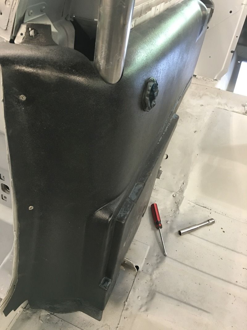

Since the floors have been replaced, I need to get in the brackets for the trim panels. I welded in the floor brackets and am still trying to figure out the ones that hold in the upper panels.
You may have seen my other post about fiberglass repair...but here's how the interior quarter panel looks in the car now. Not sure about the final colors I'll use on the car, so this is just a temporary coat of paint to help keep the repair sealed.

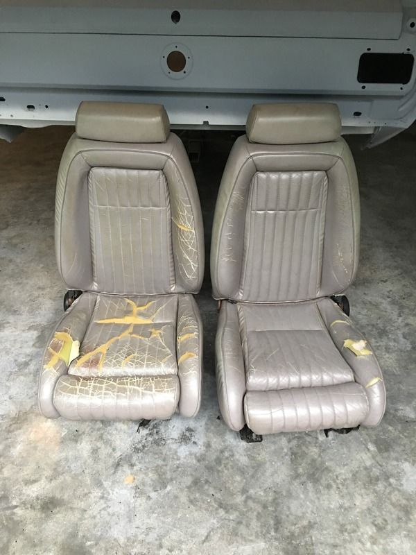

Found some fox body mustang seats for the car. These are a pretty common 'upgrade' over the vintage seats. Since the original seats I have would need to be recovered anyway, using these will give me a better feeling seat (that won't look out of place) for about the same money.
I'm going to call around to see what the total cost will be to recover these...if it winds up costing more than expected, then I'll just flip these on craigslist and will buy some ProCar seats that will be ready to drop in.

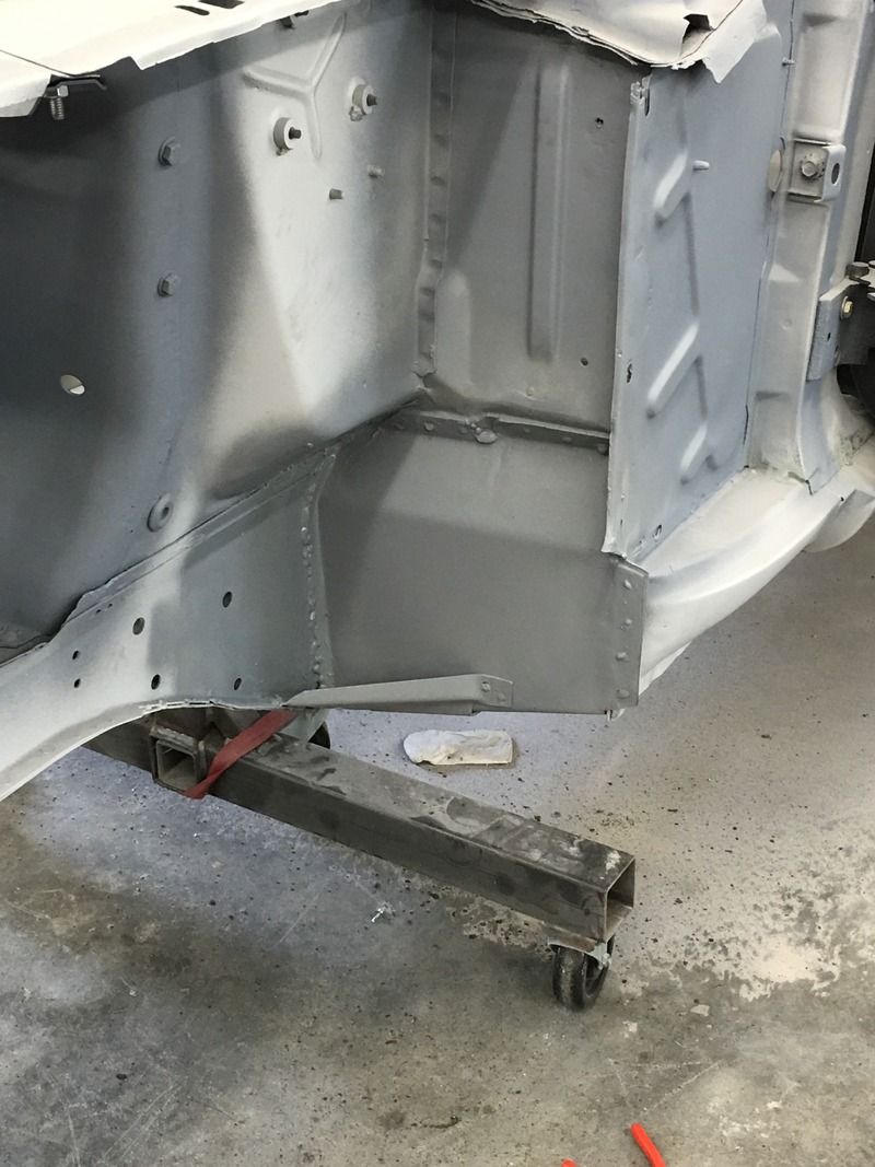

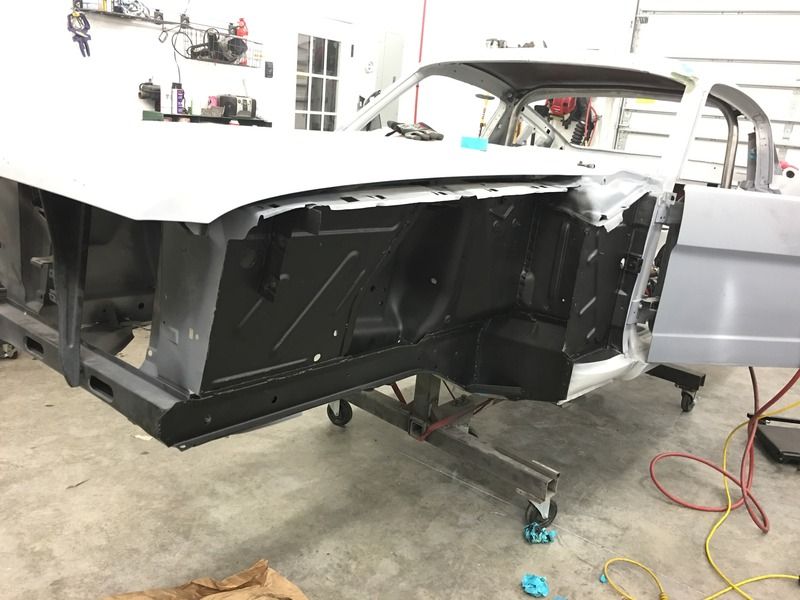

I finished welding and seam sealing the front end, so I used some bedliner on the inner fenders. This will give it better long-term protection from the elements and adds a bit of sound-deadening to the sheet metal too (not that anyone would really be tapping the inner fender from the engine bay side.
I did this part now so I can mock up the front suspension and leave it there when I eventually get the car on the road and drive around in primer for a while (before I tear it down for paint).

After
Couldn't grind too well along the outside edge, so I will use some seam sealer just to make sure I didn't leave any holes for water to get in

Dan, here's a photo of the Banda upper roll bar/seatbelt attachment bolt, I think it's just a longer seat belt bolt along with a steel spacer. Don't bother with the rubber roll bar grommets that fit in the side panels, they are designed to fit with the rubber coating that is on the Shelby bar.
