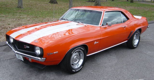

Here's one over in Minneapolis
Looks like a possible fire sale if you read the ad.
1969 Camaro
