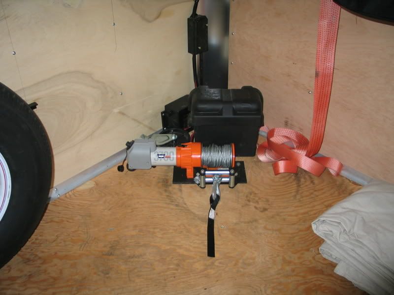

I have the same box but I have the winch mounted on the trailer deck. The box has a battery in it that re-charges off the 7 pin connector.
