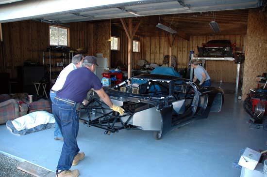

We spend the weekend separating the Vette body from the running gear. Started with the car on the lift disconnecting all the critical parts and lines.
While still on the lift in the lowered position, we used the cherry picker to lift the front of the chassis up and checked to make sure we had everything disconnected. We had a few things to disconnect and clearance.
Once we had everything pulled that we thought we needed to and unbolted the body mounts, we pushed the car off the lift. Once off the lift, we backed it up the front of the lift, and hooked the front to cherry picker again.
Lifting from the back with the 4 post lift and the cherry picker, we start to lift the body off the running gear.

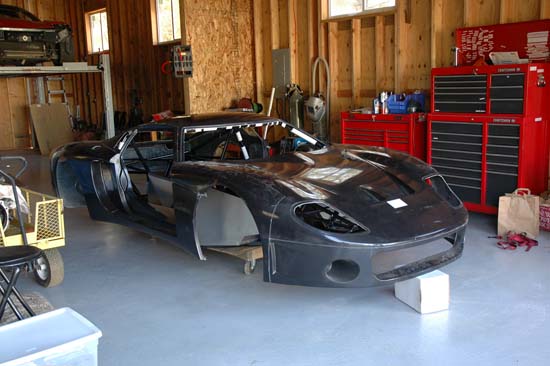

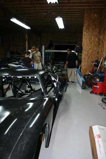

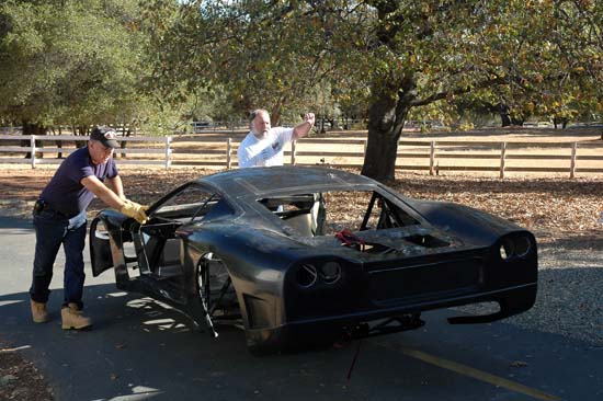

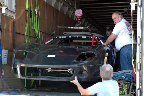

Today is the day I am allowed to let the cat out of the bag! I’ve got a GTM sitting in my garage! As a Beta builder, I had an agreement with FFR not to post about having the car until the first day of SEMA.
It was actually delivered a bit early while I was on vacation. Don DePontee and Friends were kind enough to meet Paul and the Stewart truck up at the house and my father was there to help them out and let them in.
Great shot of the shape of the car as it is hoisted off the truck.
Car being towed up the driveway.
… and being wheeled into the shop.
Thanks guys for the help with the delivery!!
Sweet!!

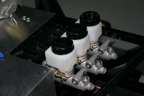

Wilwood Masters and pedal setup installed. Very high quality parts..

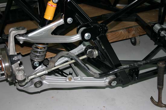

Rear suspension completely installed after C5 donor parts were pressure washed and the control arms were painted. Im thrilled FFR is including adjustable monotube Konis with the kit. They had Koni come out and help develop and test the shock package.
Shot of the rear of the chassis.
Looks like the front anti-roll bar from the C5 may work as a perfect rear sway bar.(if there aren’t any transaxle clearance issues) A simple re-design of the FFR lower shock mount could easily accommodate this.

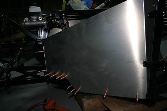

Starting the aluminum work.. I plan to fit all the aluminum with clekos first, then take the exposed pieces under the front hood and the engine bay and have them powder coated silver.
