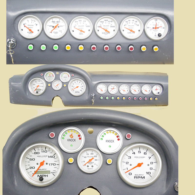

Today I worked on the dash and gauge layout of my Spyder.
Tomorrow I'll pick up a hole saw so I can cutout the holes for the speedo and tach.
I still have a little welding to due before I Powdercoat the frame but I killed my welder and I'm waiting on a part to arrive so I moved onto other things.
Paul

Not to hijack, but I used the Autometers as well, and CRAMMED them in the cluster. Here's the beginning of the obsession. I ended up using an EGT gauge in place of the KNOCK gauge on one side:

Today I finished cutting holes for the speedo, tach and indicator lights on the dash of my Spyder.
Next thing I need is an ignition switch.
John, I've looked at your build many times down through the years.
