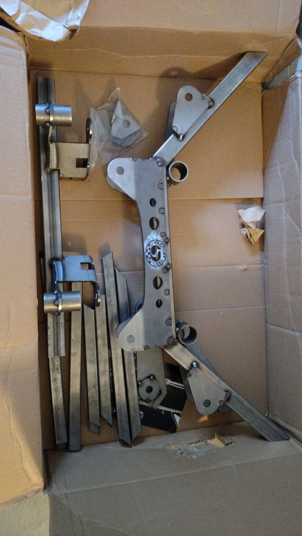

Got a box of frame parts from FFR this week.
Waiting on axles and control arms etc.

Do those frame parts have the finished welds or will you need to complete welding them? They appear to me to be only tack welded but I haven't seen the new IRS frame parts before so maybe that's the way they are supposed to be.

Yep tack welds only. Yesterday I took that big piece over to a friends who is is building a 33 hotrod to compare. I will be finishing the welds.

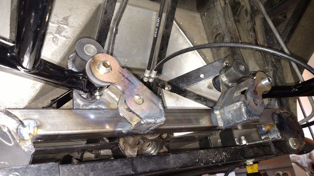

Got started on Monday. Pulled the 3 link pieces and then the axle itself
I also pulled the gas tank and fuel filter. I removed the hose that feeds the mechanical pump and blew air through so I would be sure there is no gas anywhere near where I will be doing a ton of welding.
Tacked the front diff/LCA mount in position.
and then needed to figure how to locate the rear mount. Decided to bolt up the LCAs and, since they are plastic bushings rather than rod ends, they really locate the rear mount quite well. It sags maybe a 1/4 inch so I just push upward a little until the LCA moves freely.
Today I need to get the car higher off the floor. Yesterday, tacking the rear mount in was tough. Laying on the floor I have my arms nearly fully extended to get the tig torch into position. So I am not very steady and can't see so well at that distance. I will try to get it so I can sit up under the car. The key to nice tig welds is having a very comfortable position and I usually have my face within about 8 inches of the weld.
All the 3 link stuff unbolts except the chassis mount for the 3rd link. Back in 2007 I had initially bolted it but later had welded some extra bracing in. So now it is kind of permanent. I hope I can leave it cause I would need to rent a torch to remove it.

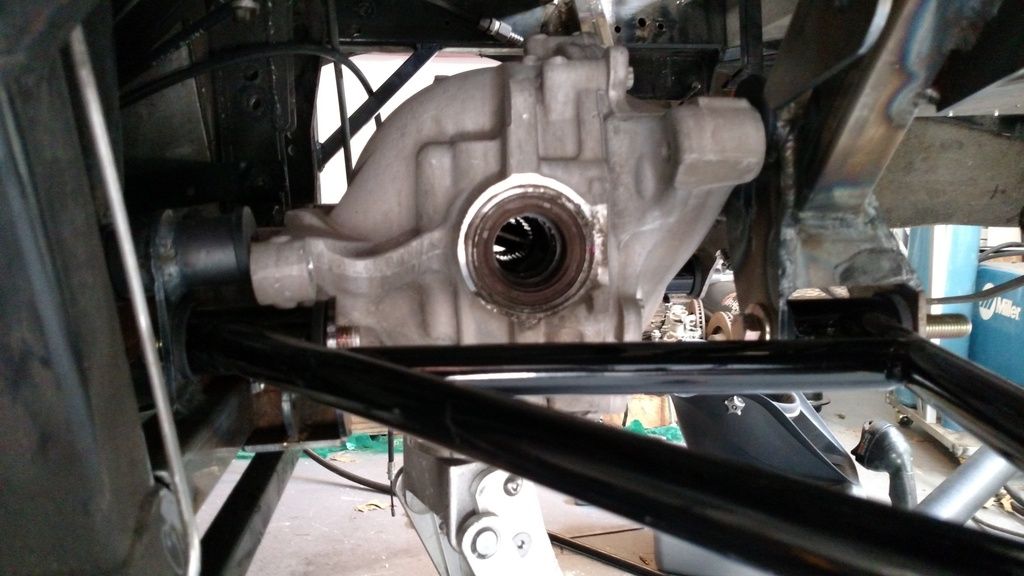

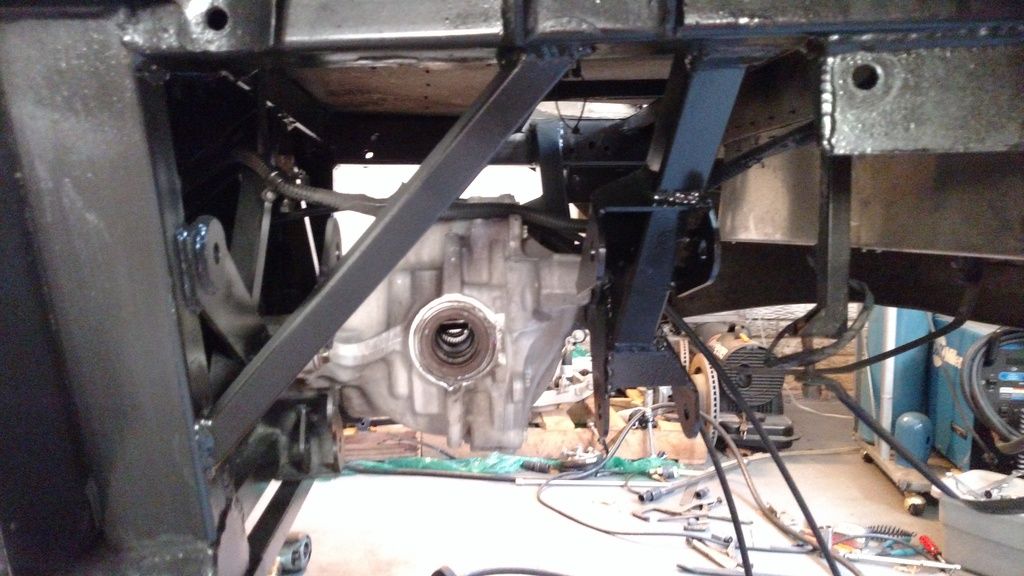

Today I finished welding the rear mount in and wanted to verify that the diff fits. That was fun by myself but doable. Got it into position to verify my spacing is correct and than took it back out.
Started looking at the UCA front mount and how that will work. Realized I will need to remove the OE 4 link mounts as well as the 3 link which I had welded in. Going to rent a torch tomorrow.

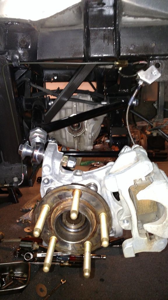

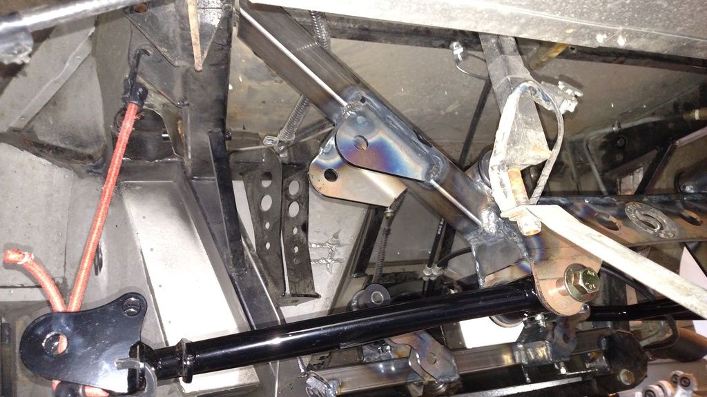

Rented a plasma cutter and got all the 4 link and 3 link stuff out of the way and then welded in all the brackets for the front UCA mounts. Quick install of all the control arms to make sure they fit and took a pic after the other side was back out for paint. ooops.
Rattle can Rustoleum etching primer and 'Hammered" black. And now the diff is in, hopefully permanently. Had to oval the hole in the front right ear of the diff. This is what I have been worrying about this whole time-that I could get all this welded into proper position w/o the jig FFR certainly uses. This small amount of ovaling says the diff is within 1/16 inch of where it should be.
Now I can measure to get the driveshaft shortened, run new brake lines and re-locate the fuel filter and hoses.

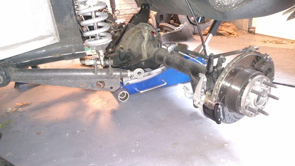

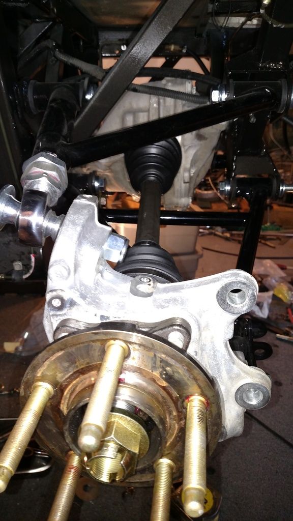

Diff is in, control arms in, axles in but I realized I have the wrong driveshaft adapter. That will teach me not to ask questions. When FFR asked if I was using a stick or auto, I said stick. Well apparently that is a reference to what car the diff came from rather than my trans choice. So my adapter is too large an OD. I know my salvage yard stuff came from a V8 because it has vented rotors but I didn't realize it was an auto trans source. FFR is sending me the other choice. They said just send back which ever one you don't use.
I also found out that I can't get the drive shaft into the trans because the pinion flange is too close to my welded in drive shaft hoop. So I will need to remove the front diff mount bolts, loosen the rear diff diff mounts, and hope I can push the pinion up maybe 1 1/2 inches. BTW, this is a funny looking driveshaft. Only about 2.5 inches of tube in the center.
FFR 5353K, 408W, TKO 500, 3-link w/3.31 and CF clutch pack limslip, Breeze QA1 DA coilovers front and rear, APE hardtop, Forte front and VPM rear swaybars
CraigS is online now
post #23 of 30 (permalink) Old 11-24-2016, 01:10 PM Thread Starter
Location: Manassas, Va
Posts: 17,080

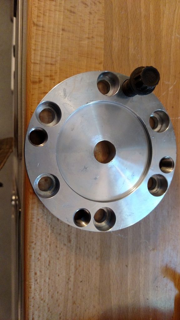

Got the driveshaft adapter piece and it fits on to the diff flange. Yeah.
But, it bolts to the diff w/ six 10MM bolts and there are 4 threaded holes for the driveshaft but they are also 10mm. The OE driveshaft bolts are 12MM and I was not happy about a downgrade. So I took the adapter to a machine shop and had it drilled and tapped for 12MM. Then my stupidity showed up. The bolt pattern on the adapter is maybe 1/4 inch larger than the driveshaft. Crap this will never end. So I emailed FFR at about 6PM and will go to the driveshaft shop Fri AM if they are open. I think the easiest thing is a different end for the shaft. I hope one exists.

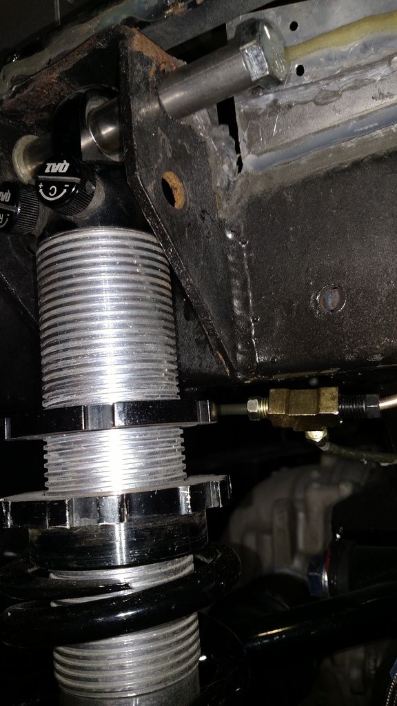

In the mean time I will get ride height and alignment done. I worked out that I can use my 3 link rear DA QA1s after I drilled a hole for the top mount that is higher to make up for the longer shocks.
I want to stay w/ these shocks for two reasons. 1- I love the quick adjustment, 2- The next shorter shock also gives up nearly an inch of available travel. I like extra travel available so I am not locked I into a narrow range of ride height.

While reading through FFRs parts offerings I found that the adapter requires a Spicer #2-2-489 flange. Ordered it Friday and hope to have it tomorrow Tuesday. Also ordered a u-joint since it's been maybe 30 yrs since I last replaced one. I am used to cutting the cross out w/ a torch which saves a lot of hammer work but I don't have a torch.
Dennys Driveshafts > DANA SPICER 2-2-489 Flange Yoke 1330 Series

Got the driveshaft straightened out late Thursday. I had had the FFR adapter drilled and tapped to use 12mm bolts for the drive shaft since that is what the solid axle has used. I just couldn't get myself to be happy to down grade to four 10mm bolts. That meant that I needed to drill out the new flange but that was easy to do. Got the car on the ground and did an alignment Friday but had other stuff to do so no drive that day. Had a few fuel system problems that took too long for my brain to figure out and finally got to drive the car today. I am quite pleased. Will keep trying different shock settings but so far, my initial guess is within a couple of clicks I think. The ride is better, but the best thing is that a bump in the middle of a turn doesn't upset the car nearly as much as it did w/ the 3 link. I did find that my 3 sets of 17 inch Bullitts are not all equal. Not sure why although they were bought at different times over a 10 year period. The newer sets clear the calipers fine w/ a 1/2 inch spacer. The older one won't clear the caliper even w/ a 35mm spacer. I will get tires swapped around Monday.

Originally Posted by flaircraft View Post
Either you got done a lot faster than you thought, or winter where you are is really short lol. What are you going to do for the rest of the winter?
Also it's great to see someone has done this swap successfully, it looks like it's fairly straightforward as long as you can take accurate measurements and weld the new components in accurately. All the other times I've seen someone ask about doing an IRS upgrade the answer has basically been "it's almost impossible, don't bother".
Yes, it is a lot of work but in reality it isn't that difficult. The most difficult for me is my 68 yr old non-athletic body doesn't really like laying on my back and contorting into all the positions I needed to get the welding done. Also there were times where I was sitting up w/ my head and shoulders in where the diff is, but my tallest jack stands had the car about 2 inches too low to be able to have my neck straight. So I would take breaks and either go in the house for a while or work on some other part of the job for a while. The rest of the winter may be used to upgrade the front suspension. I have a pair of the FFR spindles that I want to install but that also requires new hubs, rotors, calipers, and brake lines so may be put off for a while. My wife asks if I will ever be done working on the Cobra and my answer is, "I sure hope not."

I thought about 2by's or plywood but it made me too nervous. Also figured by the time I got the materials and made them, I would be done w/ that part of the welding. Of course that was a way off time estimate. If I ever need height again I will have to spend some time building some that I am comfortable with.
